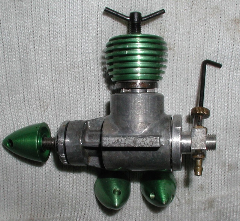

Went to the hardware store yesterday looking for a Taifun intake assembly nut and used one of those fancy displays with all the SA/Metric sized sample nuts. I tried using every conceivable SAE/Metric course/fine samples and nothing worked. Closest I could come was M8 which was too loose, M7 wouldn't even go. Nothing SAE either.
Can't be JIS or Whitworth, so something strange German or maybe specific to Taifun?
External size of the nut doesn't matter, I can always grind/file the face down.

I would guess that it is not a standard thread.
Have you measure the diameter and pitch?

Its probably British 1/2 thread pitch ? You may have to either have one made DYS or find a better upper on the Bay for less $E$ and use it for parts .. here is a chart that's a pain to use . https://mdmetric.com/tech/tict.htm

There are many non standard thread pitch listed out there. For example the TD .020 Venturi thread pitch is one that was used on Singer sewing machines.

How about BSC? BSC is a thread system used in bicycle industry. Also known as CEI standard.
Would 5/16" / 24tpi be close? That is 7.94mm in metric, so an M8 nut would not be very loose though. But anyway, if you have a bicycle shop nearby, maybe it would be worth a visit?

Try 7 mm fine thread.

Hi Bob, It is M7 fine indeed. That is M7 x 0,75. Below a page out of the French magazine MODEL AVIA of September-October 1968. It's part of a complete article on the Hurrikan. On top of the page, there's a table with the correct threads for each part:
It says after "écrou-filtre" 7mm diameter and 0,75 pitch. The HS standard means "high strength".

7mm fine? Wow I swear I tried it several times. Maybe my fumple fingers let me down..........again. I shall go back and try some more.
Thanks Lieven and all.
The worst part is, I know that nut is under some workbench somewhere just begging to be found.

But this is weird, crazy, and ridiculous. There appears to be no 7mm 1 or .75 pitch fine nut in the universe.
I went back to the local store and there is a 7mm course nut, but no fine. Came back home and got on to McMaster-Carr who has everything hardware and found their metric fine nuts go between 8mm and up and 6mm fine and down, but no 7mm. Thanks Taifun.
I got a couple of 7mm course nuts with the thought of retapping to 7mm fine, but I doubt I have a 7mm fine tap. A better idea would be to tap out a smaller nut though.
So, guess I will have to put this engine on the scrap heap of life.

Thanks Kris, but a benefactor might have solved my problem. This forum rocks.......

Hi folks, for what it's worth, 7mm threads are common on Vespa scooters and Ducati motorcycles, older ones anyway. Only in 1mm pitch on my Ducati though, don't know about Vespa.

Ah, the 7mm x.75 pitch nut looks like its used on potentiometers and toggle switches.

rsv1cox wrote:Well, Thanks to Lieven, one now resides on the back of my Taifun engine.
Bought a can of starting fluid and hope to mix up some diesel and run it this spring.
Looking forward to that Bob. The nut is indeed from a potentiometer, the smaller ones.
