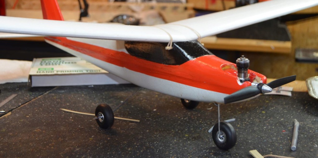

Reeling myself back in to do some more Fall S.M.A.L.L. prep:
Cleared away enough space to work (finally got the PT's cleaned and parked), and want to take the Ranger up to test-flight status.
Still got some to go, but this has been the somewhat tedious stuff that requires the right mood, and I'm there...at the moment....

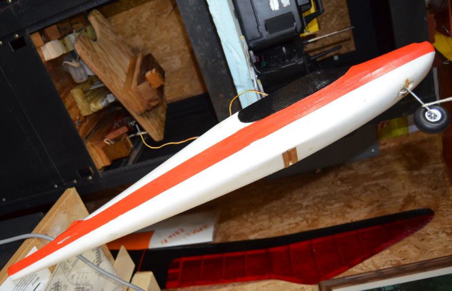

The aging tail-feathers of the Ranger had some strange "pockets" of missing foam where it looked like the material had just evaporated. The elevator was so bad that I replaced it with a balsa version, same with the rudder, but I wanted to use the stab, so I anchored in some balsa square stock, and 1/16th sheet, and am gonna stitch the hinges there. It's getting a coat of white Brodak along with the balsa elevator.
The Brodak-painted balsa rudder isn't gonna totally match the poly urethane top coat on it's fin, but we're in the "git'r done" phase, so it's gonna be referred to as "adding character" !! They're hinged and ready to glue to the fuse when the stab and elevator's paint dry.
Painted the Ranger's belly with clear coat to hopefully hold off the fuel soaking for a while.
In an brilliant moment of utter genius, I thought to clean the Ranger's foam wing a bit, and was shocked to find that the stains I'd thought to be permanent water marks wiped right off! So I got myself a pretty white wing, with almost none of the "lost foam" damage of the tail-feathers.
Also want to thank Ken for his recommendation of this paint:
https://www.systemthree.com/products/wr-lpu-polyurethane-topcoat
...which I think will become my main foam paint once I get my brain adapted to it's proper use !!!

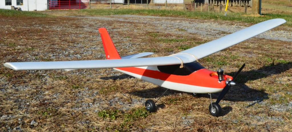

Managed to get in some more work on the Ranger, though it's hard to tell what was done. It had been stalled, waiting for me to get in the mood to hinge it's elevator...which happened today. This allowed the tail feathers to glued on, which was a big jump for me.
The radio guts and servo travel can be set up now, along with printing out some graphics to help with it's current Plain Jane appearance.
Can't wait for it to be out-run by Tony's C-182 at the next S.M.A.L.L. Fly-In !!!
