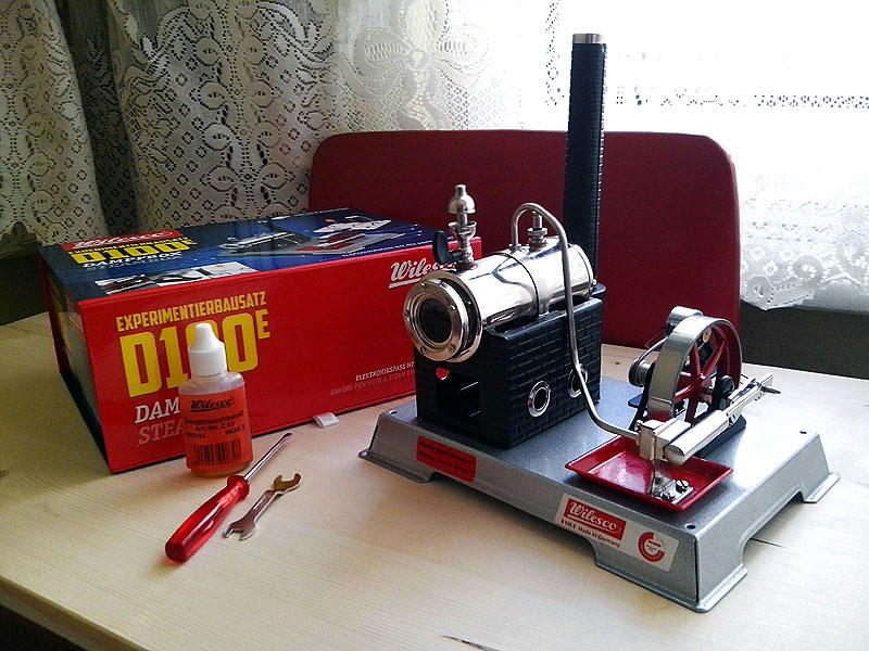

I built my first steam engine kit Wilesco D100 E. It is an happiness... tug tug tug... then whirling sound!
I recommend that, first fit the boiler house onto base, then burner slide while assembly. Because tabs of boiler house fit over burner slide tabs, so boiler house don't fit to base if you fit burner slide first. Steam pipe gaskets are smaller and thinner than other gaskets supplied with kit. Place one small gasket inside of threaded bush on boiler house, as like as one or two to the other end of steam pipe on baffle plate. Operating the steam whistle is somewhat difficult due to heat. Baffle plate and cylinder must be fit slightly tight, otherwise steam escapes from between the baffle plate and cylinder. Yet I want to use soldering iron elements to heat the boiler instead of using fuel, I tried new WiTabs high efficient tablet fuel supplied with the kit at first run. Two tablets supplied with kit, Wilesco steam oil, screwdriver and a wrench. I used one WiTabs tablet and it gave about 5 minutes run. A small breadboard - protoboard- for electronic experiments, a bag of electronic components, a dynamo with mounting supports and one spiral belt supplied with the kit. I placed a rubber mat under the base to prevent vibration. Wilesco D100 E kit is a very good value for beginners whom want to made his own steam engine without machining.

The fuel tablets were troublesome to obtain in the early sixties. My dad got me a can of Sterno cooking fuel, it is an alcohol gel, I believe. I would cut a small cube and it would run on that for a good, long time. I finally wore out the piston rod on mine.

I made an alcohol burner from aluminum foil sheet and lamp wick. Fuel tablets make soot under water tank. No soot builts up with an alcohol burner.
