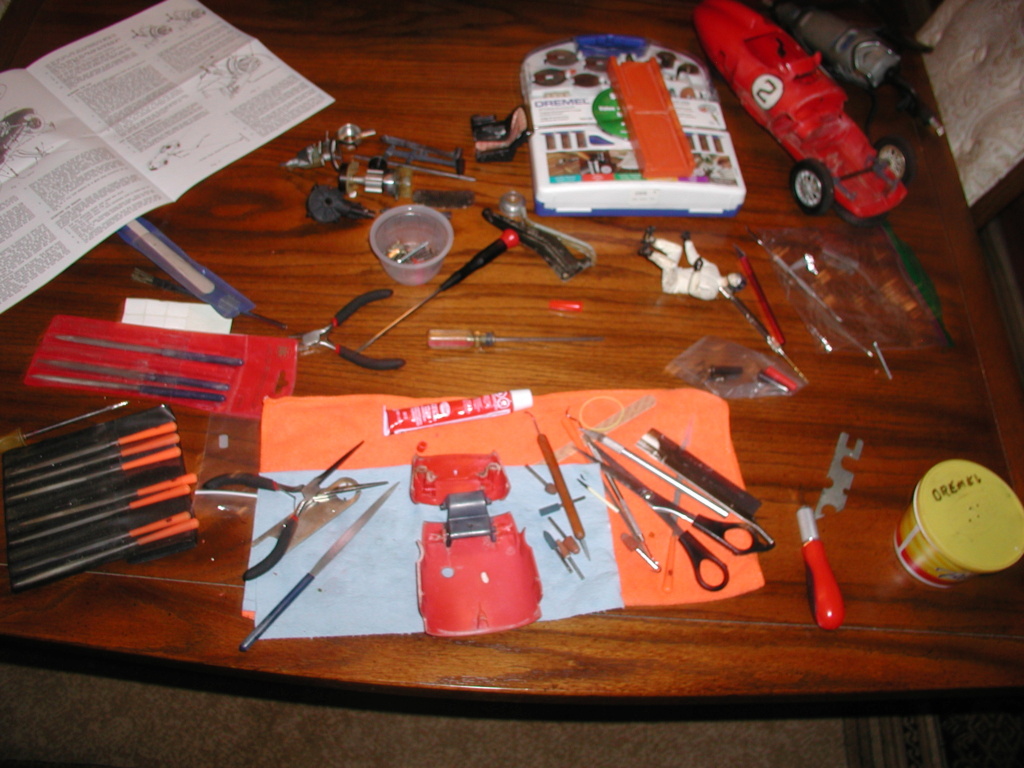

Post  rsv1cox Fri Nov 09, 2018 3:47 pm
Yeah, replacement engine for sure. No vent in the four CC tank, looks like a standard 350 otherwise. I cannot find another engine with a vented 4cc tank but I will substitute a better muffled engine for the one that came in it.
Disappointing little bugger, there isn't a part that hasn't suffered some sort of damage not really evident in the sellers ad. But, what I live for and it seals it's fate as a runner.
Fixing the hood pivot is my first priority. A head scratchier, I finally decided to use banana plug insulators. They are tapered and by cutting to length I found a perfect fit for the male pivot. Red tube cement works very well if left to cure.

Post  rsv1cox Sun Nov 11, 2018 8:58 am
Thanks,  The string turned out to be fine wire.
ebay Cox Mercedes, rough.....but check out that glow head. Cox_me35
One of the gearbox fingers is broken off.  Dandy!! Sad  The reason for the wire.  Whoever ran this model wasn't kind to it.  Virtually everything fixed or moveable is broken or damaged.  I have no idea how I'm going to add that missing finger.  I have a mixture of fine eyeglasses screws. Maybe I can drill a hole and screw it in.  I will figure something.
ebay Cox Mercedes, rough.....but check out that glow head. Cox_me37
ebay Cox Mercedes, rough.....but check out that glow head. Cox_me36
My hood fix works, only needs to pivot on the front clip.  The part that attaches to the hood will be permanently cemented.
ebay Cox Mercedes, rough.....but check out that glow head. Cox_me38
Looks nasty now, but by the time I finish messing around with it, it may look a lot worse.  Sad

Snowed in today so I worked on the Mercedes mess.  Attacked the missing "finger" on the differential (pictures above).  Limits travel and provides a little slop between the fingers and the suspension.
Limited in what I could do.  Gluing on a plastic piece would not stand the hammering of the suspension so I drilled a small hole in the thickest part and cut a brad to fit.  Near zero area to work with and the hole intruded into the boss for the drive shaft, not intended but it worked to my benefit.   Put a drop of CA on the pin and carefully with the Dremel and an ideally tapered stone ground the pin to the circumference of the hole which when assembled locked it securely in place.
So far the pin has held despite being knocked around during handling and assembly.  Before I put it all together I will probably add some heat shrink tubing to the pin.
ebay Cox Mercedes, rough.....but check out that glow head. Cox_me39
ebay Cox Mercedes, rough.....but check out that glow head. Cox_me40
ebay Cox Mercedes, rough.....but check out that glow head. Cox_me41
Not something that I wanted to do, but I had little choice the differential was useless as it was.
