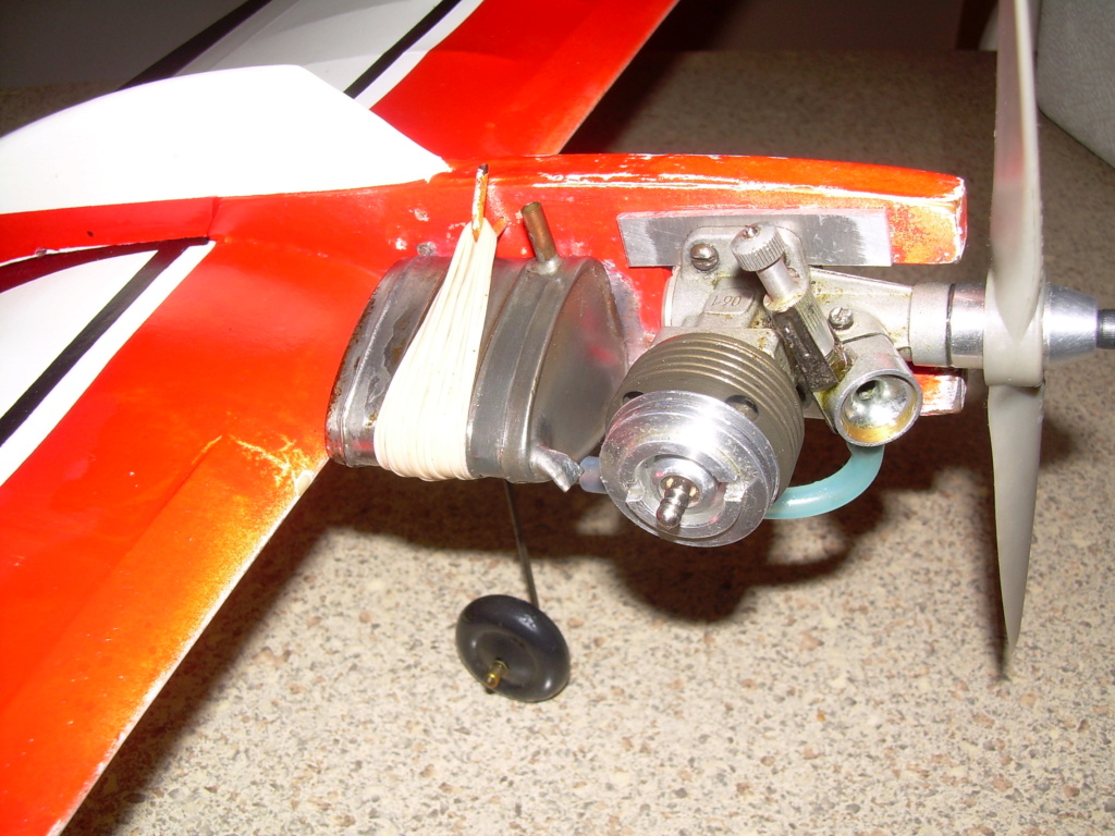

I did a check of some of the 1/2A's I could readily get to. I had to move them recently to service my heater. The Flite Streak appears to be the heaviest of all of them and I contribute that to the silkspan and dope finish. I don't recommend silkspan as it just rips too easy and always requires constant maintenance. I use Monokote of SLC covering from Phil Cartier which is clear. I have 3 coats of clear both sides of the wing prior to color and one additional clear coat over the entire model. I can easily see how this could've added some weight. The Perfect tank which is pictured has had it's feed pipe re routed and I didn't get a good pic of that but the stock feed came out on the far outboard corner which is directly behind the head. This is very poor as it will get damaged in a crash not to mention it makes the fuel line bend down and then back up to the spraybar. Anytime your fuel line does this, it will cause problematic runs when maneuvering. The fuel is going down and then back up. Even though the pipe is the same level, it does impact the engine run. I believe the fuel line flops offering slight pressure which richens the engine and then gives it a hiccup. I installed the line directly in the bottom of the tank which places it properly and also keeps the fuel line shorter. I left the stock pipe in the tank which I heated and pulled it forward cut it and crimped it over and soldered it blocking it off.
![Brodak 1/2A Flite Streak getting busy Dscn2831](https://i.servimg.com/u/f16/19/68/84/08/dscn2831.jpg)
If you ever receive a Norvel, the needle comes with a wire sticking out of the top with a L bend, Do yourself a favor and lose it immediately, this wire is very strong and in a inverted landing it can break the case as it doesn't bend easily placing a lot of stress on the case which is thin. You can see in the center of the knob where I cut it off
![Brodak 1/2A Flite Streak getting busy Dscn2832](https://i.servimg.com/u/f16/19/68/84/08/dscn2832.jpg)
