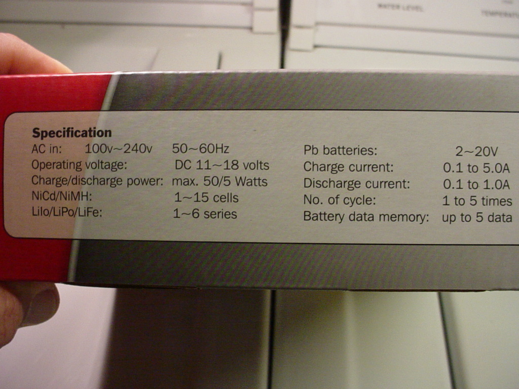

Do yourself a favor.. and look into sourcing a quality charger; one that will cover "ALL" of your hobby needs. I bought a "Thunder AC6" charger, which covers pretty-much everything.. and wasn't expensive. It had good reviews.. but I'm not sure if it is still in production.
