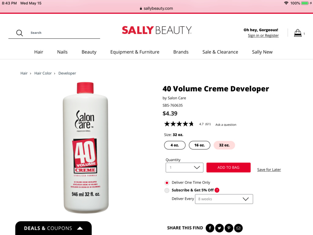

Post  Marleysky Wed May 15, 2019 7:57 pm
Watched a few of those You tube videos on  “RetroBright “ process for computer enclosures and keyboards. For larger items, like a cox Fuselage or wing, I’d guess I would use the Cream paste Peroxide, wrap with shrink wrap and set out in the sun.
Did a walk through our nearby Big Box shopping centers and could not find a single bottle of the stuff used in the video. Found some on amazon but was costly + shipping. One of the user reviews was negative about the size and price then mentioned to see if you have a Sally Beauty store near you. I do! Going there soon to buy some of this cheap!!
https://www.sallybeauty.com/hair/hair-color/developer/40-volume-pure-white-creme-developer/SBS-320828.html
Removing Fuel Stains From White Plastic Parts 05a95d10
Removing Fuel Stains From White Plastic Parts Empty Re: Removing Fuel Stains From White Plastic Parts
Post  DrCox Wed May 15, 2019 8:22 pm
Marleysky wrote: For larger items, like a cox Fuselage or wing, I’d guess I would use the Cream paste Peroxide, wrap with shrink wrap and set out in the sun.
See if you have a Sally Beauty store near you. I do! Going there soon to buy some of this cheap!!
That's what I used as per this thread:
https://www.coxengineforum.com/t12926-de-yellowing-plastic
Marleysky, do not shrink wrap the part in question and then place into the sun. You'll end up with streaking on the plastic from the different layers of plastic. I went to the big box store and purchased Glad large clear storage bags. They are big enough for sporting equipment etc. Easily the wing and fuselage will fit inside. The only purpose of the bag is to prevent drying out of the creme. This process worked well for me:
