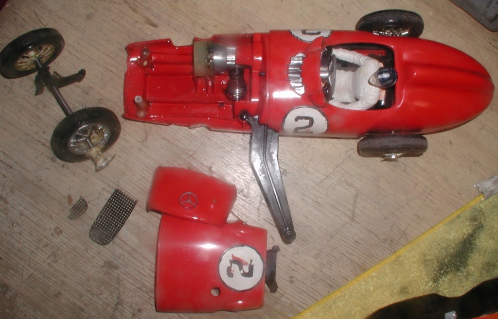

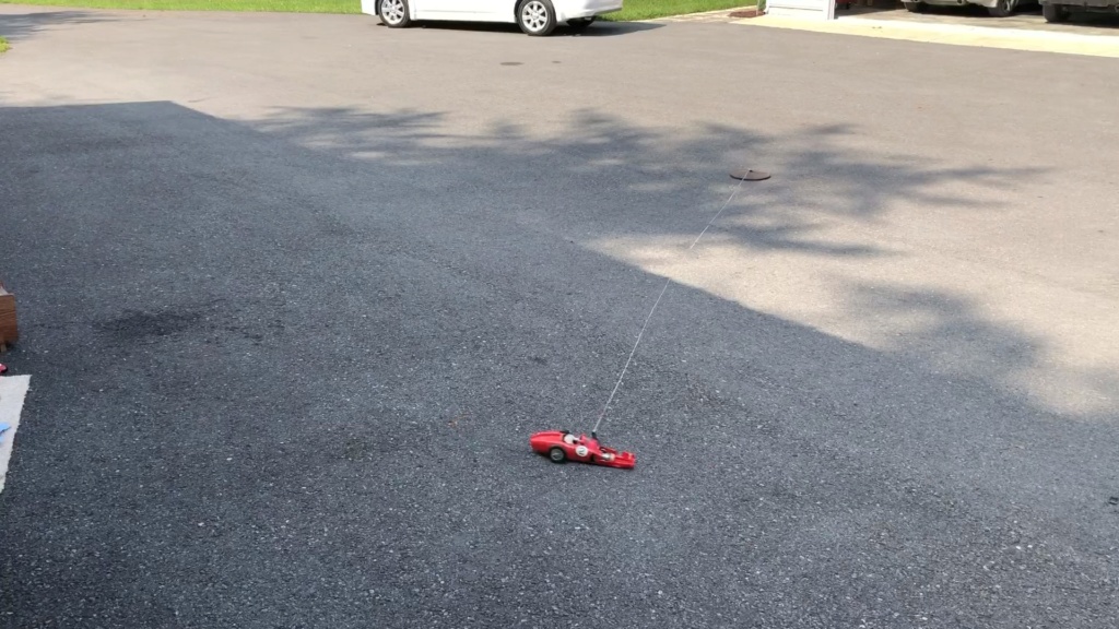

Mark over today so we ran the Cox Mercedes...….again. First time was when I ran it weeks ago, second stint was less successful.
Started out badly. Mark holding the front, me cranking the right rear wheel. Started, died. Fuel leaking from the tank, on me as I hate overtightening the machine screws and cratering the back plate. During the disassembly, (everything has to come apart to get to the engine) the repaired hood pivots broke and the hood came off. Kind of a big deal as the hood provides some structural stability to the front suspension when locked down.
No matter this thing is going to run. Tightened down the backplate screws and reassembled. Engine is a runner. A few flips of the rear wheel and she took off. Release angle is important on these, ask Roddie, and my release was not up to snuff. Wrapped itself around the tether line in the first quarter lap.
No matter, second release was perfect. Running well it made a couple of circles then it shed the whole front suspension along with the wheels. Barely slowed it down skidding around the circle on it's front end.
After a good two minutes it finally gave up and we picked up the pieces. Smashed hood, nose piece, wheel, and grill. The fun we had was worth it. Mark has video but no way to post it unless he goes to youtube.
Repairable but I'm retiring it with good feelings. As I mentioned before almost everything on this was broken when I got it. Repairs were make-shift at best. You just cannot repair plastic to original strength especially at stress points and these have many.
I have at least three more in runner condition that are in much better shape. Looking forward to doing those.

Not my best side. I'm just eager to put humpty dumpty back together again. Notice the hole in the nose piece (second picture) now filled with epoxy. It had a 1 1/2" machine screw through it all the way through the pan holding the whole front end together when I got it. Jason's custom mounts held for awhile but the rocking pins on the front swing arms eventually did them in.

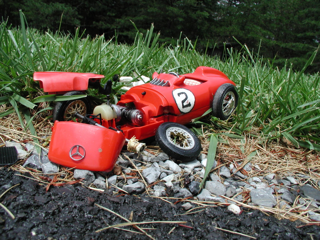

Mark videoed it with his tablet and sent me some of it. Takes to long to load the whole thing. I captured a picture from the video.
By this time it had lost it's front wheels and suspension.

Crash picture looks good Bob.
That'll keep the memory going of that fateful day in model Le Mons history

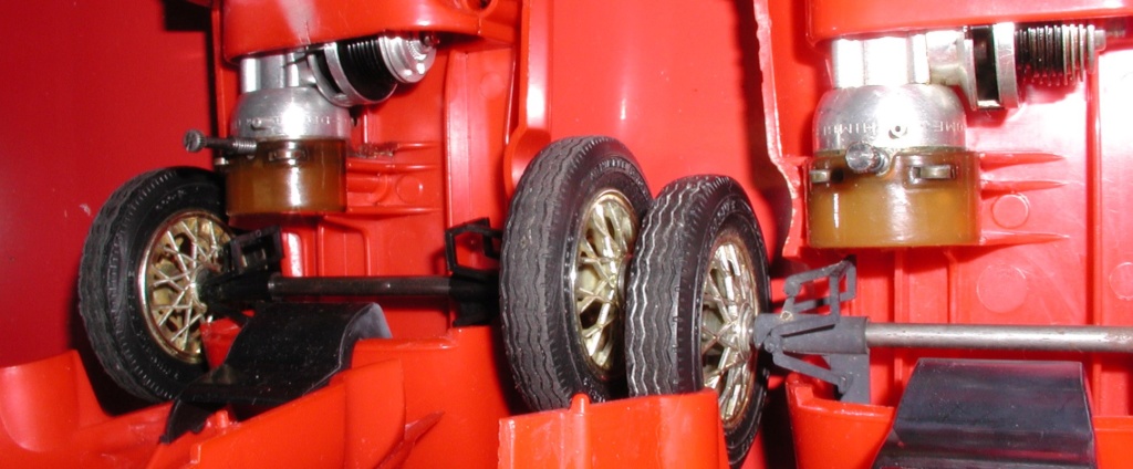

Yes, for all it's troubles (when got it, parts of it were wired together among other things) I have enjoyed this one more than any other.
Major problems still exist. The main ones being the reliefs for the front suspension pegs and the motor mounts. The nose piece reliefs are ok, but the pans are broken allowing excessive play in the swing arms. Also the upper and lower mounting posts that Jason supplied are (were) mostly gone.
The only cure is to permanently glue the lower pegs into the pans reliefs and establish a mechanical bond between the pan and the nose piece. Hence the 8/32's tapped into the nose pieces posts. The bitter ends will be cut off and filed down to the surface. Gluing, a combination of red tube Testors and epoxies just did not work.
The other major problem (there are multitudes of others) are the motor mounts. The lower cradle is comprised of three partitions. The front two support the upper cradle, the one toward the rear of the car provides frontal support for the engines mounting tabs. I have two of these where the outer part of the partition is broken off allowing excessive engine vibration.
In addition, the upper cradle has been modified as the PO dumped the original stunt engine for a vented backplate. The upper cradle snaps over the engines top mounting lugs and is held by two self tappers coming up from underneath. To fit over the vents this cradle has part of it cut away forfeiting some structural rigidity.
Picture heavy comparison with an unbroken example. The grill is a test loaner from #3 while the original recuperates.
