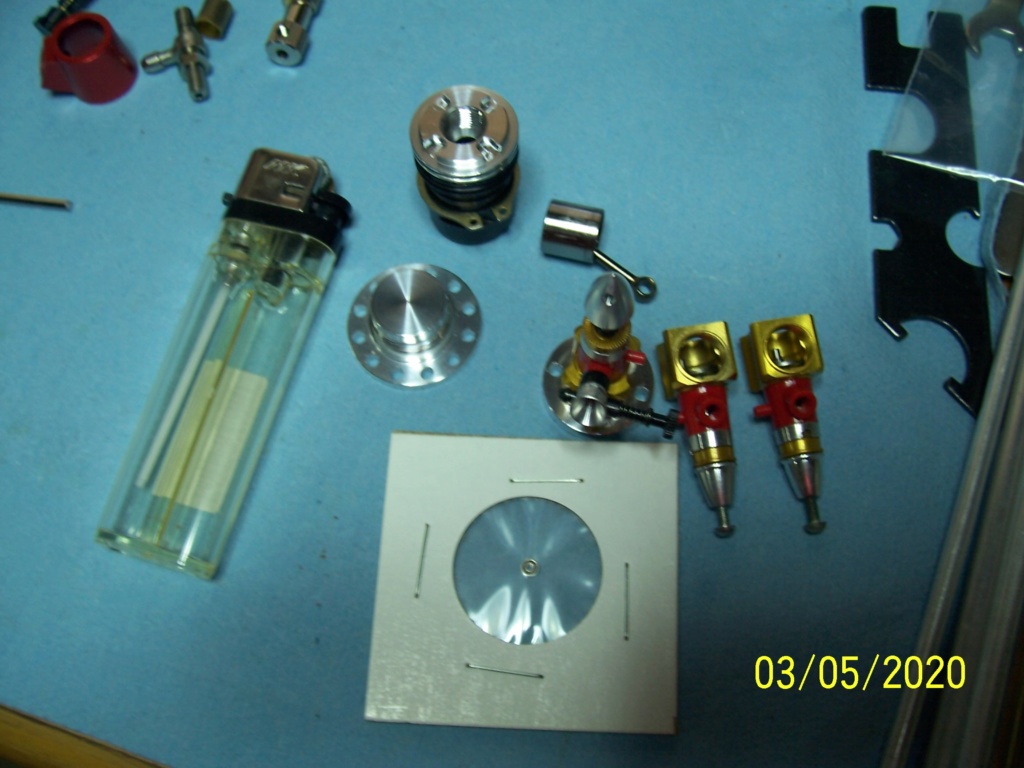

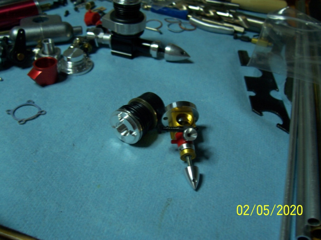

I just got a turbo head for my .051 cox engine project and a .010 rear mounting plate for one of my .010's I'm working on from Greg.
My only question is, when is he going to start making heads for .010's? or is it over-kill?
He does some of the best machining I've ever seen. very nice.

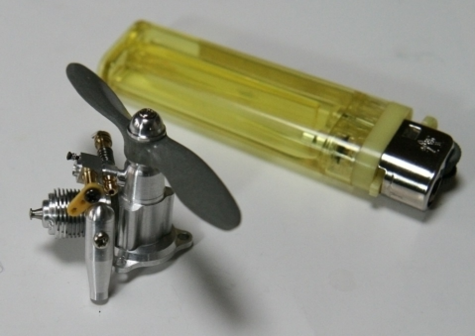

What one can hope for with the TD .010 is a micro muffler with pressure tap and RC carb.
A aluminum crankcase with bearings would be the icing on the cake with a full wave tuned pipe.
Like this simply use the existing NV and body swap out the venturi for a throttle barrel aka air choke.
Components this small don't cost much in aluminum but will take some effort for good fit and finish dialing in
program for the CNC machine will take a bit of time but worth it around $50 bucks for the set to enjoy good oil
spray control and RC throttle. I have 11 TD .010's all have the upgraded radial mounts and aluminum carb bodies.

Oh ceramic bearings would be best I have spun up to 42,000 rpm with the TD .010 it gets
plenty of cool air but still hot! See pic like this full boat the whole enchilada!
Stats / best pass clip:
Prop 2.56 x 4N / 30% Nitro
Static 28,858 rpm / 109.3 mph / .028hp / 21w / 1.5oz thrust
Unloaded best pass per prop calc 133 mph audio tach / 130.4 mph per Doppler
and best pass on this vid 35,184 rpm / 2.8oz RTF / 2ch RC micro race plane.
