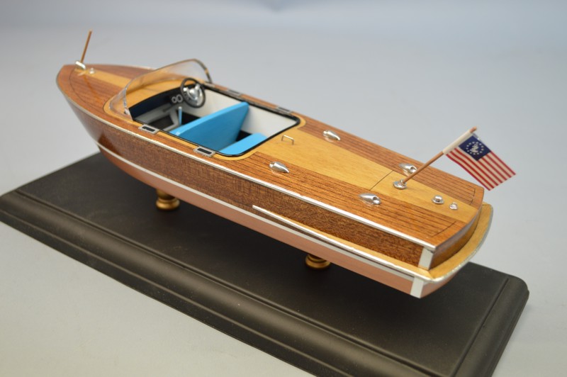

Just be aware , to restore the boat to it’s original condition, like Rod indicated, it will run full speed, like the one in the video. But if done with TLC and patience it could look like this:

From the limited images supplied, it has a "hint" of the Chris Craft Special, even though it is not.

Nice find! If the hull is solid, a good clean-up, possibly followed by some light sanding and fresh paint should make it look good. Maybe some balsa and thin plywood to build it to look a bit like the Chris Craft in Doc’s picture.
