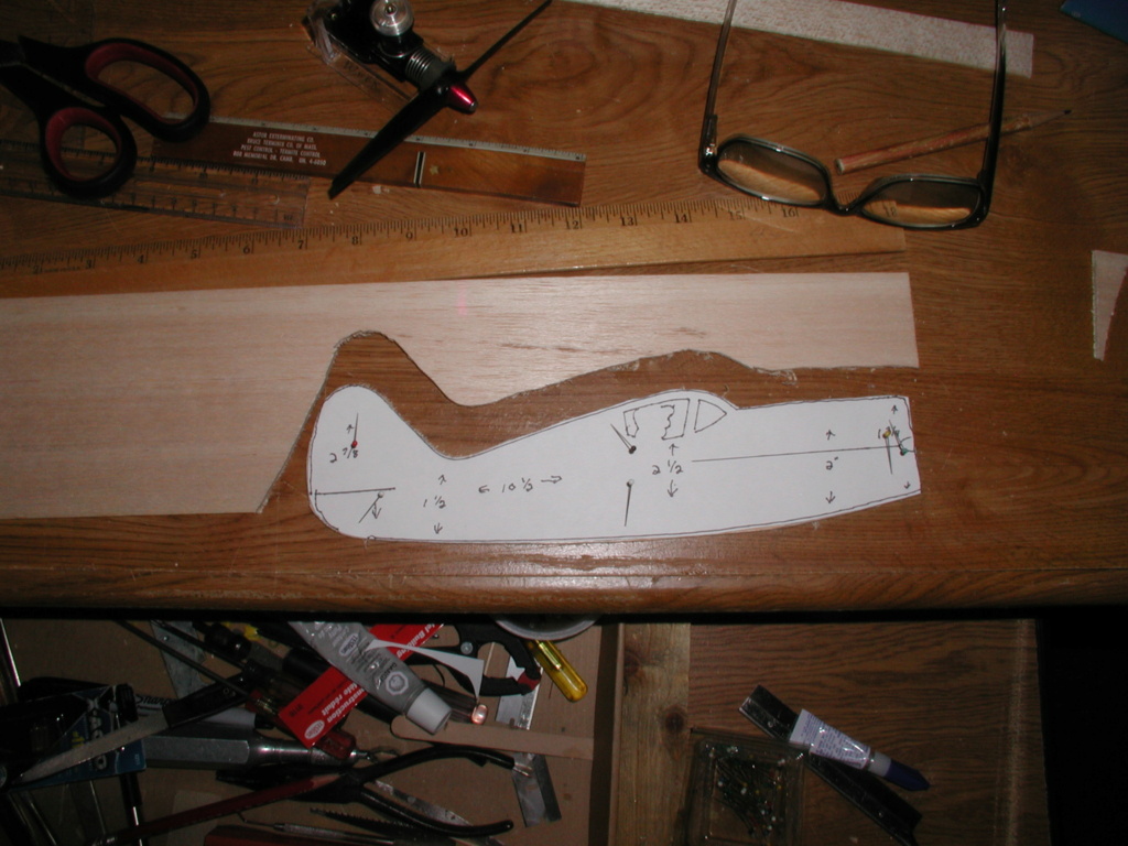

I started cutting out balsa for my Cox Black Widow model reproduction with thanks to wingingit and ab.
I decided against using my NIB black plastic Jim Walker fuselage opting for SIG 1/8" balsa instead.  For the wing I substituted SIG airfoil with an added 1/2" trailing strip to make up the originals 3 1/4" chord.  I still have to cut the scallops which will be a challenge as they are in descending shapes beginning from the wing tips. I don't have enough coffee cans of various sizes to do the job.  Might try to blow-up ab's wing picture to get the shapes, but my printers software is not that friendly.
 Cox Black Widow airplane and Dolly Parton P1010394
 Cox Black Widow airplane and Dolly Parton P1010396
 Cox Black Widow airplane and Dolly Parton P1010395
It's a start.

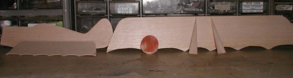

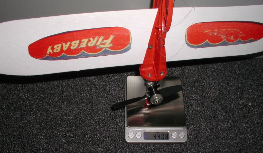

Just for fun I weighed the plastic bodied Jim Walker against this balsa repro.  4.40 vs. 3.87
 Cox Black Widow airplane and Dolly Parton P1010398
 Cox Black Widow airplane and Dolly Parton P1010397
 Cox Black Widow airplane and Dolly Parton P1010399
Weighs less even with the Black Widow rather than the Babe Bee.  Even less after I remove all that junk on the front of the BW.
Still, final sanding, sanding sealer and paint to go.

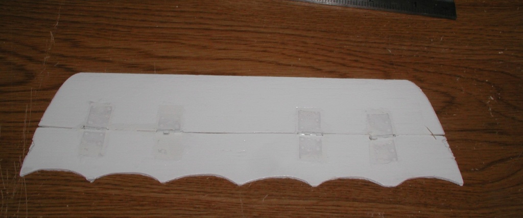

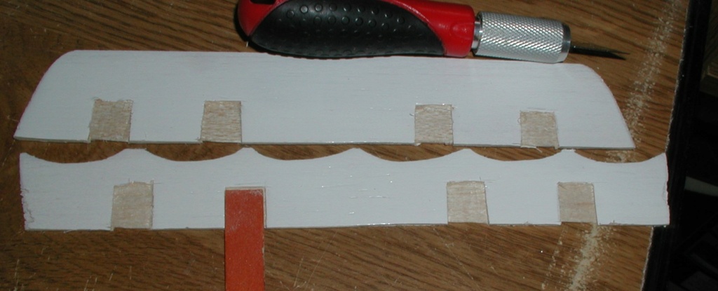

Many would not approve....but
the only thing I don't like worse than stitched hinges (can't do them) is cloth hinges.
Necessary on 1/16" balsa.
 Cox Black Widow airplane and Dolly Parton P1010408
 Cox Black Widow airplane and Dolly Parton P1010407
 Cox Black Widow airplane and Dolly Parton P1010409
 Cox Black Widow airplane and Dolly Parton P1010410
Notice how the horizontal stab digs in the leading edge when compared to the plain of the wing.  Not normal but it's how the original Jim Walker Firebaby is designed so I built it in.  About a negative 5 degrees.

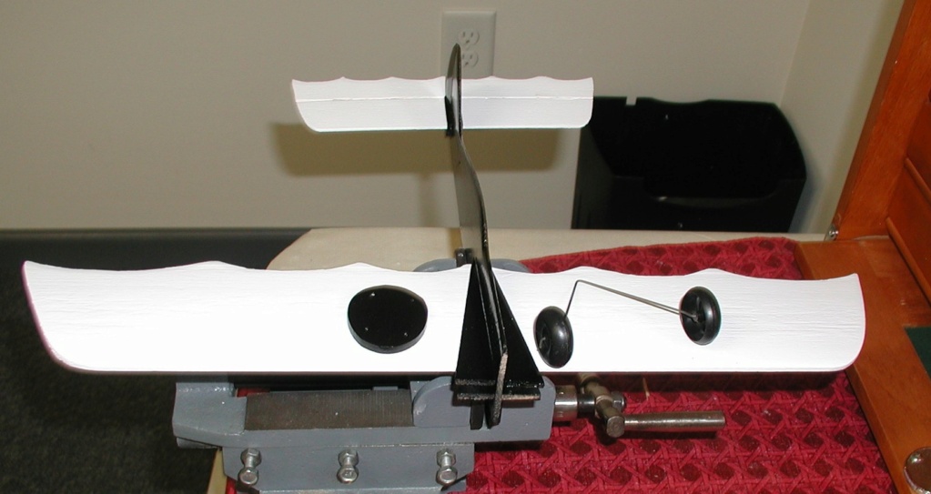

Painted today.  Top Flight Lustrekote both black and white.  Nothing glued yet.
 Cox Black Widow airplane and Dolly Parton P1010414
 Cox Black Widow airplane and Dolly Parton P1010413
I managed to find an original set of JW wheels on ebay so I won't have to fabricate my own.  Epoxy on the firewall and two top wing keepers, attach wheels and Black Widow engine, install controls, wait for Levent's decals and clear coat and we are ready to go.
Didn't turn out wonderful, old age (let you know when I get there) may suggest wisdom but there is no substitute for young steady hands and keen eyesight.  Mistakes I wouldn't tolerate years ago, I accept now.
PS: I didn't scallop the leading edge of the horizontal stab. as on the original Cox BW. Didn't like it.
