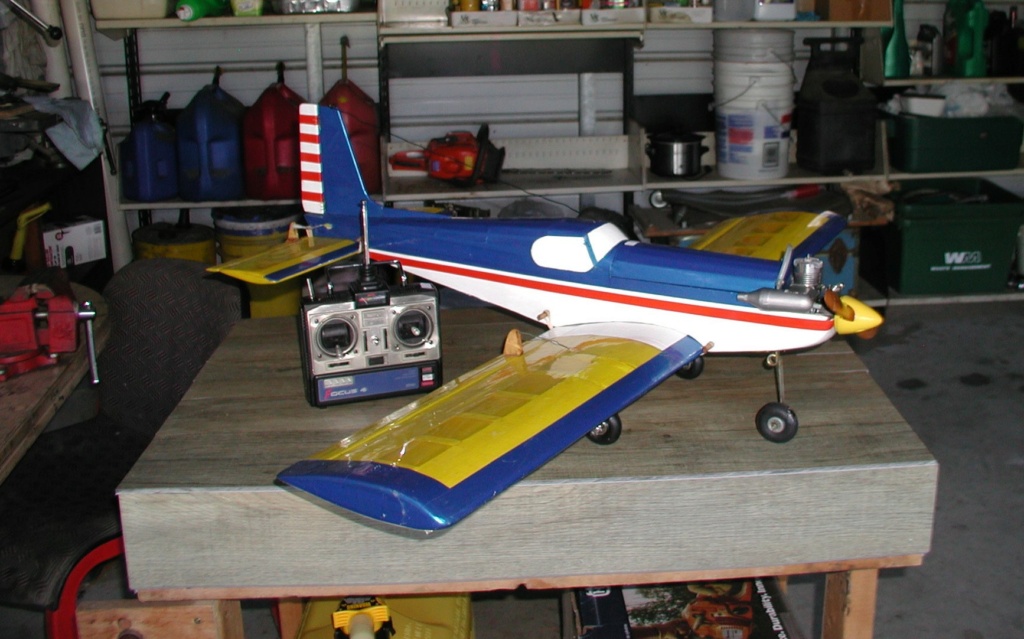

Getting my Tower Hobbys 40 plane back got me thinking R/C again.

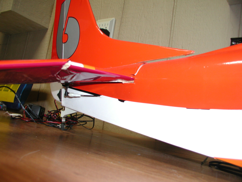

So, with Dolly singing tunes on the boom box I got out a plane that Kim sent me a long time ago and got the batteries charging along with my son's model p-51 that he flew while in Colorado. It's the same plane that got crumpled (note the horizontal stab) while being transported from Colorado to here while in a pair of classic Mustangs by the 18 wheeler that rear-ended the carrier.
I plan on fixing the horizontal stab and at least running them up and down the driveway a couple of times.
And, SIG just sent me an email with a tracking # for the balsa airfoils I ordered a couple of months ago. Now I can get started on a simplified version of my P-38.

AWRIGHT!!!! I've often wondered about the old "Cherokee-ish Sport Plane"!!!!

Yeah, arrived safely in a huge box packed to survive a bomb blast.

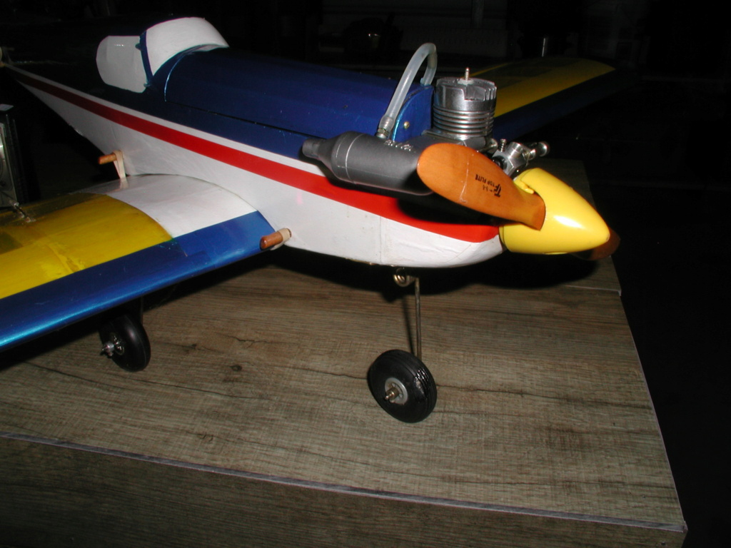

I slapped in an Enya .19 and a Hitec Focus 4 radio. Both fit it well. You can't kill those Hitec radios. I have four of a certain vintage and they all keep humming along even after a period of no use. I charged it for about 16 hours and it works fine powering all four servos like it was just used yesterday. I'm attracted to the design of that model. Looks like an airplane.
Mark's Airtronics/Sanwa no so. Dead as any. It would need new batteries to work. No need, I have better radios to put in it. The P-51 pretty sorry too. Damage to the tail section is much worse than I first thought. Probably going to pull the whole assembly to make it right.

I really like the Dago Red. I got to see the full size one race one time. In the picture of it upside down and charging I think I see a 4 stroke muffler sticking out. What engine has it got? I had a Saito .56 on an Extra 300s that was a blast. Never had a lick of trouble with that engine.
Watch those batteries closely though, even on the Focus that charged OK. It might be a good idea to pull the antenna up and just turn the transmitter on and see how long it goes before loosing it. Nickle Metal Hydrides will loose a surface charge quickly then should stay at a good working voltage for a good while before dropping off. Just a suggestion.

It's an OS FS-70S. Found the box for it, easier than going up to the loft to check.

I went out this morning with the best intentions to crank up the Enya .19 and taxi it around a bit. Maybe even in a straight line raise it up a couple of feet before chopping the throttle and letting it settle back down. I'm pretty good here east/west for distance but n/s is all confining trees and ridges.
Went to turn the prop and it wasn't having any of it. Locked up tight. Not just finger tight that a dab of Remoil would loosen up but Tight! Even two of the three wheels are castor locked. I darned sure didn't clean it or the engine up last time I used it. Going to take removal and heat to loosen it up.
Good looking plane. All hinges are stitched (I'm not a fan) but they work perfectly. Gave the radio a range check with both antennas retractred and the control services were waving at me from 50 yards away. Thinking the batteries are ok.

Im sure this is well known and I think its what you are getting at about the locked up motor and not having cleaned it. Since I have started making my own fuel with Straight Castor and no synth or detergents at all, I have started having to clean/flush my tanks and engine after use. They havent locked up on me as they havent been left long, but bits of Castor in NV, fuel tank tubes a bit blocked,...... Still not hard to do the simple maint.
