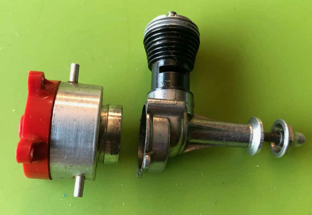

Hi all, I'm in the process of disassembling a Strato Bug (I think that is what it is!) and I am having trouble separating the tank from the plastic backplate. Should they just pull apart, or is there something holding them together? I've tried pulling but they won't separate although the tank spins easily around the backplate. I don't want to force it so am looking for advice.
I have a bunch of Babe Bee's and Golden Bee's from my childhood that I'm cleaning up and hope to start soon. This engine was given to me, used, by an uncle and I have never started it. It is possible it has never been disassembled.
Thanks for any advice!
Stan

Yeah, what Doug said. Possibly castor stuck. Although you can spin it so it might just be a tight fit as mentioned already. You could plop it in some hot water (sub-boiling) and let it sit for a few mins.

Welcome to the forum, Stan. A little heat will do it. If you were
dealing with a metal backplate, I'd say, throw it in a toaster
oven and be done. With an uber-precious backplate like that, a little
gentle heat with a hair dryer should do the do.(see what i did there?)
Keep the heat away from the plastic if you can.
Careful, you're handling a gem.

Could be stuck on an O ring see the o ring grove on the end of venturi? It worth at least 400 on eBay

Looks to be the real deal.
So using it is up to you. If you do use it fly over soft grass/ground. Personally I would probably shelve it.... maybe.
