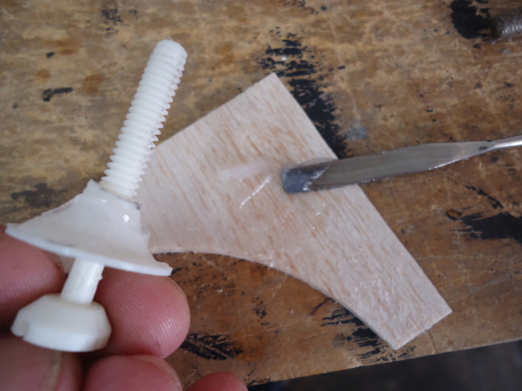

and we continue with the tail group ...
here I also want to replace the rear axle wheel ... I like the aluminum rim so let's get to work ... the replacement of the original is a fact!
When placing the tail skate, you must be very careful, because it is necessary that the epoxy and the necessary lubrication grease play with each other, because there is the secret of a good operation, the manual does not indicate doing this operation .
If you want a free running train, you must grease the necessary parts and you will find good results there!

and here we go with the fuel loading socket ...
![F1-Rocket EVO by Great Planes. - Page 2 Dsc04833](https://i.servimg.com/u/f86/19/94/18/61/dsc04833.jpg)
![F1-Rocket EVO by Great Planes. - Page 2 Dsc04834](https://i.servimg.com/u/f86/19/94/18/61/dsc04834.jpg)
![F1-Rocket EVO by Great Planes. - Page 2 Dsc04835](https://i.servimg.com/u/f86/19/94/18/61/dsc04835.jpg)
![F1-Rocket EVO by Great Planes. - Page 2 Dsc04836](https://i.servimg.com/u/f86/19/94/18/61/dsc04836.jpg)
![F1-Rocket EVO by Great Planes. - Page 2 Dsc04837](https://i.servimg.com/u/f86/19/94/18/61/dsc04837.jpg)
