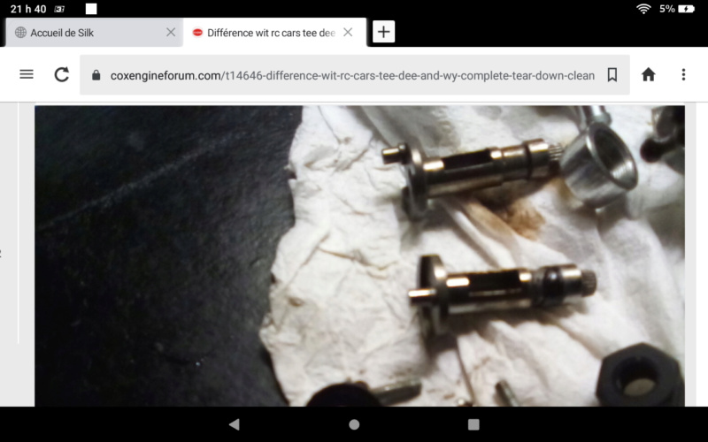

À very long storage without Remove old oil wil try turn oil To hard residue like plastiques Or almost here is an example of tee dee i have found in Reed valve engines To its Not that hard and save trouble engines life To The oil must imperatively reach the end part of the crankchaft
That black stuff on crank shaft wil destroy its crankcase compression wil Not seal correct leak fuel from prop drive if run wit that stuf inside crankchaft lube Line in Reed valve wil also get filed wit that old residue and damage crankcase and crankchaft
Keap the bearing surface from rust spot somtime just litle Polishing wil help To just place in dril y use cars Polishing stuf work

Merci David, I can see the lube groove in your centre picture....merci, thanks, and in Welsh. Diolch
