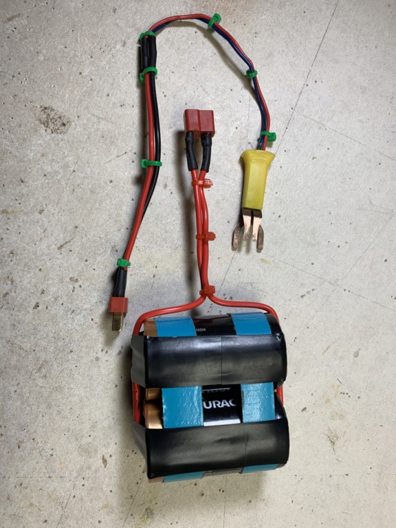

Hi Martin and welcome
Here’s a photo of the Cox style clip that was mentioned...I added a connector to keep the bare ends of the clip from shorting in the field kit... I’m sure these clips could be picked up for cheap on the bay or elsewhere online....
I used two D cells in parallel (1.5 volts)..... Soldered to the posts but could be tapped tightly in a pinch..... I believe this is the safest way to light the cox heads....
