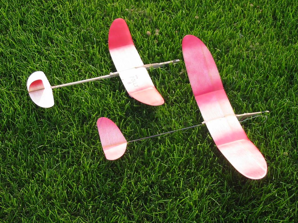

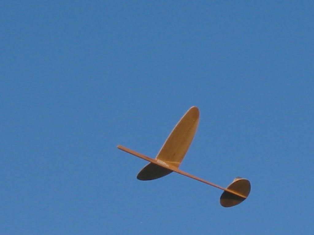

Couple of weeks ago I went out flying early in the morning (July 11,2021)
I was test flying my catapult launch gliders.
I got one of them to glide rather well to where it was circling downwind to the trees at the north west of the flying field.

Yes, I found my catapult glider with no problem.
Had a good line on it and was only off by 20 feet or so.
Both have Dethermalzers (D.T.) to bring them down.
The wing pops up at about 45° angle and that makes them easier to see on the ground.

No,
The Hand launch gliders are not SIG kits.
I built them from plans and kits from Retro RC LLC.
http://retrorc.us.com/hlgandclgplans.aspx
Here is more of my "group" of hand launch and catapult gliders.
Obarski Hand launch glider for a 69 second flight ( wing span 20 inches and weight is 29.3 grams -- over 1oz.)
Those Sig kits are good for starting off for hand launch gliders.
With a better wood selection (lighter wood for the wing and tail and a harder wood for the fuse).
They do well in contests, for I have see those designs flying.
As for the standard kit that you have it will work out well.
Follow the instructions, round off the fuse a bit and give the wood only one coat of Heisman Minwax polyurathane (to seal the wood from moisture.
Good (contest) hand launch and catapult gliders (around 16 to 18 inches) are around 1oz.(28.4 grams)
The bottom hand launch glider is of my own design (with carbon fiber boom).
