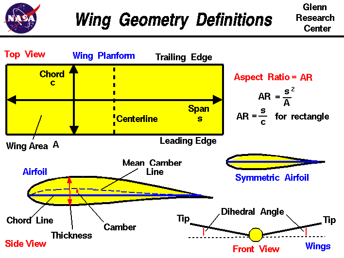

Yes, my cutting board. I just wanted to get a look at the sweep-back of the wing.
I'm stilll a big fan of SIG, I think I might have just got some poor balsa and a bad rendering of the airfoil. The P-38 used a semi-symmetrical wing, so I'm going to join the 4" and 3" together like this.
![SIG's airfoils P1011557](https://i.servimg.com/u/f43/19/15/28/33/p1011557.jpg)
![SIG's airfoils P1011558](https://i.servimg.com/u/f43/19/15/28/33/p1011558.jpg)
![SIG's airfoils Airfoi10](https://i.servimg.com/u/f43/19/15/28/33/airfoi10.gif)
I will still have to add an inch and one-half section to the wings trailing edge to get the width I need and sand to scale. It probably will wind up lighter than the built up wing I used on the original. Thinking about profile for the pilots pod and twin booms. I have the perfect pair of Cox horseshoes for engines, but will probably resort to Black Widows to avoid the tank issues.

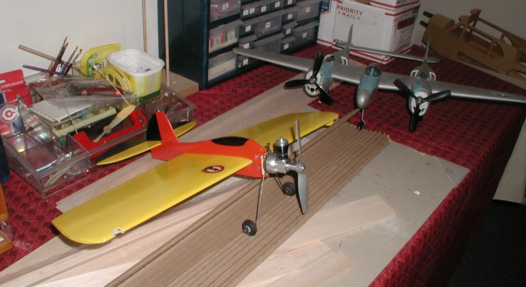

I have 5 of the 4" wide in the mail will report my findings.
Have made quite a few projects with the airfoiled balsa.
It's raw shape is enough to help speed up sculpting the rest of the wing.
I use semi to fully symmetrical airfoils for RC flying. My examples below.
The last two at the bottom are double planks fully symmetrical by nature.
Even the vertical stab on the checkered wing plane is doubled up.
All hale the simple balsa plank racers.
![SIG's airfoils _010_011](https://i.servimg.com/u/f39/18/57/77/11/_010_011.jpg)
