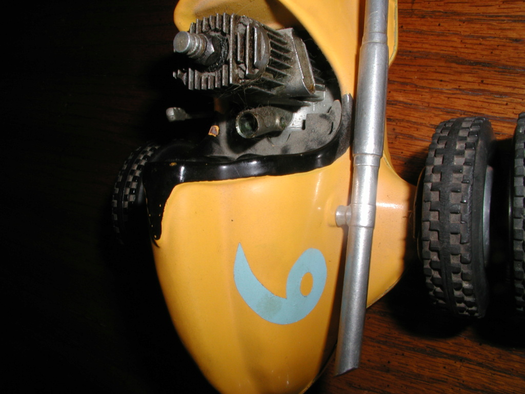

Looks like the Cameron is missing the whole needle valve assembly including the spray bar, also the intakes trumpet.  Dig into it tomorrow.
It appears the engineless car was whipped a bit and toppled over.  Scarring on top and bottom.  Glad that some kid had fun with it.

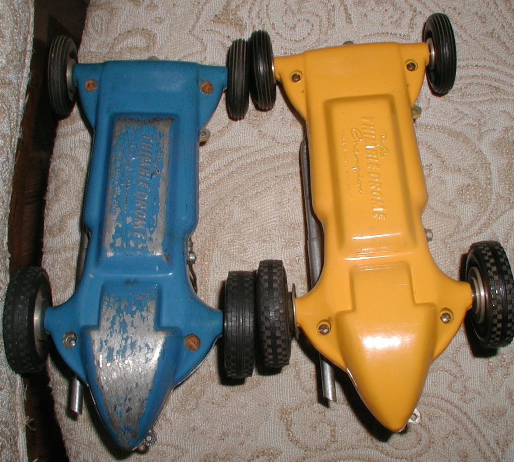

Sellers description:
“I have TWO ROY COX THIMBLE DROME CHAMPIONS SELLING AS A PAIR. One with .19 motor and the other without. Rare yellow. # 63 (no motor) looks all original and in good shape except for paint as of age and usage at one time. Good rubber and wheels move easily. The #6 Yellow car with motor I believe has been reconditioned (who knows how long ago) but looks GREAT!!! Motor not tested ( do not know if it will run) but motor is there and rest looks all original. Rubber is good and tires turn as they should. Here is a chance to own BOTH cars one with motor and one without. Of course these cars are Champions..Made in Santa Ana Calif. I am not a expert or business so I took as many pics I am allowed and will be happy to answer any questions I can. Thanks Bob”

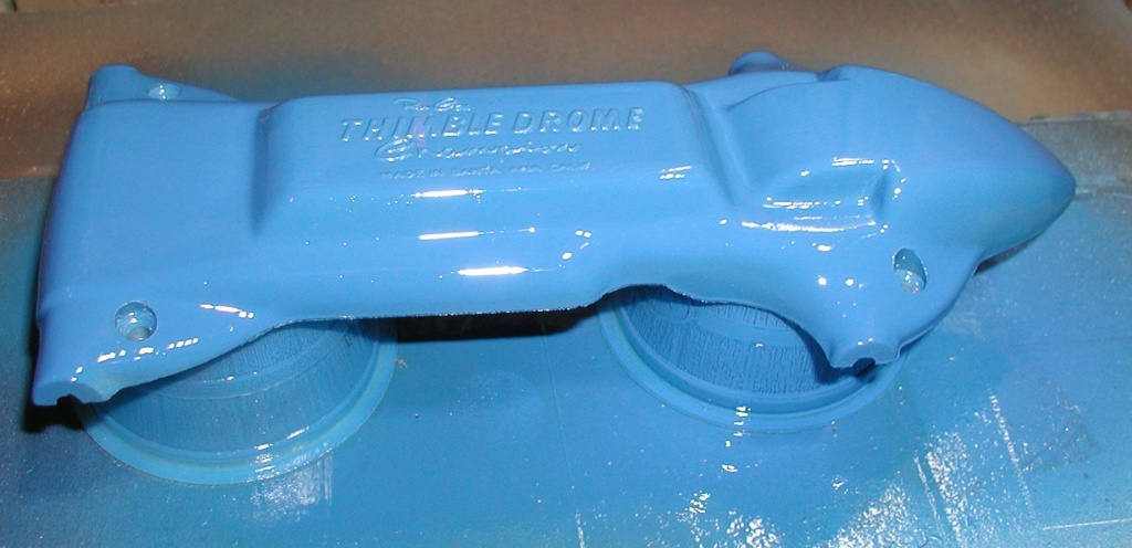

Post  rsv1cox Tue Nov 16, 2021 2:05 pm
Debated awhile before deciding to paint the bottom of the engineless Roy Cox.  Didn't really want to, thought about leaving it as the kid finished playing with it.  But..........I visited the well-diminished paint department at Walmart this morning and found this "Patriotic Blue" which matches the original quite well.
Took a lot of fine file work, 220/400 grit wet or dry to eliminate most of the scars.  Brass axles and end caps, and real hardware inside.  Yup, Armor-all on the tires and Pledge on the body.  Had to replace one round-head case screw.

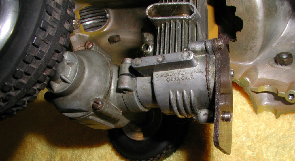

I took it apart yesterday, First oh, oh - the rear wheels just spun, no compression no nothing, second oh, oh - something is missing.
Two Roy Cox Champions - a day early P1012126
Two Roy Cox Champions - a day early P1012127

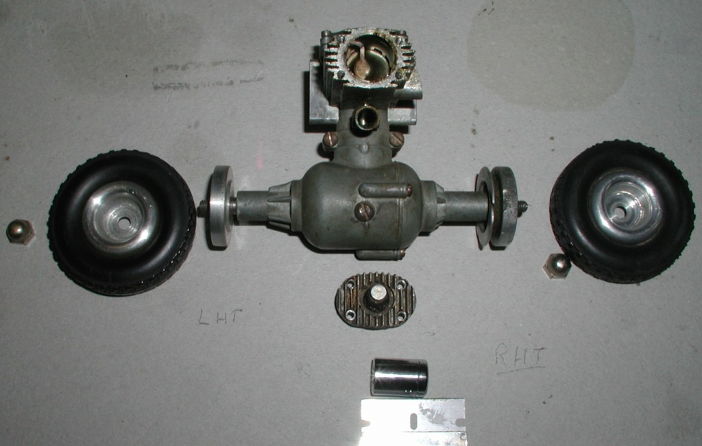

Solved the no compression problem.  Acorn nuts were on finger tight.  No cogs on the axle or wheels, just a tapered axle with a friction fit.  Right hand threads on the right axle.
Two Roy Cox Champions - a day early P1012129
Two Roy Cox Champions - a day early P1012130
Heat gun and a razor blade saved all the gaskets.  Interesting domed piston and intakes.
