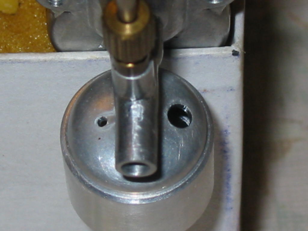

Hi Guys,
Another one I've found : a limited edition of the tiny MP Jet letmo 0.6. This one is the #211 (out of 500 ?)
Unfortunately, the last owner tryed to remove the tank, and unfortunately (bis), the mounting is silly : tank seems to be screwed from the inside on the carburettor and then the bottom of the tank is pressed in place. So, I don't know how I can fix that without sacrifying the tank... Any ideas ?
Vincent
Vincent

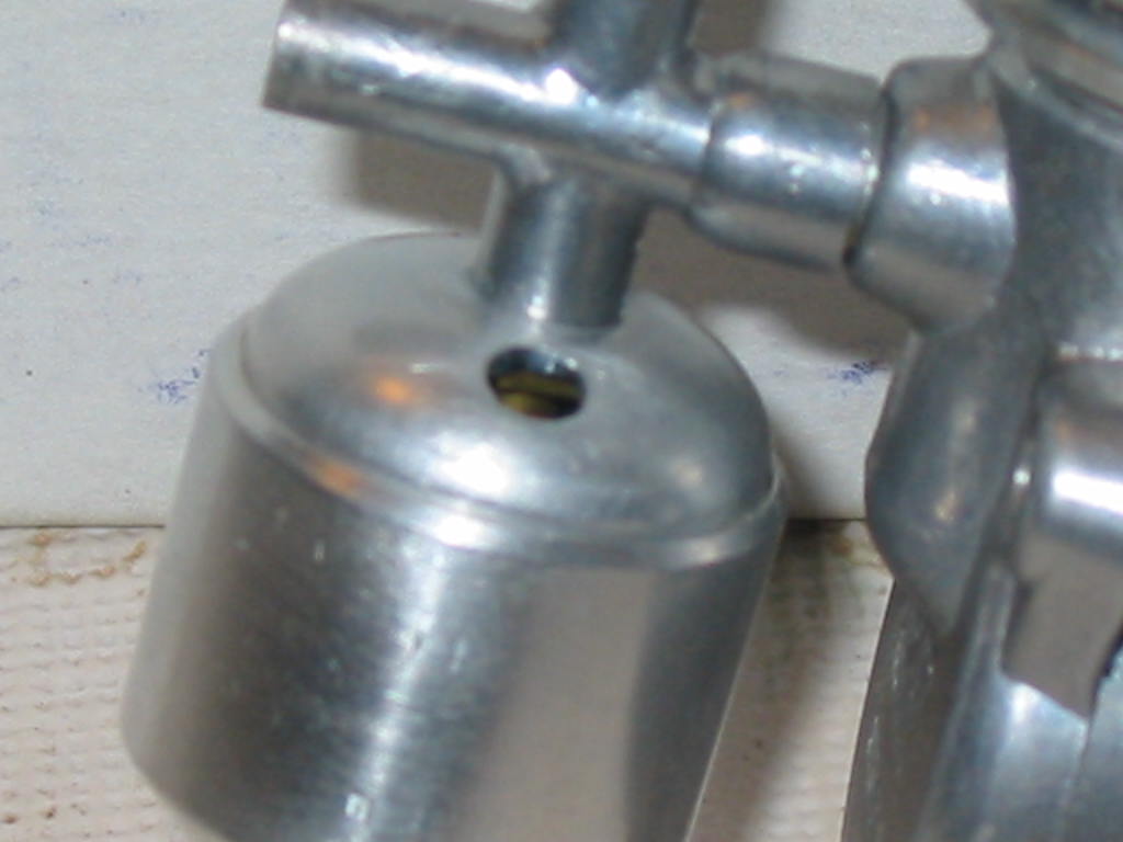

These are a bit tricky-a pity since they're very well made. The tank is simply made of three parts-the top, the cylindrical wall and the hemispherical base-and they're just pressed together. You should-with care and the use of a SOFT jawed pliers or some form of clamp-be able to pull the body of the tank off the top by means of a downwards and back and forth rotation motion-the top -as you surmised being attached to the venturi by the screwed in jet tube. this should then allow you to see how badly bent things are.

Hello
Actually the tank is not bended, but just loose. And there's no trivial solution to thighten it back because the nozzle turns in the tank hole ! I think nothing is broken !
The NVA from the Classic MPJet cannot fit on this engine, because on the Letmo it's press fitted and screwed on the Classic (like a mills)
Vincent
Vincent

Well it would seem your only practical option would be to get a complete tank assembly for a Classic 040 from MP Jet, press out the jet from the top side of the Letmo venturi, fit the Classic tank top, and press the jet back in-using some kind of thread locker to ensure it stays put, as pressing it out will have loosened the fit slightly. As mentioned earlier-the Classic tank bowl screws onto the tank top, so there is no problem is reassembling the tank.
It won't be quite authentic for the Letmo-but it WILL allow the engine to be used. If you had access to a lathe you could machine up a new tank top for the Letmo-thread part of the upper OD of the jet piece closest to the hex or locating flange and screw the tank top in place on the jet-and then use the sidewall and base portion of the original tank to complete the assembly-but you would have to destroy-or at the very least damage -the original tank top-in the process of disassembly. From the photo you posted I initially assumed that the jet portion had been bent, but in light of your second post I'd now guess that the original owner has enlarged the hole on the tank top by mishandling, and the entire assembly is now loose on the jet piece.
If you are exceptionally lucky and manage to get the tank apart without significant damage to the tank top-other than the enlarged central hole-I suppose it should be possible to fit a custom made rivet in this hole (which might have to be enlarged further to take it) and then drill this rivet to the original correct diameter to be a close fit on the jet, and press things back together as before.
A lot would depend on how thick the tank top material is-and how soft, as to whether this approach would work. From memory-and I haven't looked at my small Letmos for over a decade-the material thickness is fairly thin. If it was thicker i'd consider fitting a screwed bush rather than a rivet-but I doubt there is sufficient thickness to get an adequate thread.

Hello,
Thank you for your advice, but the 2 engines are very different in many points, especially when it come to tank mounting/construction.
There's simply no easy way to put a Classic tank on the Letmo (as I own the 2 engines, I will take some pictures to clarify this).
Vincent
Vincent

As for your loose fuel tank (as I did the same mistake of loosening it like yours)
1st I tried to pull down on the tank then tried to screw the nut inside by using the tank to maybe tighten it back up.
Maybe the curvature of the top of the tank would catch the nut to tighten it back up? NOPE!
Maybe do the opposite by pulling down on the tank and unscrewing the tank.
Hopefully have the nut catch on the curvature of the top of the tank to catch and not turn? NOPE!
Well, the last resort I did was to enlarge one of the fuel holes to 2.5mm.
Drilled a hole just slightly smaller than the outside diameter of the fuel tank in a 50mm block of wood.
Heated up the outside of the tank, then used an ice cube to cool down the bottom of the tank,
then tapped out the bottom of the tank using a 2mm rod in the 2.5mm fuel fill hole (that you enlarged)
while using the wooden block (with the hole for support) and tapped out the bottom of the tank.
The quick cooling with the ice cube at the bottom of the tank shrinks the aluminum while the bigger dia. of the tank os bigger because it is hotter (expanded from the heat).
One thing you will have to do is replace the vinyl fuel tubing inside because of the heating of the tank.

I know of your problem of the MP Jet Letmo MD - .06.
I have three of them. S/N-113, S/N-251 and S/N-260.
And there is a complete difference in the MP Jet .040 PB Classic Diesel.
I know that you cannot use the parts from one (Letmo .06) to the other (.040 PB)
