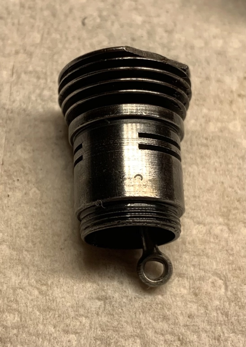

I decided to overhaul a QRC I won ebay a few years ago….After rebuild I ran three tanks thru it rich….. It seemed happy at the rich setting at about 11K…. Fourth run leaned out to 13.5 K, About like the info online indicates…. Using a Cox 6-3 and Glow Plug Boy 24…. This was with a standard glow plug, The one that came on it, Also using three head gaskets as indicated by the instructions for break in I found online….Runs about three minutes…. Wished it would go a bit longer…. Maybe with a little more run time?
Not the strongest of Cox .049s but unique with its muffler which does a pretty good job….Just a little more trouble to prime….Nice to get oily hands agin, Never thought I would have missed that

What is the number on the cylinder? QRC should be #6 or not numbered , 2 bypass and no SPI. Also should have a 1702 head on it.
If it’s just a regular bee with a muffler on it then those tach readings sound correct. If it is a number 6 cylinder then put the TD head on it. I would also recommend a 5x3, but depends on your plans for it. What fuel? 1 gasket for every 10% nitro. So if 25 percent 3 gaskets 20% 2 gaskets etc. it’s a wag really, but you can add or subtract gaskets until you see the best performance.

It has a mark on it but I can’t tell much from it…. Yes, dual bypass and no SPI…. Also no taper or very little in the cylinder…. Also no 1702 head, Just standard….
If I do anything with it maybe a simple 2 channel RC…. I’m shopping on outerzone to see what might be interesting….. The muffler is appealing because there’s a chance I could fly about one mile from home…. Closest RC field is about 1-1/2 hrs away

With standard head and 24% run one head gasket, should pick up some rpm. Not sure about run time. These engines require very little
break-in.
