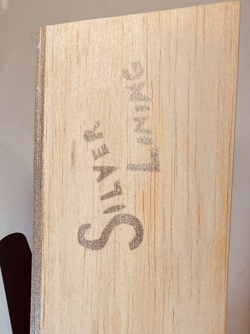

Post  rdw777 Fri Aug 12, 2022 3:52 pm
You bet, I would vote for an experienced CL’r to give it a try…. If it ever got airborne it would be a rocket!!
Sure, nothing wrong to experiment with the stencils, You have a few to play with… If you try to hold it down with water you might add a few drops of liquid soap to help position and stick…. You can try it on a test board first… When the tissue starts drying it will shrink and wrinkle but can be carefully ironed flat again…The weight method is a little tedious but takes care of loose edges…. Here’s mine right before paint..Trying to fit in 757e4610

Very close Robert.
