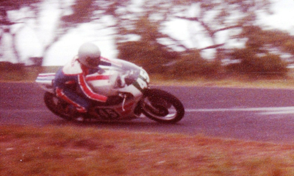

Below is one of my old TZ Jiggers I was racing at Mcnamara Park in south Australia. That bike when the photo was taken had a handgrenade qualifying motor in it, that came out that night and a race motor went in. The handgrenade motor had extra ports cut into the cylinder wall lining from the inlet going up toward the combustion chamber and then had to be re-chromed. It ran much bigger carbs, and was tuned/plugged chopped (barometer/Temp/ algorithym then to slect main and powe rjet) till we were detonating the piston head and cylinder head. The piston skirts were cut and the windows in the pisons were modified from normal TZ spec. It made power from 10,500 to 12,500 and if you were down at 9,000 rpm and cracked the throttle it would oil the plugs. so it was either braking or accelerating.
