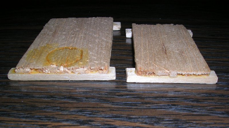

Tobaiies wrote:The wood is not really good quality, but I think it is sufficient.
The kits of the 1950's to late 1970's that were basically continuous runs of the earlier kits (Comet, Guillow, Sterling, Berkeley, Enterprise, Goldberg, etc.), the wood was more or less usable with exception of a few pieces, but certainly not optimal. It sounds like you are reliving our earlier experiences. Very Happy
1959 Berkeley 46-inch (1170 mm) span Impulse rudder only kit build:
Real-Kit Stick Impuls10
Fuselage formers are of such light wood they experienced die crunching.
Real-Kit Stick Impuls11
Fuselage side splice, die cutting was off, had to splice in several slivers to complete splice.
