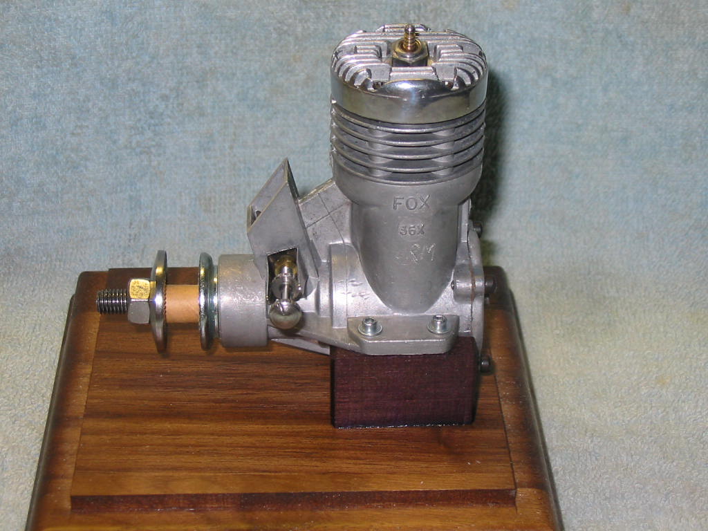

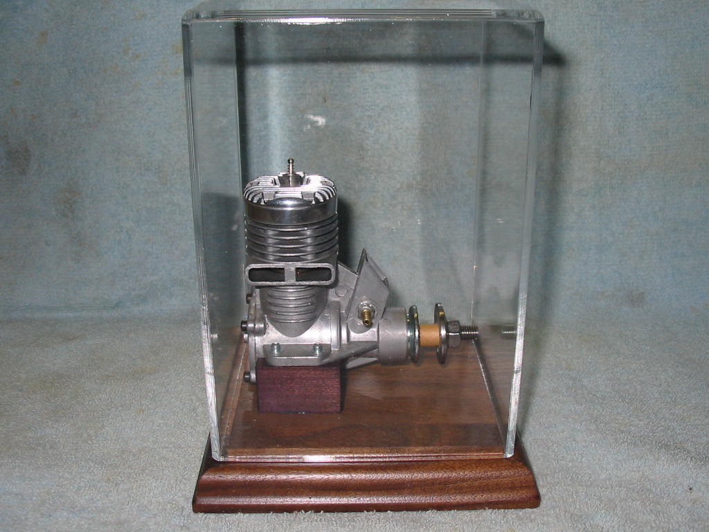

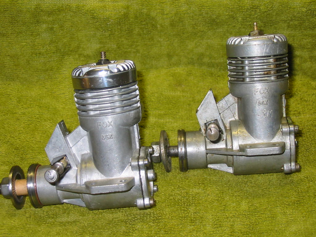

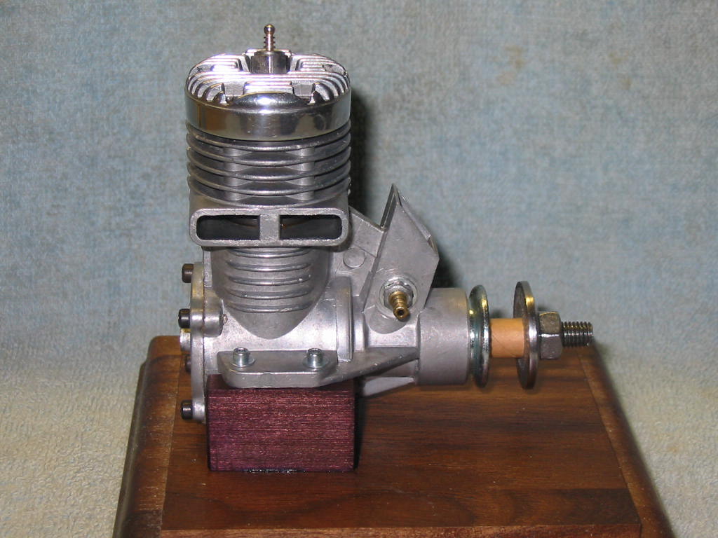

Well, here are mine and my brother's Fox Stunt 35 engines that we had back in 1973.
In the photos below My brother engraved his initials into the crankcase so I couldn't "borrow" his engine.
I cleaned both of them up and rebuilt both of them as well.
On my engine I polished up the head to where it is nice and shiny.
I then mounted my brother motor in a display case and gave it to him as a Christmas present (X-Mas 2021)
My brother won a few trophies at the AMA Nat for stunts back in 1973 to 1978 with his Magician and Ringmaster planes.
I flew only the Ringmaster with my Fox Stunt 35.

Looking good
Good old combat specials
You don’t fly any more ?

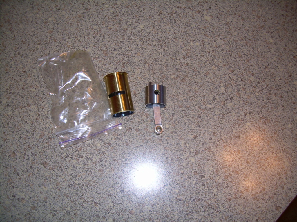

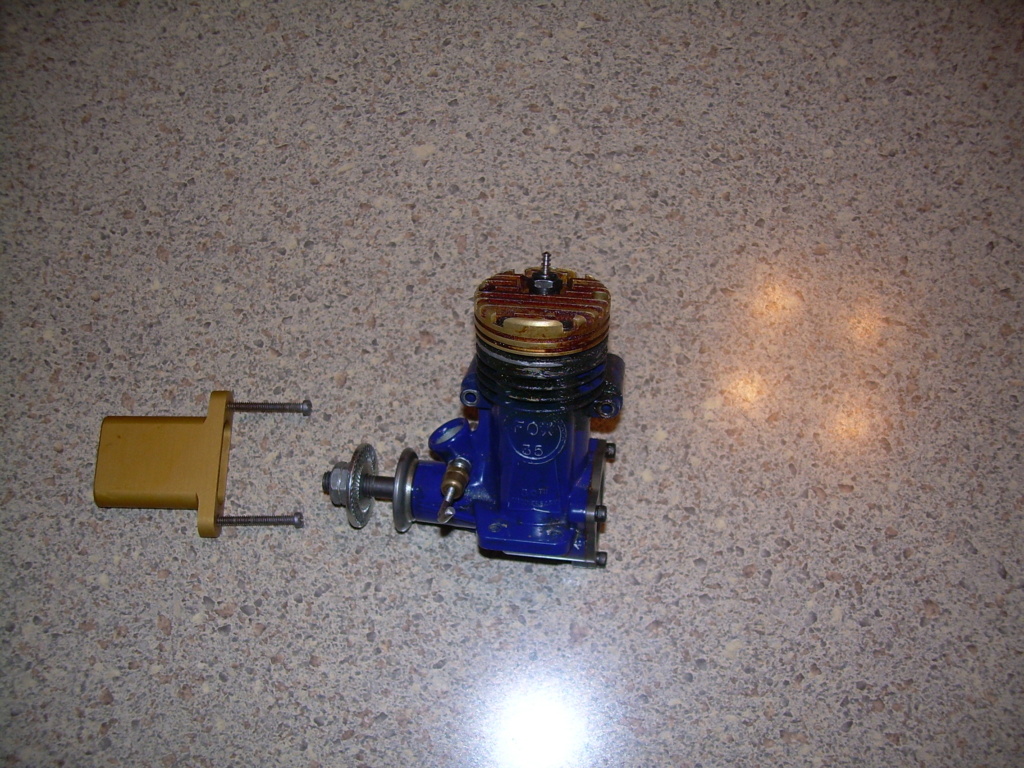

This is my last engine from them which was made available in the 50th case whereas the other is in the 40th. The prop washer, not the drive washer was aluminum when it came with this engine. It was similar to what many of the Japanese imports offer which is just a aluminum washer with a bevel on it. It was anodized gold but it was constantly slipping and the nut was digging into it so I replaced it back to the stock part.
The needle valve assembly in this engine was replaced. Although the one that came with it was good, the Randy Smith PA series needle valves are the best money could buy. Unfortunately, these are no longer available, the spraybar was custom made just for the Fox having the proper diameter as the stock. Needles are currently available but no spraybar.
The Brian Gardner ABC piston assemblies are just beautiful parts. I've converted most of my Fox .35's over to Brian's piston assembly. Impeccable runs and one flip starts. The rod is bushed on both ends with oil holes. Unlike the Fox conrod which was made in the stone age, the Gardener rod is stout.

Ken you knowledge of these engines is honorable for sure. And that engine you have is Beautiful a work of art. I don’t understand some of these hater out there for the Fox I really don’t but who am I. I mean sure there’s better running but I can’t forget where I came from. I love that engine, when’s the last time you had it running? I would love to hear it. I alstheard I think from you for the first time about the hemi head and the stuffed back plate I still have my feelers out but there is none to be found. I would love to get my hands on one of those. I have 1 more Carl Goldberg shoestring to build I would try and build that to perfection and put one of those souped up engines in.
Are those parts still available the sleeve and pistol by any chance

Brian Gardner makes the piston/cylinders based on numbers. He generally requires at least 20 and then he makes them. Covid put him almost 2 years behind on certain projects he has started. In addition, the aluminum I believe was from the Ukraine. This is stalled many projects for him. In addition, Brian does this as a hobby and not as a business. Many times he has made these to order and then the bs excuses happens when it's time to deliver.The wallet forgets to open when it's time to pay up. He has mentioned that he was going to catch up and then decide if he was going to do more. He might have a extra. These assemblies pre Covid were $100+ dollars and shipped from Australia.
There's several problems with the Fox. You love them or hate them. It's a cheaply built engine. It uses inferior materials and it's design is old as time. Duke wasn't willing to make changes as requested and the same old dinosaur you bought in the late 40's was still available in 90's. Quality control was quite poor which resulted in many sub par running engines. If one digs deep into the engine, you can figure out a few things to make them run better. If you ever have run a Max-s .35, you would know how smooth and beneficial that engine runs. It too had it's shortcomings but Duke should've taken some lessons on that engine.
I like them myself, I've used them all my life and I can diagnose essentially anything wrong with them. I've made parts for them and I've run them competitively in stunt. Some didn't want to believe my engine was a Fox .35. My Gardner engines essentially run like LA.25's now with the ABC setups.

I'm not looking to part with mine. I waited almost a year for my ABC assemblies and I'm happy to own them. Brian undersizes the bottom end of the rods so you have to fit these assemblies to your crank. This isn't exactly a easy process. Because of the way the underside of the piston is machined, the rod doesn't float back and forth like it does on the stock Fox. Even the stock Fox requires a bit of a trick to get the rod onto the crankpin. These assemblies are even more difficult with Brian's assembly. I've been running two of these engine simultaneously between two planes a Combat Streak and a Ringmaster. They're almost dialed in and they just run superb. I was fortunate to obtain new crankcases, shafts and heads to accommodate the new parts. Ever since Fox sold, I haven't been able to acquire new parts for the .35 stunt. Last year at a swap meet, I was able to buy the cases and parts.

I didn't make my engine blue, it was done by TCI Hobbies. The blue is powder coating baked on. My needle valve is a Randy Smith Aeroproducts stainless steel needle from Randy's PA series engines. Randy had them made for the Fox .35 which are no longer available. Your needle valve is a Fox needle valve. Nothing fancy about it, they were offered on the earlier Fox .35's. There a single hole spraybar whereas the needle for your Fox would've been a 2 hole spraybar and a needle with a flat on it.
In general, Fox quality suffers. The needle valves are pretty poor. They will and can work. Having a piece of fuel tubing on the needle to seal the threads on the spraybar is in order otherwise it starts sucking air through the threads. This can cause hard starting, erratic running and shutting off in the air. Duke used 3-48 threads most of the time and the threads are crude. This is one reason they leak bad. The other is the inconsistency from one piece to another,

Ok I like the blueing. I will pull the needle value and replace it with one of bobs.
