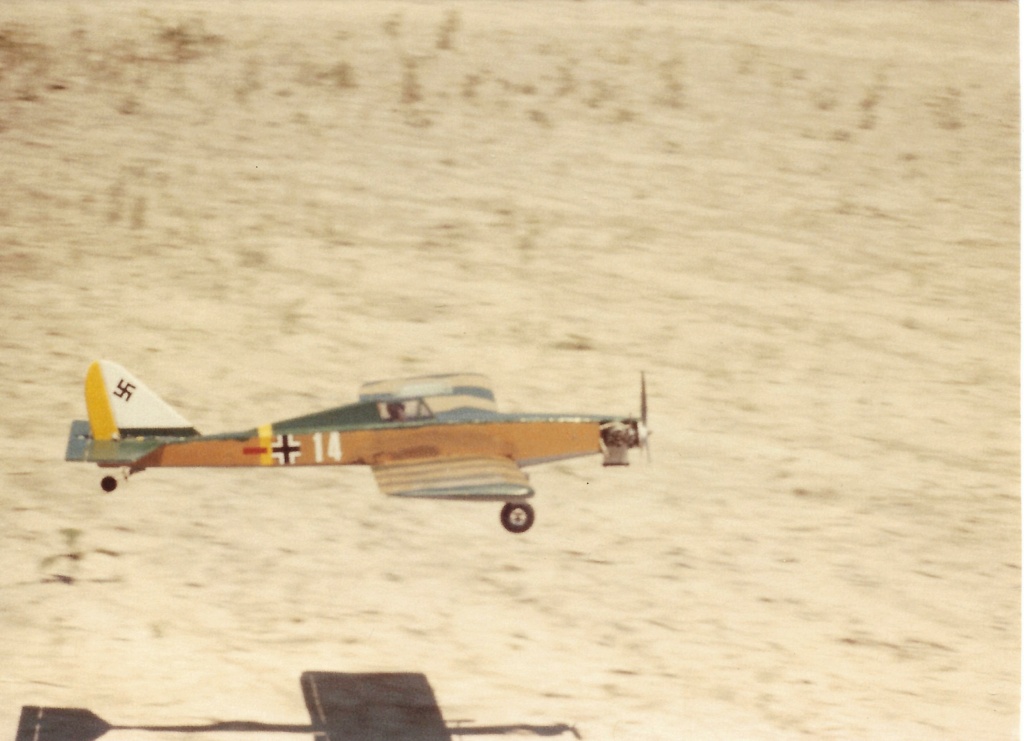

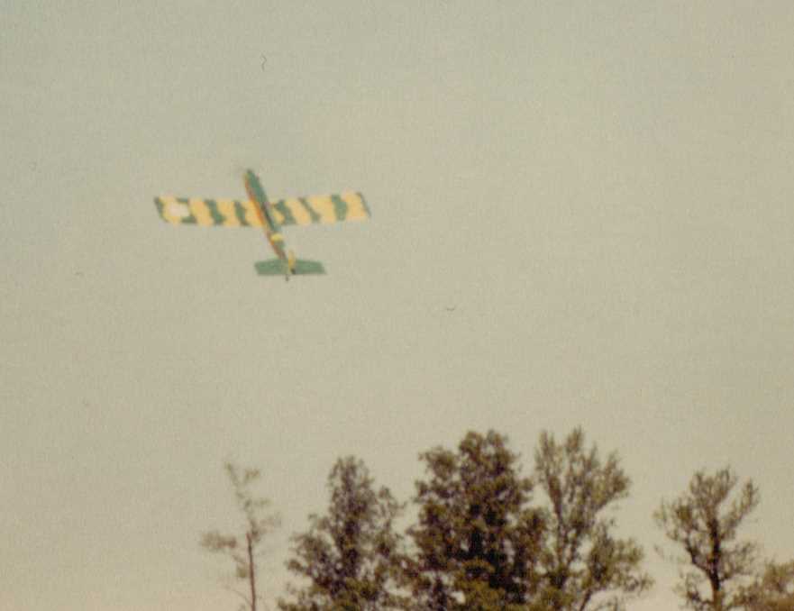

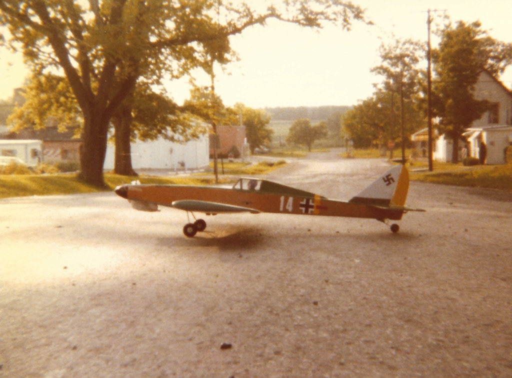

My first Bash Entry (and you are hereby invited to submit yours) is mostly "light cosmetic". I took a Spickler "Quickie 500" racer, and turned it into a "Sorta Messerschmidt 109". About the only mods were a reshaping of the tail, addition of a canopy and pilot, along with a cowling and spinner. One of my beloved O.S. .35's was bolted to its snout, and we were ready for the Battle of Britain. I named it "The Kraut".
The plane's generous wing area made it as sweet a flying machine as you could ask for, and I used it to teach myself to dependably fly inverted close to the ground. In spite of its DIhedral becoming ANhedral when up-side-down, it was super stable once trimmed, and the plane spent a lot of its flying time with its pilot looking at the ground. This would lead to a later, much more radical bash on another innocent model kit...to be listed next.
The plane had a long, hard life, finally succumbing to face plant that shattered the front end and wing root. This was another sickness-induced crash where I shouldn't have been flying, but Sunday was our one chance to all get together, so I pushed it, and paid the price.
I caught some crap about the Swastika on the fin, but the plane wouldn't look right without it.
My flying bud Neal got permission to use this giant stubble-filled field. There was a lot of clear dope/silkspan patching that following evening.
Luckily, Neal was a major camera bug, and caught a bunch of my flying on slides. This one shows the huge amount of wing area on the Kraut...along with its "Field Repair" patches.

Re: "Kit Bashing" What You Got??!! Midwest Models "Lil'T" Sailplane
Actually, I like the still life behind the aircraft. It looks dated, would expect Maud and Farmer holding his pitch fork upright.Kim wrote:I took a Spickler "Quickie 500" racer, and turned it into a "Sorta Messerschmidt 109". About the only mods were a reshaping of the tail, addition of a canopy and pilot, along with a cowling and spinner. One of my beloved O.S. .35's was bolted to its snout, and we were ready for the Battle of Britain. I named it "The Kraut".
The plane's generous wing area made it as sweet a flying machine as you could ask for, and I used it to teach myself to dependable fly inverted close to the ground. In spite of its DIhedral becoming ANhedral when up-side-down, it was super stable once trimmed, and the plane spent a lot of its flying time with its pilot looking at the ground.

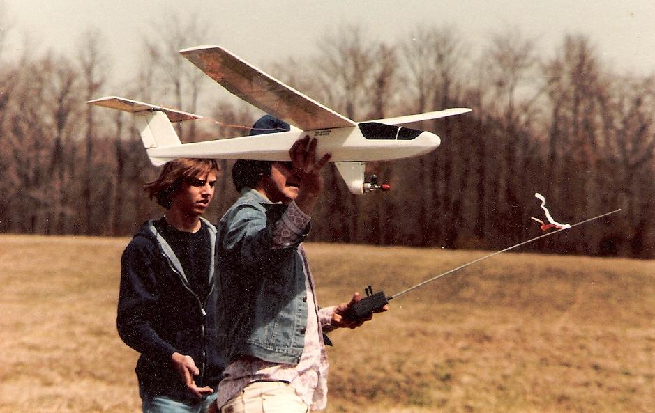

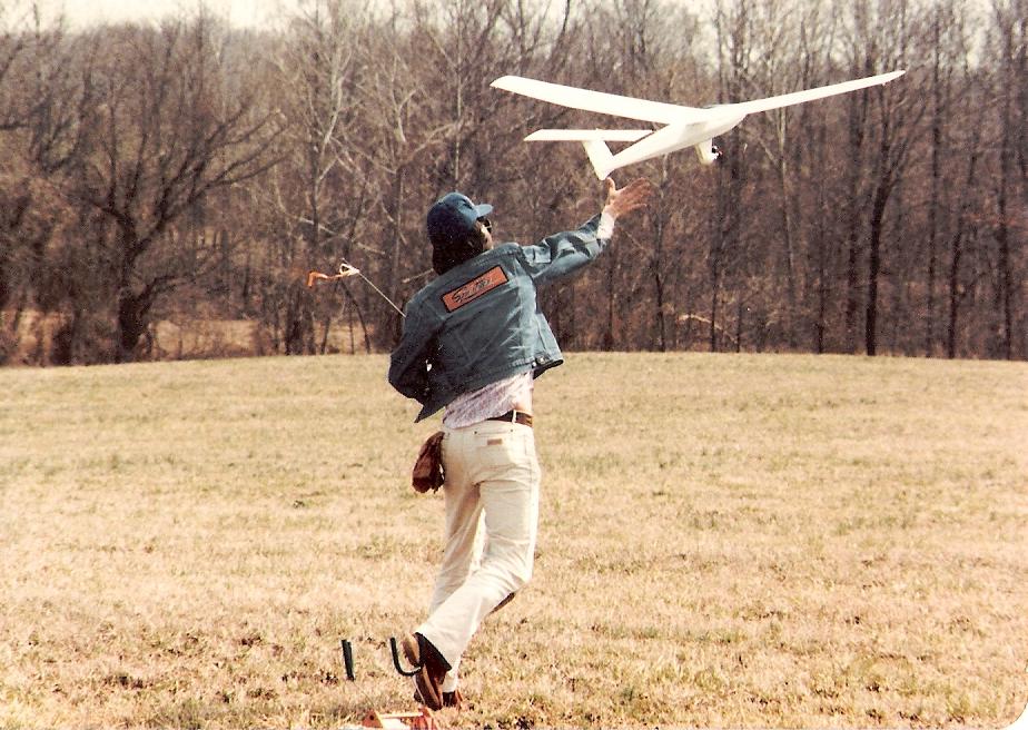

Still another "More Mod than Bash Project", Midwest's Lil'T was my first sailplane build, and yielded what I thought was a very pretty little scale-like glider. I was shooting for the "scale-like part", and changed a few items to take it more in that direction, even with it already being one of the most realistic-looking gliders of the 1960's.
My first "Scale Decision" was to flatten out the polyhedral in the wing, building it with only dihedral from its center. This, coupled with a tiny rudder designed for single channel control, caused it to steer somewhat like cement truck on ice, but I learned to give it plenty of lead, and NOT to count on any quick bank recoveries down close to terra firma.
I modified it's fixed horizontal stabilizer to be an all-flying stabilator, using a Goldberg 1/2A steering block. The actuating arm was epoxied into the fin, about a third back from its leading edge, with its mounting block bolted into a ply plate in the stabilator. With a control cable running up the front of the fin, this turned it into a two-channel glider, with the added bonus of the stabilator being easily removed for transport.
Then, rather than just put a power pod on its back, I decided to make a droppable unit to ditch the weight of the engine at altitude. At the time, there was already such a device on the market called a "Para-Pod", but I was ALSO looking to dodge the castor stream from the .049, so attached the engine to the plane's belly.
I built up the pod with space for a small parachute, and with a rubberband-loaded paddle to kick it out, once it fell from the glider. A ply hook at the back of the pylon engaged a dowel peg in the fuse, while another peg at its front was locked in place by a spring-loaded pin that was actuated by the elevator servo. A short command of "full-up" elevator, released the pod to a hopefully slow descent back to earth.
Probably needless to say, this required many "trimming flights" and mechanical adjustments to get the pod and stabilator working together. There were several repairs from the plane landing with its pod still attached when its engine failed at takeoff, or accidental releases with the .049 still at full song, and choking on its own chute. Things could also get exciting when the pod's chute didn't deploy, with the engine whistling back to earth at terminal velocity. The price you pay for realism!
One pleasant off-shoot of the engine's ultra-low thrust line was that, once everything came together, Lil'T would climb nicely on its own, with just slight rudder inputs needed, and it's elevator untouched 'till release of the pod.
