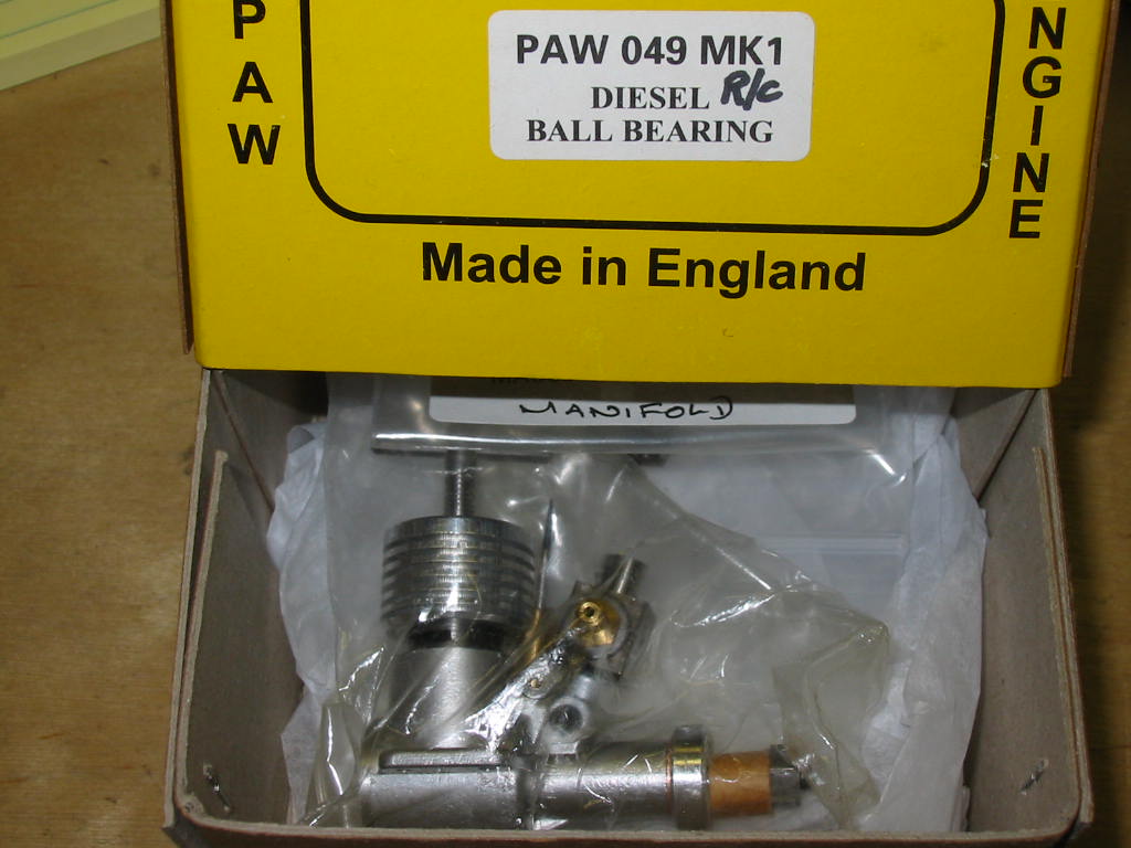

For little diesels, I have a mix of a few:
CS Bodo diesels
Anyone recognize this 049 diesel head? Cs-bod12
Or a Redfin engine (was made in the Ukrane until the war (factory hit by a bomb from a plane --- no one hurt  Thumbs Up )
Anyone recognize this 049 diesel head? Cs_ref10
The small PAW diesel engines:
Anyone recognize this 049 diesel head? Paw_0411
Irvine Diesels:
Anyone recognize this 049 diesel head? Irvine19
My favorite Enya diesels:
Anyone recognize this 049 diesel head? Enya_209
Anyone recognize this 049 diesel head? Enya_208
And a few more.
The engines that are designed as diesels do much better than the ones that were glow engines converted to diesel.
But, the diesel engines are a bit heavier
