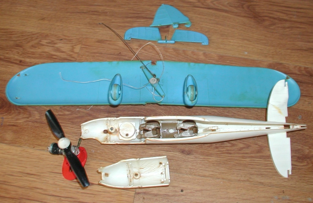

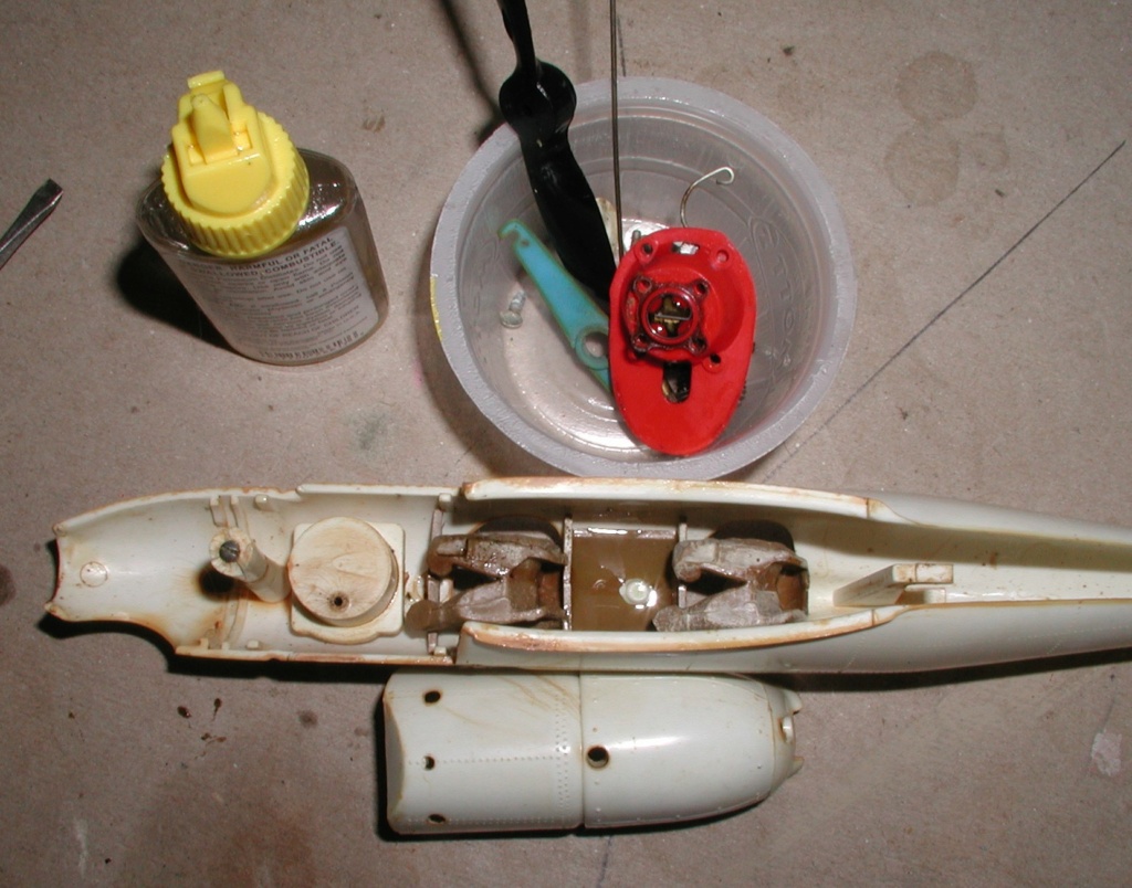

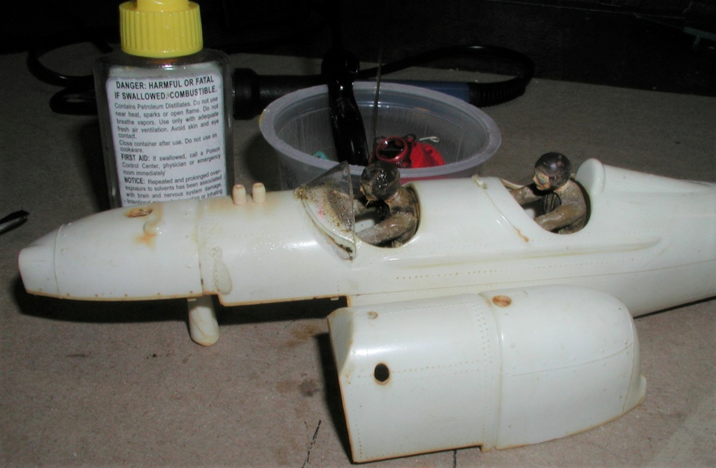

To the uninitiated, anyone that doesn't share affection for these little Cox gems.  If it seems I am making more of this than what I should, it's because I am.
Everything is castor locked  and by carefully applying heat to the needle and the case screws all removed without grief but not without significant resistance.  In the past I have left the tip of the needle (twisted off) in the NVA and damaged the case screw heads all because of lack of heat.
Being very careful I twisted off the purpose built backplate/mount sticky with castor.  You just can't heat up plastic.  Then using a heat gun loosened up the locked engine and made a decision not to disassemble it.  Berrymans's dip and that's it.  I'm even leaving in place the very disliked spring starter.  But, If I could find one of those circular spring throttle sleeves............
The little guys do not want to leave the cockpits.  A combination of castor lock and construction techniques.  Having a difficult time convincing them.  Letting them sit in a puddle of RemOil for a while might change their minds.  Same for the windshield.  I need it to make a mold for the missing one.
Baby steps with this one and I know I'm going to bust that windshield.

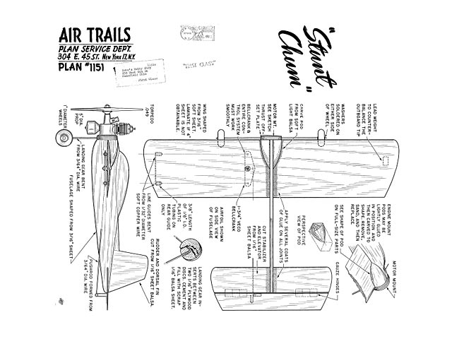

Interestingly enough, coinciding with Bob's .020 RTF restoration efforts, Outerzone recently published a slick looking 1/4-A C/L plan:
https://outerzone.co.uk/plan_details.asp?ID=14527 15in span Stunt Chum C/L by Frank Ehling, November 1951 Air Trails
With trembling hands I begin on the Cox Ryan ST 1452710
It would be very suitable for a Cox Pee Wee.
