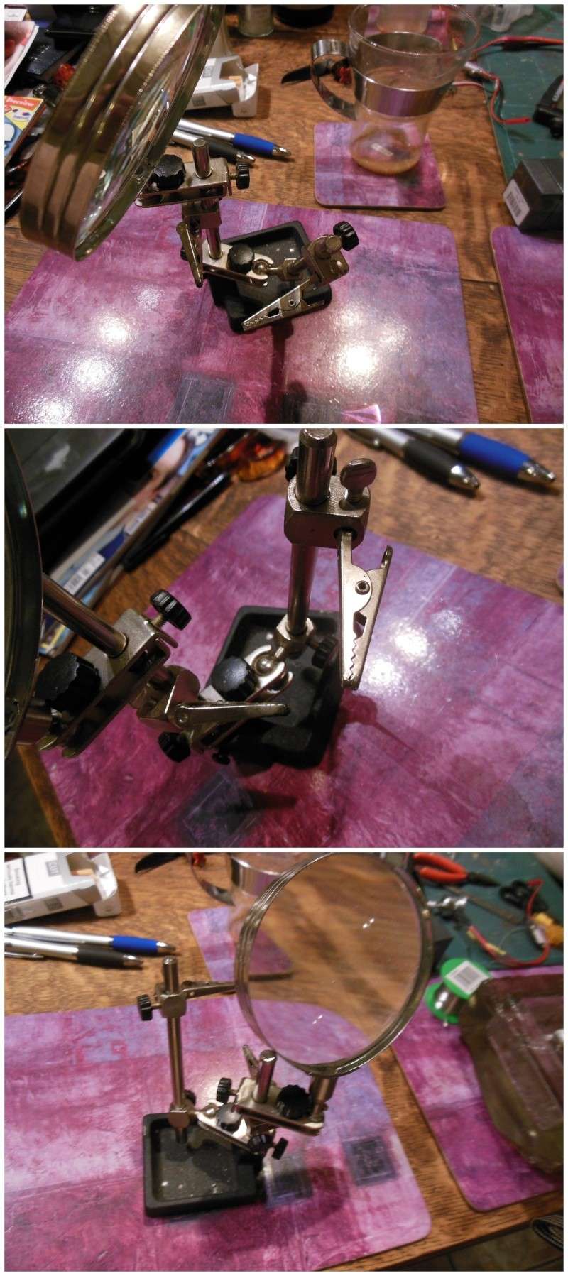

Roddie has mentioned "Helping Hands" in a previous post. It is a useful gadget for holding and soldering bits and pieces together.
It can be very fiddly to use. Adjusting the arms and crocodile clips can be frustrating and repetitive work isn't as straightforward as it could be.
I would be without one though - it has its place and trying to hold a soldering iron, solder and parts to be soldered together without one is difficult.

I do like that! "Mr. Jig"... I would like to make one from something non-conductive.

Take a length (4 inches to a foot) of solid copper wire, say #12 house wire, put an alligator clip on each end. The uses are many and varied when it comes to solder and paint.

pkrankow wrote:Take a length (4 inches to a foot) of solid copper wire, say #12 house wire, put an alligator clip on each end. The uses are many and varied when it comes to solder and paint.
That's an excellent idea Phil.. and so simple to make too! Lock it in a vise (or a set of locking pliers used for a base)... and you've got an extra hand!
