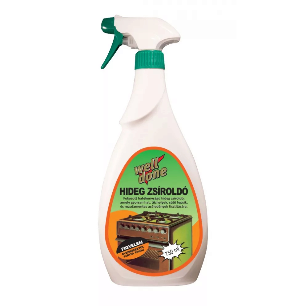

Interesting comments on the bottle:
Bottle in Húngaro (Hungarian) wrote:WELL DONE HIDEG ZSÍROLDÓ Hideg Zsíroldó Fokozott hatékonyságú hideg zsíroldó, amely gyorsan hat, tüzhelyek, sütó tepsik, és rozsdamentes acéledények tisztitására.
WELL DONE COLD DEGREASER Highly effective cold degreaser that acts quickly to clean stoves, baking trays and stainless steel utensils.
FIGYELEM gyermekektől tartsa távol!
ATTENTION keep away from children!
Here in US we may have a similar product, maybe the same, just different name. Maybe EASY OFF?

Interesting, it is available in US, $28 for 3 bottles:
https://www.amazon.com/Well-Done-St-Moritz-Cleaner-750Ml/dp/B01FRPJRK6
Cylinder devarnishing -again 41x7ma10
I think you may be onto something new, András, a better way to do than traditional steel wool specified in the Cox engine instructions. Thumbs Up

Well Done is 20-25% KOH (potassium hydroxide) plus surfactants. Zep Oven Cleaner is cheap and contains less KOH, but should be effective. There are probably others. Many oven/grill cleaners don't use KOH anymore. It looks like Easy-Off Heavy Duty uses lye and other stuff.

Thanks for the clarification, @gkamysz.
rsv1cox wrote:I have used Easy-Off oven cleaner to remove paint from plastic parts, wings etc..  It's highly caustic, does a good job but make a mess.  I don't think I woud use it on engines, but if it's the same ingredient that is in the "Well -Done" product I would be very careful of it although Andras has had good results.
Of course, Bob, definitely protective gloves required, but everything we do with model engines is risk assessed. (Heat, boiling chemical bathes, caustic and cancer suspecting respiratory unsafe solvents, dangerous to human flesh rotating props, and etc.)
But properly managed, the results are outstanding. Wink But then, we were permitted to learn risk assessment growing up (no car seat belts, bike helmets, knee pads, elbow pads, back braces, goggles, etc. Laughing ).

Bob, Levent, Roddie, George, Greg and all, thank you. This is a rather aggressive degreaser indeed, without rubber gloves your finger immediately feels like slippery if in contact with it, indicating that it dissolves human fat too.
So precaution is recommended, the same as with nitro in our fuel.
But it is fast and effective. Clean the cylinder rapidly, do not leave it on the steel surface too long because it may cause some iron pick-up (not that I have experienced any visible corrosion on the cylinder). But all in all it is much more cylinder friendly than any fine steel wool or devarnisher brush that are known to scratch and hone the cylinder when scraping off the varnish.

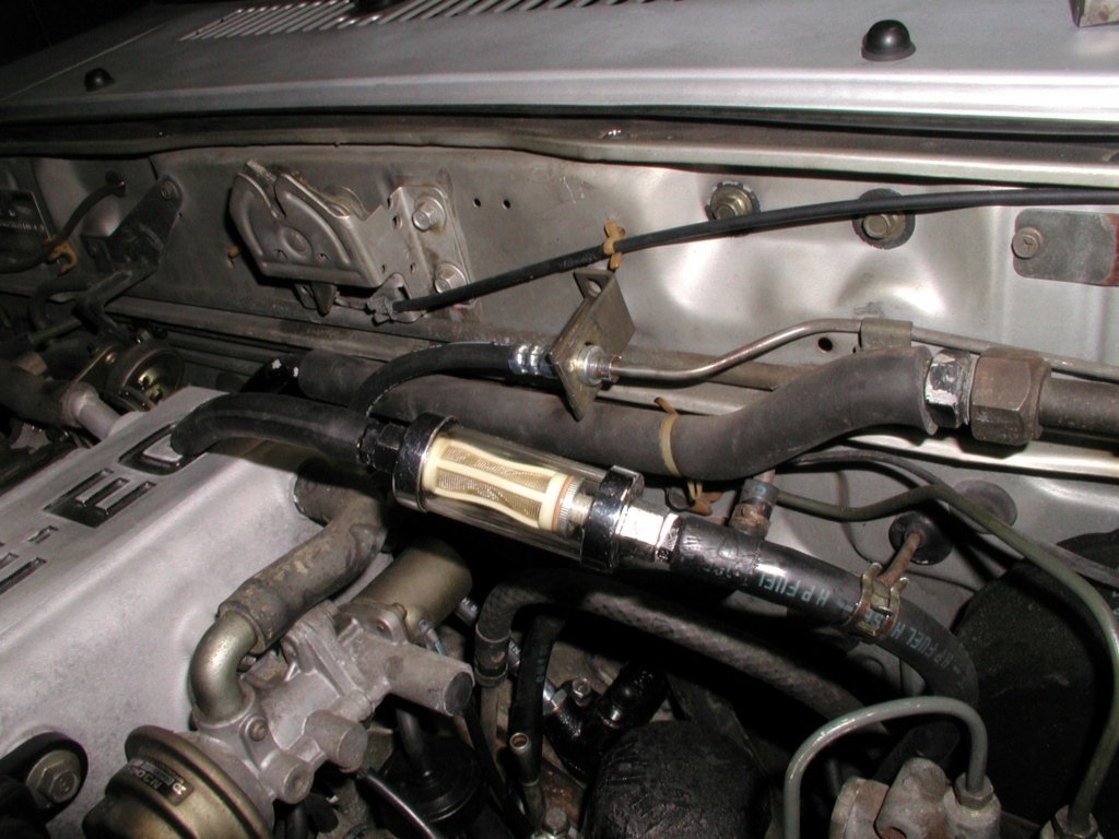

I put a final gas line filter in my RX-7 splicing it just ahead of the fuel rail (fuel injection) in the engine compartment. New fuel tubing that fit perfectly on the metal line reaching down about an inch and a half. Tight fit and I couldn't pull it off but I didn't have a clamp to secure it. That was about three weeks ago. I have ran it many times since, in the garage and out.
