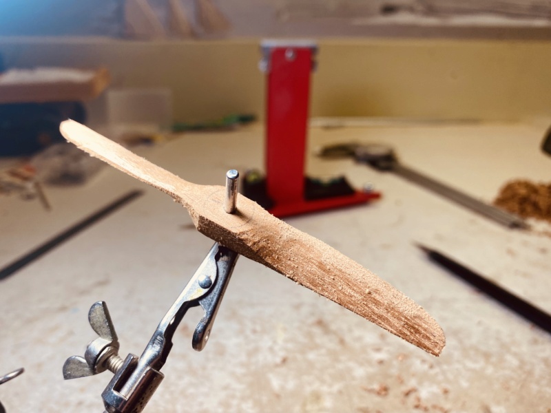

Post  rdw777 Tue Jun 13, 2023 5:56 pm
I’ve carved balsa props for rubber FF and some catapult glider wings…. But never a prop for a gas model…. I found an article on OZ that had a simple formula…. Of the woods that was appropriate it listed was hard Mahogany and I had some so I gave it a go………..A 4x3 for 020…
Carving Props Cafeca10
Carving Props 2ab40a10
I finished it with Sig Lite Coat…. First coats were very thin to penetrate best possible….
Next to a Cox 4.5 x 2.5…
Carving Props 0c6ee610
I have not ran it yet… Letting the dope cure…. If it works out I’ll try it on Pageboy…
Carving Props 9a12ad10
Anyone else tried this? I’m open to pointers, articles, cautions… etc…

Post  rsv1cox Tue Jun 13, 2023 7:07 pm
Beautiful job as ususal Robert.  Sharp blades and patience.  Special engine, special prop. How did you gauge the pitch?
I keep blocks of Mahogany around for gunstock repair.  As with everything else I buy the worse examples I can find and "fix them up."

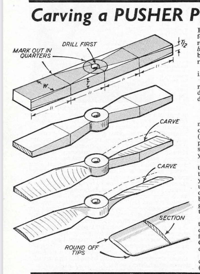

I remembered the carving a propeller in a page of Ladybird Books Air, Wind and Flight, a book from my childhood days. Very Happy
Carving Props Img_2106
Carving Props Img_2105

Post  HalfaDave Wed Jun 14, 2023 7:59 am
Hi rdw777,
Beautiful work, thanks for sharing. Cool
I've tried it. 1974?  Pushy Cat, OS.15, the only pusher prop I could get was an 8-6, that did not work.
Found some info in model mags, and set out to carve my own wood 'pusher 8-4'...
Everything went well.
I got to the stage of your first photo, put it on the plane to admire it... Then realized, it was a RH pitch !  Doh!
The LH prop was easier to do with that practice. Smile
It worked,  and flew the Pushy Cat to several under powered flights...
At that time, the pusher thrusts on that OS.15 had done it's toll. Sad
Last pusher plane I've tried... Smile
The prop making was interesting. Marking it out carefully, then shape to that.
Not sure what wood I used (the article said to avoid knots !) Sealed with Buterate dope.
I do remember that it was as 'flexible' as the all nylon props of the day...
Some wood props were were advertised as 'Hard Rock Maple'... Mine was probably semi fine grained ceder or spruce !

My hint,
Make sure it is a LH or RH while marking it out, then, carve away... Smile

Thanks for the articles Eric Very Happy….. I like to read so that will keep me occupied for awhile  Thumbs Up
Love the artwork on the book Levent, And nice that you still have it…..The image of the boy with the knife reminds me of my dad teaching me, Always cut away from you….He taught us how to sharpen too…. Funny, We all carried pocket knives as kids, And I still do today…. A little Buck knife I’ve carried most of my life….
Carving Props 24054910
The article I stumbled onto was for a pusher as well Dave….. I just back tracked the information and made it the size and shape I wanted….
Carving Props 055beb10
Carving Props Cf9ad710

Post  HalfaDave Thu Jun 15, 2023 12:12 am
Hi aspeed,
The 'Rock Hard Maple' may have been a local hobby shop ploy,
To get us to buy the wood props in stock.
They snapped like twigs, compared to the white nylon props that were basicly crash proof. Smile
A 6X6 prop?
Seems impossible to get the wood grain right... Smile

rdw777,
That was the basic info I had. Smile Drill a hole in a piece of wood, carve/measure/repeat.
Good luck on your test run.

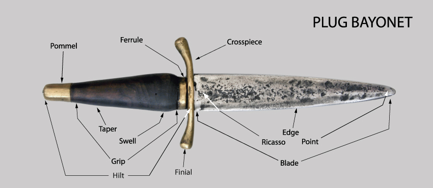

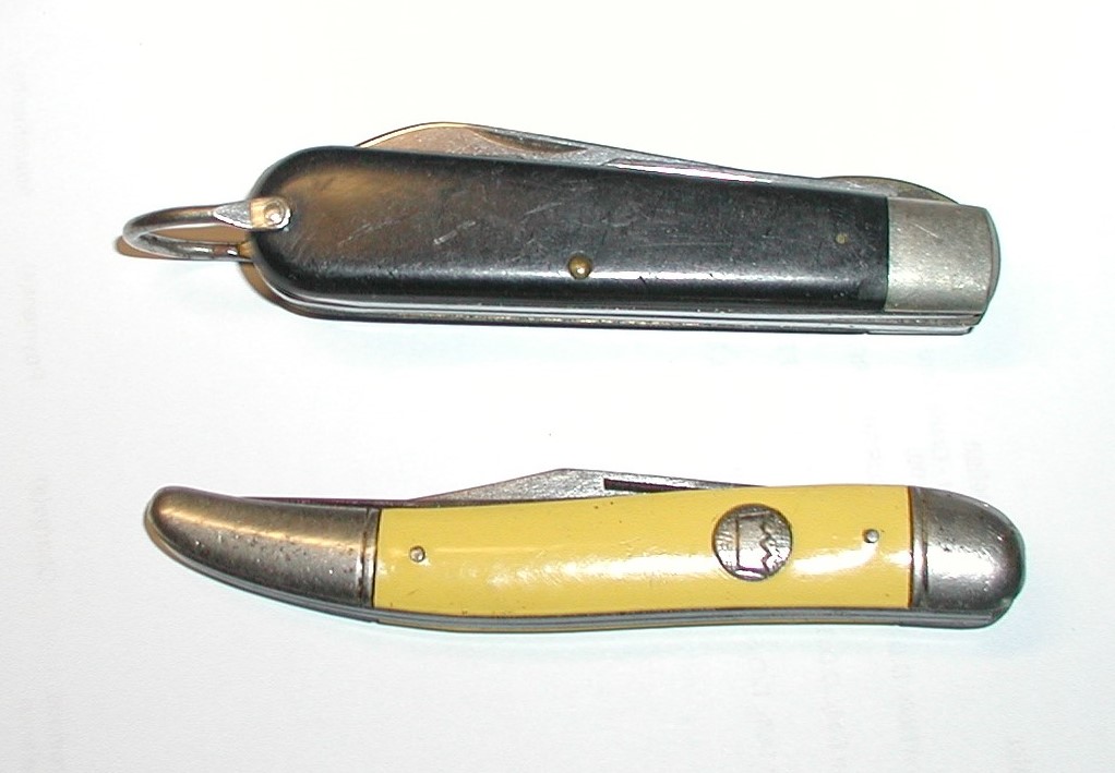

Ok knives - pocket and otherwise.
I'm not a knife guy, but I am a bayonet guy which share the same ID terms.  Interesting if you don't know them already.  Got me going when I was ID'ing my Dad's knife (yellow handle) and mine looking at the "Ricasso" for the manufacturers markings.  Dad's Imperial (Irish manufacture) and mine Camillus (USA manufacture.)
Carving Props Knife-10
Dad's Imperial knife was the "fish" version, curious as Dad was not a fisherman yet he carried it or one just like it all his life.  Mine went with me only on camping trips.
Carving Props P1015533
Carving Props P1015534
Apologies for the drift Robert but bayonets are so interesting, a history lesson in themselves. Many came with the military surplus rifles that I collected from all nations. Researched every one.
Carving Props Sword_10
Carving Props Plug_b10
