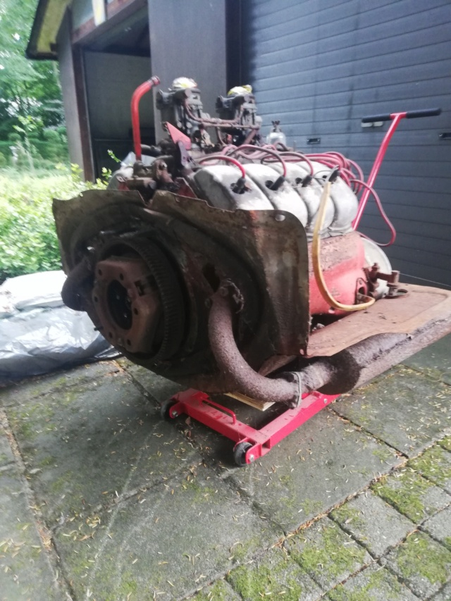

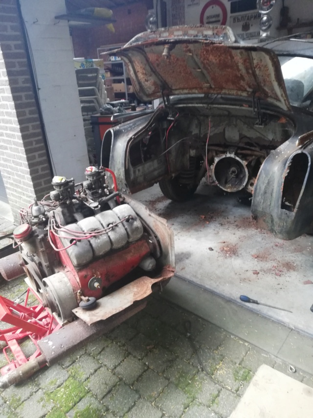

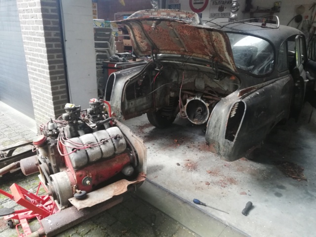

Last friday afternoon, I took the V8 engine out of a Tatra 603 T3 of 1972. The engine itself dates from 1966. This is a 1 man's job and is eay and straightforward. After removing the rear bumper and the rear plating with the thermostat housing, and undoing the common electric cables, rods and fuel line, the engine can be unbolted from the gearbox on which it is attached with four M10 studs and nuts. The engine then just comes off with fans, mufflers and guide plating for the cooling air.
This is a donor car and is totally rusted. I don't understand how it hasn't broken in half yet!

I'm green with envy Lieven. Wish I had been there to help/watch.
Engine looks good on the outside. The body on that rare car...........I would be tempted to restore. It can't be much worse than the MG I did a couple of years ago.
Thanks for sharing. Updates, updates!

Bob, the bottom part of this car is just a carastrophy. It's a car for the Flintstones. The car is at my dad's place in Belgium. The one I have in my garage is a 1963 model and one of the first T2 603 's. The production started in December '63. The body is very sound with only some minor body work and has still got it's original engine. So I 'll concentrate on that one. I bought the car in the late 90's and I' m decided to get on with it.
To be continued...
