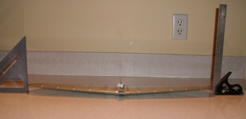

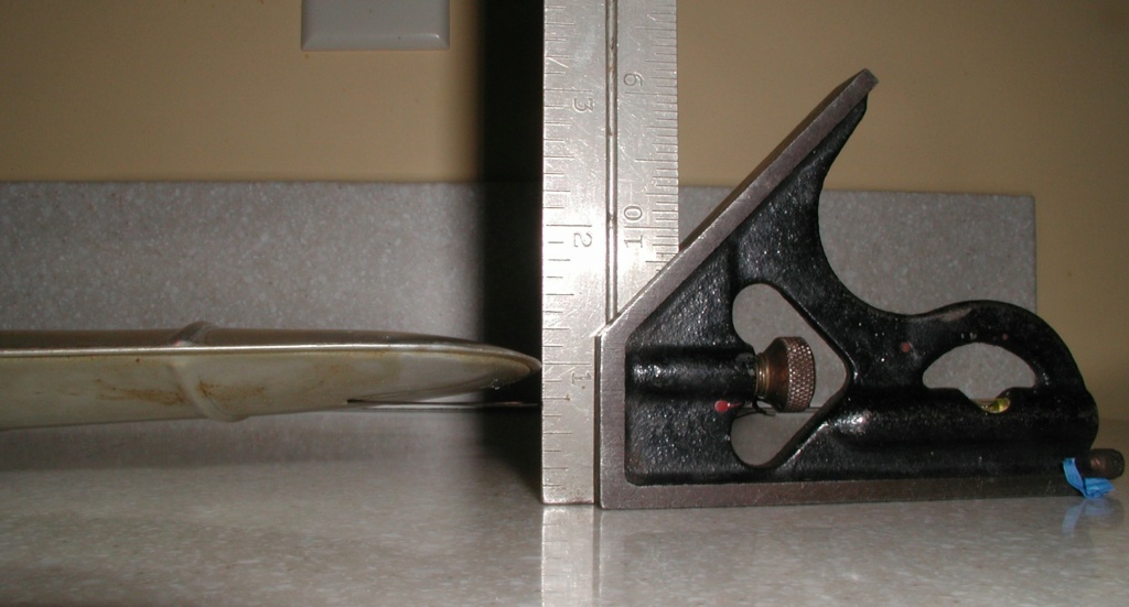

Thanks for posting this picture! I wondered if the TD-1 had dihedral, and it shows that it does.
Can you measure the distance from the countertop to the raised tip? Thanks.

duaneh wrote:Just an idea, but you might try the "Mr. Clean Magic Eraser". It is a very mild abrasive, so try first in a place that won't show.
Thanks, I have been wondering about that as well, prompted me to measure. Appears to be about 1 1/8" at the tip. Fully symmetrical wing, not cambered.
Thing of beauty. Leroy knew what he was doing, or employed people that did until the bean counters entered the picture. This model is so far ahead of the later plastic models that Cox produced. I will cover that in my other thread.
