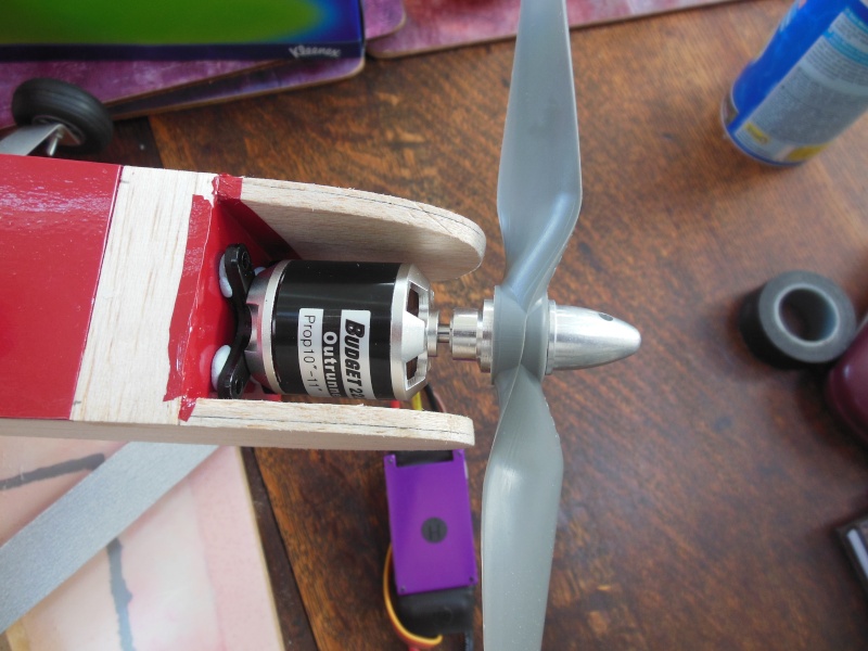

Mark and Phil,
The motacalc software looks good but it still doesn't answer my question on the disparity in calculation of motor size between CL an RC. Maybe that should be another topic!
However, I have just got off the phone with the chap that recommended the motor. My so called expert friend - he who deserves a slap!
I said "That motor is probably three times too powerful for the Hummer, what made you recommend it?"
He said "I measured it and it fits!"
Anyway, I looked at the link that Mark posted and the 1400 kv recommendation of Phil - rummaged in my box of bits - many boxes and many bits!
I have a Turnigy D2822/14 1450KV - it doesn't fit but luckily I haven't covered that area yet! I will have to remove some wood.
http://www.hobbyking.com/hobbyking/store/__12916__D2822_14_Brushless_Outrunner_1450kv.html
Do you think this will be OK? - I have 2s and 3s batteries - 7 and 8 inch props!

Hi Ian, It's good that you're re-examining the elec. power options for the Hummer. I am just learning about elec. powered flight... so unlike Phil and Mark; I can't make any accurate "technical" recommendations there... but if I were to build an elec. powered Hummer... I'd try to come close to the weight and thrust of the recommended glow engine and fuel tank size for the model. Let's say that Sig recommends a Cox Tee-Dee .049/.051 with a 6 x 3 prop and 1 ounce fuel tank... I would "weigh-up" a full fuel tank with engine, and shoot for "as close to that weight as possible" for an elec. motor/battery combination. If your closest elec. combo is a little "heavier"... the battery(s) can always be moved rearward to balance the plane, and unlike a fuel tank; battery weight doesn't change, between a charged to discharged state.

I get it, it fits so...
I ran into this on a Ringmaster Jr. I am electrifying. I got called on it too. I was told similar stuff. For most performance matching thrust or prop size and RPM are more reliable than watt output. I ordered a .10 equivalent motor...it can swing prop and produce thrust like a .40.
I am figuring I have the airframe, suitable batteries, so why not?
Don't carve on the nose, plan to install blocking. Electric drive lines typically weigh less than glow fuel drive lines after all is accounted for. This means that the plane will become tail heavy and require ballast.
Glow fuel weighs approximately 75% of water, FWIW.

I am seriously considering ( 3 seconds past) - done. Considered! I will be going for full sized electric control line. I would like to see your progress.pkrankow wrote:I get it, it fits so...

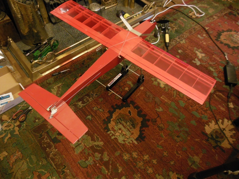

The Hummer is now finished
Balanced

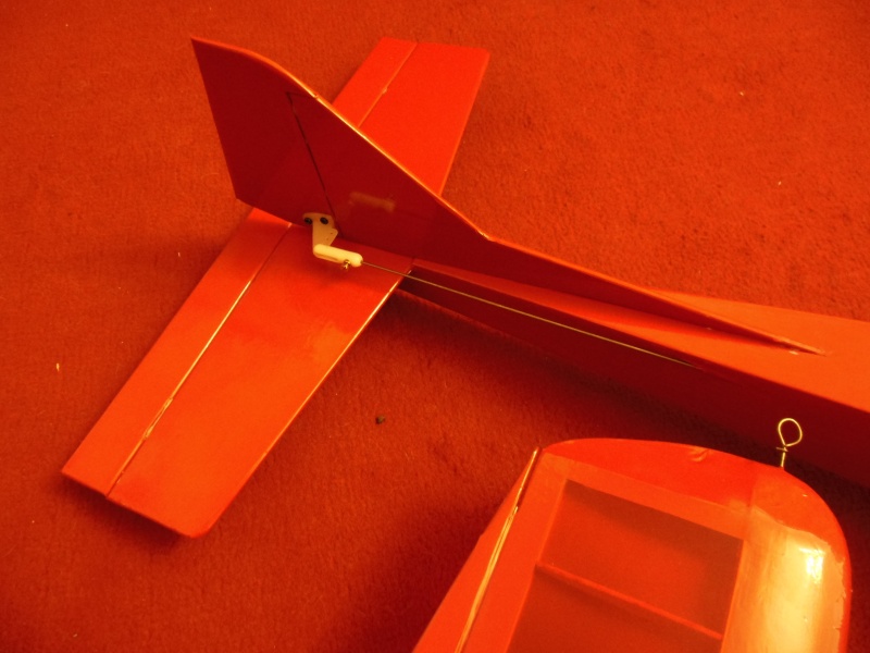

Rudder modification

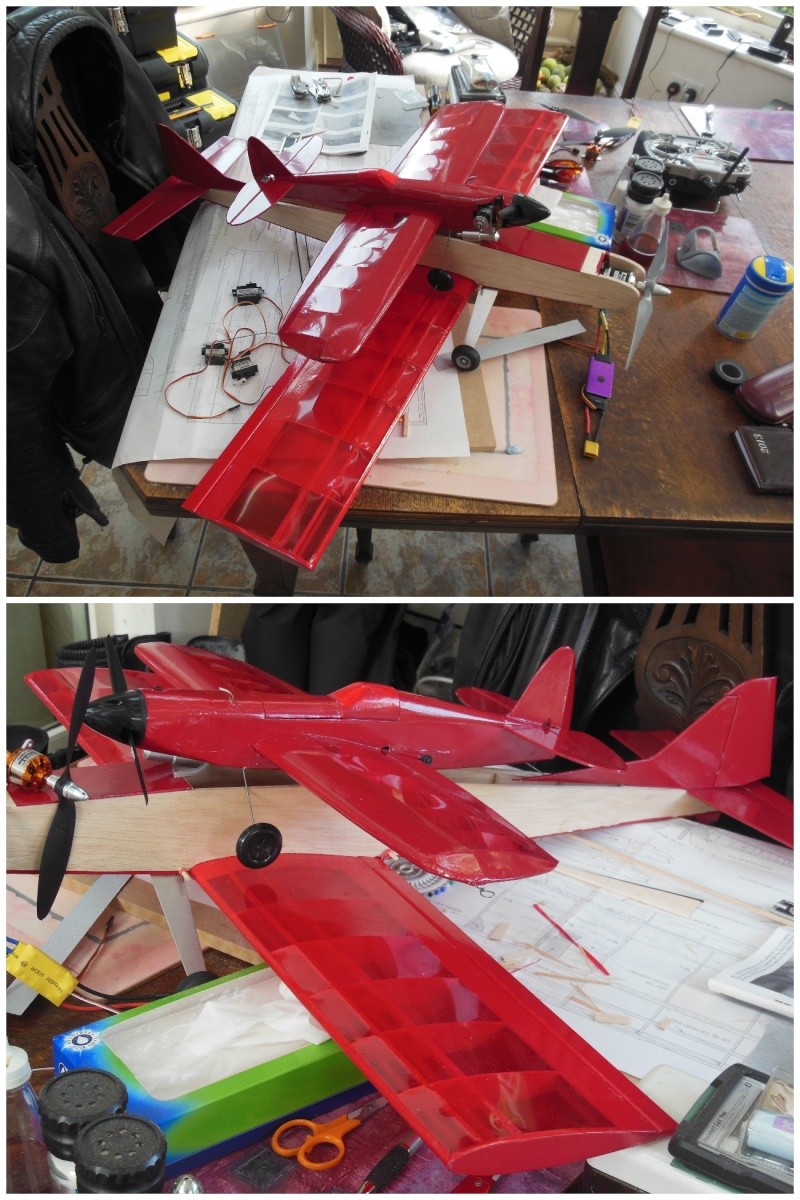

Posing with little brother

The Hummer Looks great Ian! Looks like it balanced-out real well! In that photo; is that a hearth for coal-fired fireplace/stove, that I see in the background? Looks like a coffee pot sitting on the hearth... and a brass hammered-finish coal bin on the left? I love that stuff! There's nothing like a nice "roastie-toastie" workshop in the Winter!
