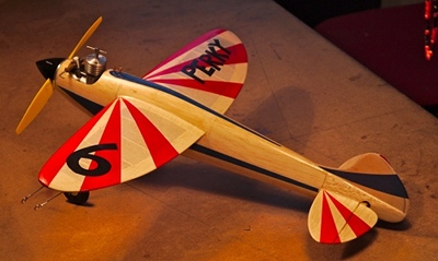

Over here, someone made a Perky last year:
Perky photos Perky_10
Perky photos Perky10
More pictures on this forum:
http://www.retroplane.net/forum/viewtopic.php?t=3561&postdays=0&postorder=asc&start=255
Good luck with the build Jim.

Hmm,
Totally different wing on that one.

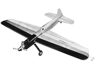

Hey Jim.. got the "need for speed"??  Affraid or WOW!  I'm curious if you're planning on making a take-off dolly.. like the one in this photo that you posted a few weeks ago?
Perky photos Jpvelo10
Posts : 7793
