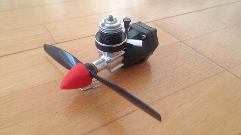

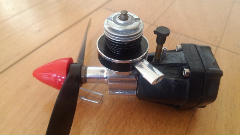

Hello everybody,
after a long time without any improvement i decided to rebuild the engine. The spare parts also lay here for a few month.
So after a clean up in an ultrasonic cleaner and some polishing, the engine looks like a new one. Only the plastic tank looks not so good.
In the next few days i will fire up the engine. If the engine runs nice and smooth, i will go further with the Sky-Rally itself.
Have a nice day!
bnitram

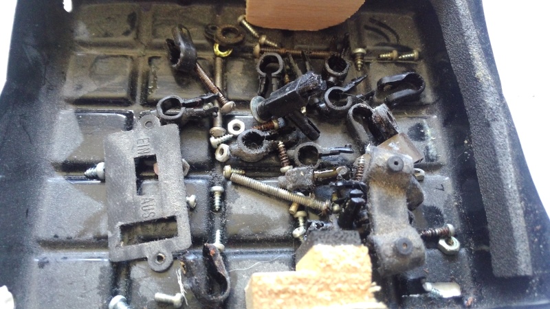

Hello everybody,
today i disassemble the main alu frame. Some tubings are bent or broken. I will make some new ones and replace them. The good ones will be cleaned up.
Also the connectors has to be cleaned up.
After that the airplane can be reassembled with new electric and then i can bring it back to the sky...
bnitram
bnitram

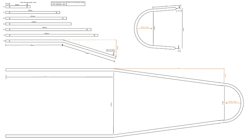

Hello again,
today i cleaned everything up and start to rebuild the frame.
Some plastic connectors are missing. I thing i have to rebuild the connectors.
I also made an overview of all aluminium pipes and measured everything up. If any more details are needed, just ask me.
Nearly all parts from the frame:
bnitram
bnitram

Re: Cox Sky Rally Kyosho Cox 049 -> It goes on
Can anyone read the numbers on the tube lengths? I can't read them well enough to replicate.
