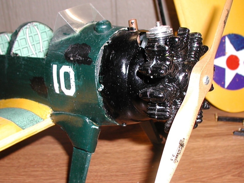

My son found this in an antique shop today. Control line, should be a flyer.
Interesting Cox powered Bipe Cox_ma10
Interesting Cox powered Bipe Cox_ma11
Anyone recognize the kit?

Looks like a Sterling Pt-17.

I'll be curious to know the function of that brass tube sticking up through the cowl.

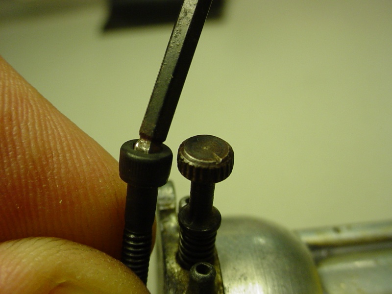

It looks kinda big to be a fuel tank nipple extension.. but it's the only way I can see to fuel it. It gives me an idea though.. Eyebrows It could serve as a guide for a jeweler's screwdriver to engage a slot cut into the top of the needle valve's knob. Better than using a needle-extension up through the cowl, which usually vibrates when the engine runs. Another trick would be to cut the head off a 4-40 socket-head screw and solder/braze it on top of the needle's knob for turning with a 5/32" ball-end hex key. The head/knob diameters are close.. (the socket head is .015" under) A sleeve of heat-shrink tubing; cut slightly longer.. might hold the two together, as an alternate method of attachment. Both head and knob have a knurled-finish on the sides, which would help with grip. The heat-shrink would need to be long enough to shrink-over the top and bottom edges.. but still be able to insert the wrench on the top side. Tedious tiny work.. but worth the effort for needling a cowled-in Bee.

Thanks roddie, that is strange. I thought it the fuel filler, but where's the needle? Can't have one without the other on a tanked Cox.

The brass tube is soldered to the needle valve as an extension. The overflow tube is underneath and the filler is the button on the top. Looks like it was meant to be fueled with a syringe needle. I don't think it was ever gassed up and ran. No fuel residue any where.

roddie, I like your idea of soldering a cut-off hex head onto the needle for remote access. I will have to file that one away for future use.
