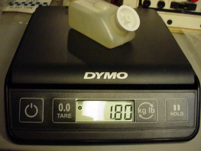

Here's an example of the weight of a flight-pack using this battery, a Tactic 6ch. Rx, and four "Electrifly" ES-50 nano-servos.
grams..
ounces..
add a Cox Babe Bee (I would use the Ace throttle with it)
grams..
ounces..
add a Sullivan #435 1oz. tank with fuel..
grams..
ounces..
That's a power-package with .049 engine, 4-ch. radio and 1 fl. oz. of fuel @ well under 1/2 a pound. It would be a great system for a little high-wing to fly in your field out back.
