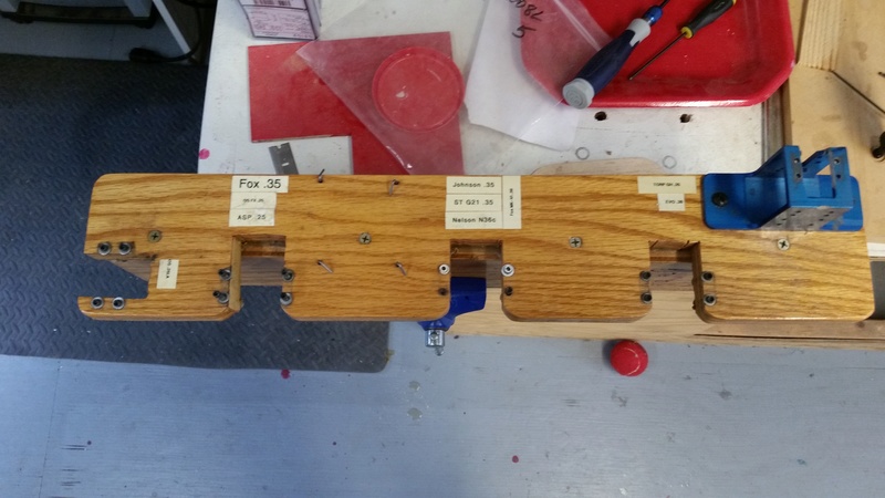

I also crafted super simple 1/2a Combat engine stand from 3/4 ply for bladder fed hot rods
![So you want to play with your engine BEFORE mounting to a plane, car ,or boat 20170613](https://i.servimg.com/u/f58/18/69/14/69/20170613.jpg)
Then I got the bug for .35 and larger Stunt planes--- so started accumulating larger engines and the Tower test stand is much to fiddly so I noticed Rsv1 something ....AKA Bob.... got one of the way cool Brit mounts...I had a ME TOO weakness, and ordered one up
Recently receiving a few Balanced and Blue printed Tom Dixon and Randy Smith motors, I decided since the WX suz for flying, I was going to test fire some of my new cool stuff.... BUT Dang... I never did mount up the Brit stand
Point of all this is ----today I got off duff and made this "T" mount to play with tomorrow, after Poly dries
![So you want to play with your engine BEFORE mounting to a plane, car ,or boat 20170614](https://i.servimg.com/u/f58/18/69/14/69/20170614.jpg)
sorry for crummy tography

Well I took the engine departing video to heart and adapted the mount to include positive capture pins
BUT -----I love and hate this mount.... on the one hand it is fairly easy to set up
On the Other the design sux for short nosed engines...most of our factory stunt engines
What I mean is... installed..... the distance from the case to the NVA is too short and adjusting the Needle is a problem
I am able to make it work, but IMO just as fiddly as the lower cost Tower test stand I show
I also have a Tatone version that is about the same problem
Just need to get off my butt and use a lot of the various hard woods I have---- and build a motor stand that ONLY captures the mounting lugs securely...but faster than my screw mounts shown above
