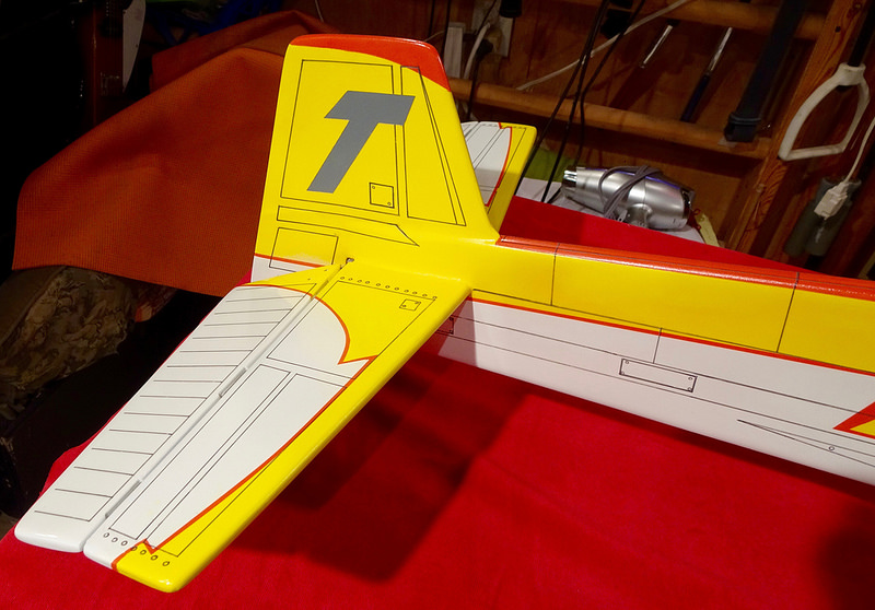

Only recently, after seeing Shug so remarkably delineate his ARF Tutor. When I see Avaiojet-Charles, my clubmate Don Jenkins and other Artists do it, I blow it off as way too much trouble for a soon-to-be beater, my Yak not included in that category. But Shug's impulsive inspiration and resultant elevating of his ARF to another level got me thinking, I'd like to start by dabbling in it. Maybe or maybe not work my way up the skill ladder. Maybe the Flying Tiger??? The Shadow Knows....fredvon4 wrote:
Looks like the P40 may be one of your better done/looking birds... no disrespect to others you have finished --- Like Taz
I am considering using either the Nobler ARF or the Brodak P40 as my first ever attempt as some meager panel lines
Have you considered screwing with this?
