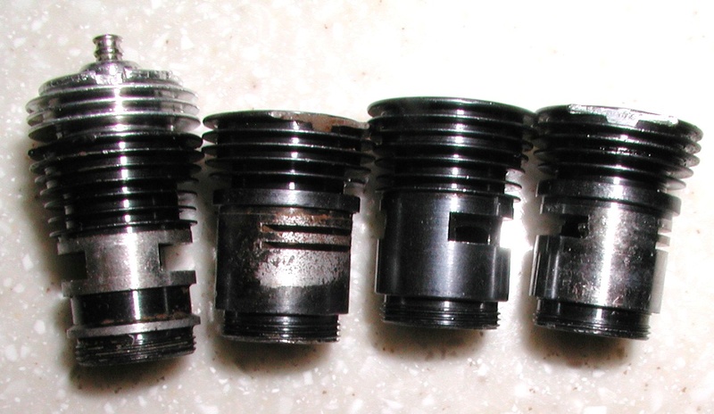

I'm still trying to reconstruct, make sense out of this mixed parts mess.
In trying to match what with what I found this cylinder with a slit exhaust port on one side and a standard open port on the other with twin intake flutes. The baffle has two hole openings. The case has the clip on notched stop. I think I have the correct parts to make up one engine.
Checking the Cox Engine and Wiki sites I find nothing about it. Any ideas as to what it came on -car, airplane?
Got this yesterday. Why would anyone mill the top two fins off?

My guess is the wrench slipped and buggered up the top fins. I speak from personal experience.

A revelation. The strange cylinder will not screw into a standard Babe Bee case, the threads are different. Could it go to a Medallion? I don't have one to compare.
Posts : 10851
Re: Strange Cox Cylinder(s)
049 Medallion and Bee cylinders are interchangeable. Could the thread be just a little beat up or something?

KariFS wrote:049 Medallion and Bee cylinders are interchangeable. Could the thread be just a little beat up or something?
The threads look good, seems the pitch is different but I'm not sure. Only one with just two rows of threads not three.
Extreme right. Still, the only one that I have found with slits on one side, standard on the other. I would like to know if I have the right baffle for it.
Thanks - Bob

Yes, I found that Andras, but nothing on this type of cylinder. Nothing that I can find on the net either.
By baffle, I mean the restrictor collar that rides around the cylinder.

Bob never did it just one side... BUT I dislike the twin slits... I tried all sorts of cutting to remove... Had and AH Ha moment and pried a small screw driver in a bit up and down... popped right out----slight tad of deburing inside....where I got a bit deep with the screw driver

I think that one can see the traces of a slit on one side, so perhaps someone broke off the slit on one side only?
The thread pitch is hard to tell from the image alone, it certainly looks a bit damaged? Have you compared it to the one for the glow head, they are usually the same?
The fewer number of threads might simply be a machining error, there are lots of odd features one can find in items that should not have reached the end user...

Ok. At least the mystery is solved. I too have heard of this procedure before. I was initially thinking someone made this configuration from a blank cylinder.
