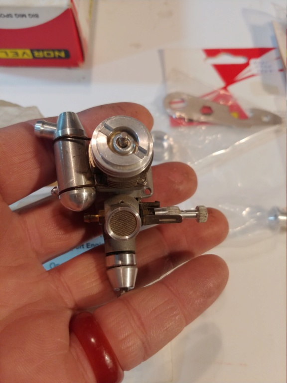

Hi guys,
This one may sound odd...but I'm thinking of putting a Cox spinner on the above mentioned engines.
I have seen two differing specs on the metric prop studs.I don't want to muddy the waters by posting/quoting.
Anyone here try a Cox spinner on their metric engine? Is it as simple as running a metric tap down the spinner retaining barrel?
Thanks in advance,
2024 Supporter
Posts : 2021
Norvel/AP .061 prop stud size compared to 5-40 stud Empty Re: Norvel/AP .061 prop stud size compared to 5-40 stud
Post  1/2A Nut Thu Aug 30, 2018 12:16 am
Yes Jim the 5-40 aluminum bullet spinner can be tapped to 4mm
Is that what you want to do or are you talking about a stock spinner?
Norvel: 4mm thread on the .074 and 3mm on the .049 / .061
AP .061 is 4mm
Posts : 3526
Post  944_Jim Thu Aug 30, 2018 5:43 am
Hi 1/2A,
Thanks for your input.
End Goal is to put a 3-blade spinner on my Scientific P-40 with the AP engine. Preferably, the stock plastic Cox piece with the retaining barrel. I strongly suspect that is my lightest option.
I thought I read the sizes you quoted. I didn't think that the Norvel and AP used different studs, and that is what had me confused!
The appropriate drill bit for 3 mm is 0.010" smaller than for 5-40. The appropriate for 4 mm is a bit bigger. So I just need to pickup a bit for 4 mm and drill/tap appropriately. That is better than retapping the 5-40 hole for 3 mm. Gee, I guess the AP is a better fit than the Norvel in this instance.
Pics to follow!
2024 Supporter
Posts : 2021
Post  1/2A Nut Thu Aug 30, 2018 7:14 am
Yes the Norvel .049 /.061 is not ideal for a good solid re-tap of the Cox 5-40 plastic three blade.
spinner's metal stud.
The 4mm option will surely get you there with a good secure fresh set of threads. Having said that the first
effort should be to tap it to 3mm and see how good the bite is, might as well if it works great. If not no big
deal as the next jump to 4mm will be a good transition for the 4mm tap to cut through.
