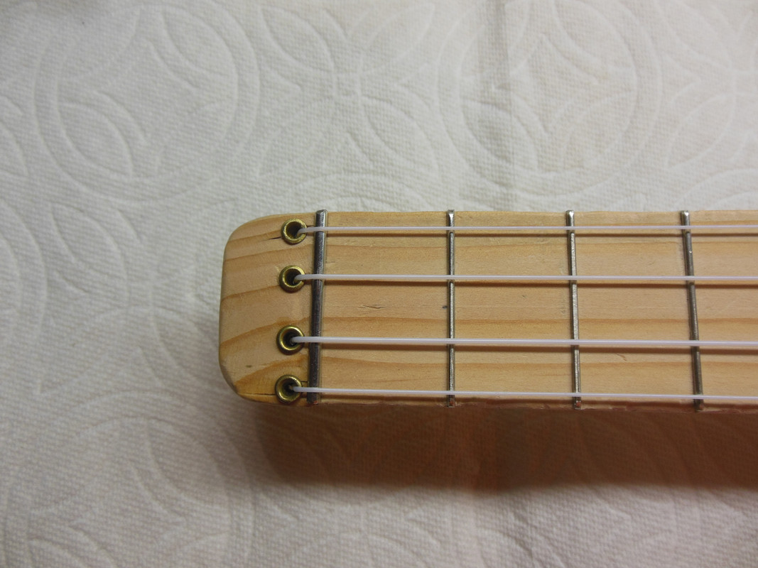

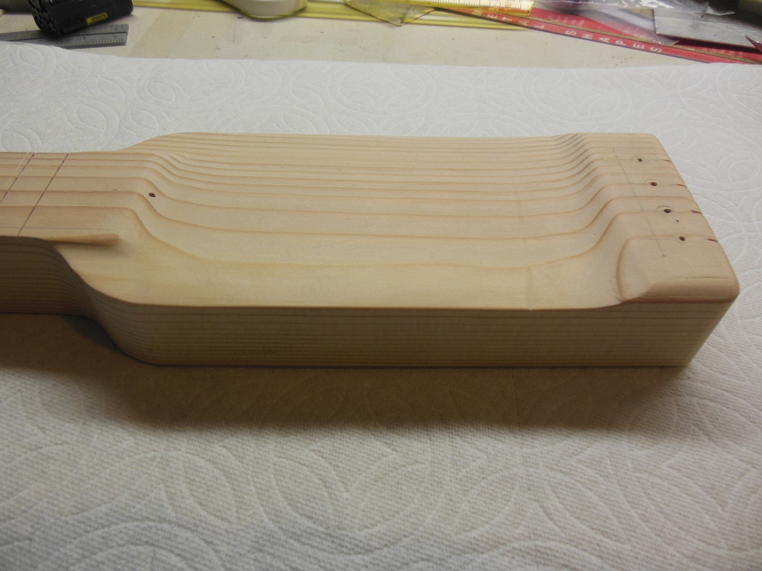

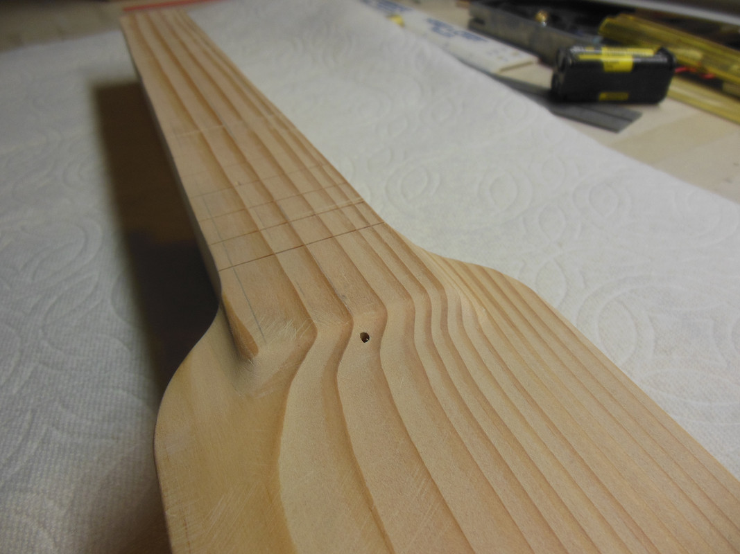

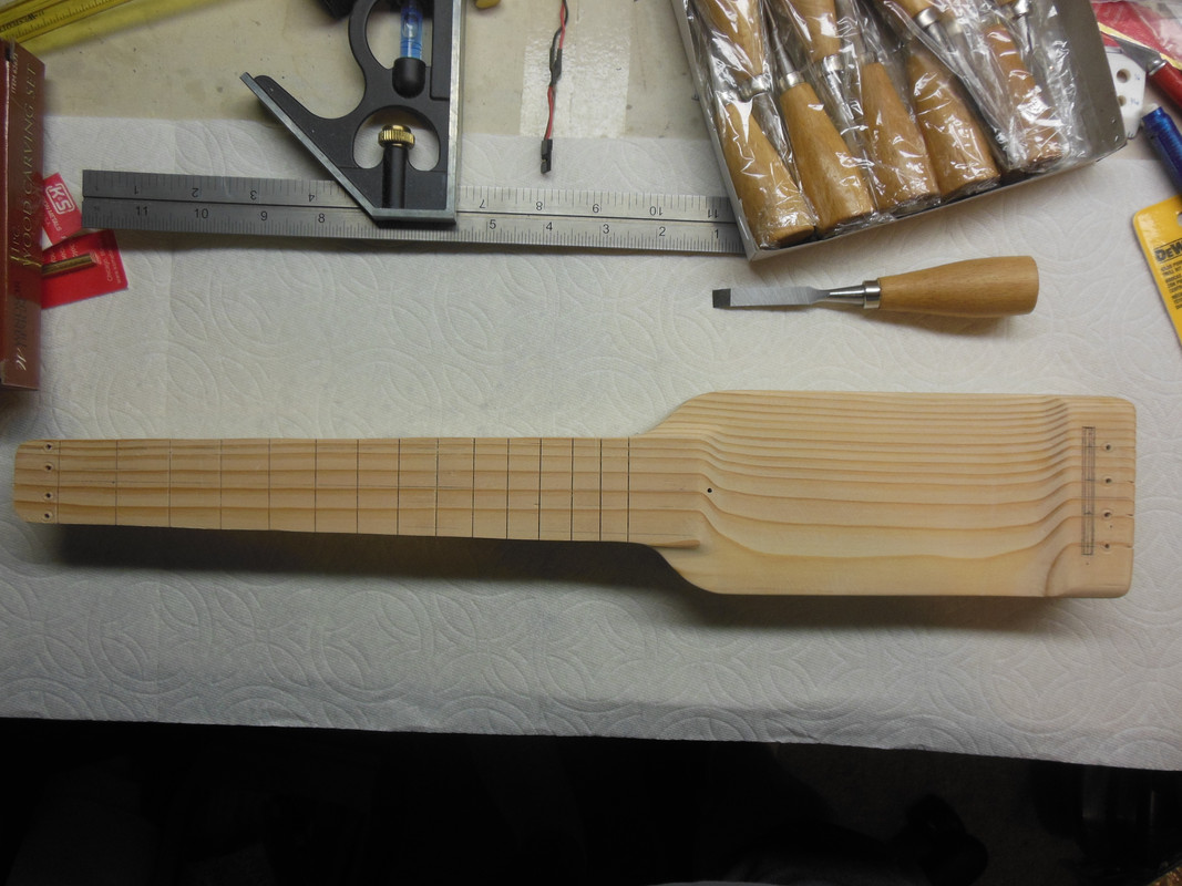

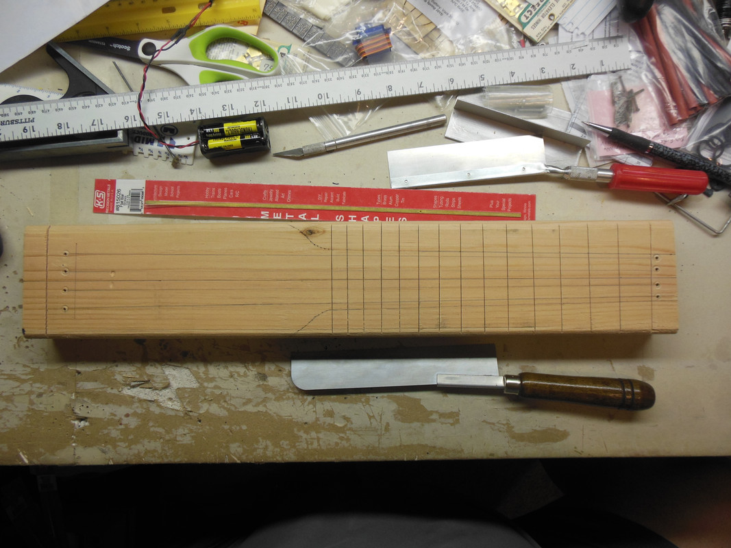

I drew out the layout I wanted and transferred it to the wood. It's 18 1/2" long by 3 1/2" wide by 2" deep, versus a standard tenor uke's dimensions of around 26" by 9" by 3".
![Laying off building planes for a while. DSCN6307](https://i.postimg.cc/mZ9wgcB5/DSCN6307.jpg)
Then I grabbed a square and a saw and cut the fret lines. It’s late, so I’ll cut the rest of the outline tomorrow and start the electronics installation.

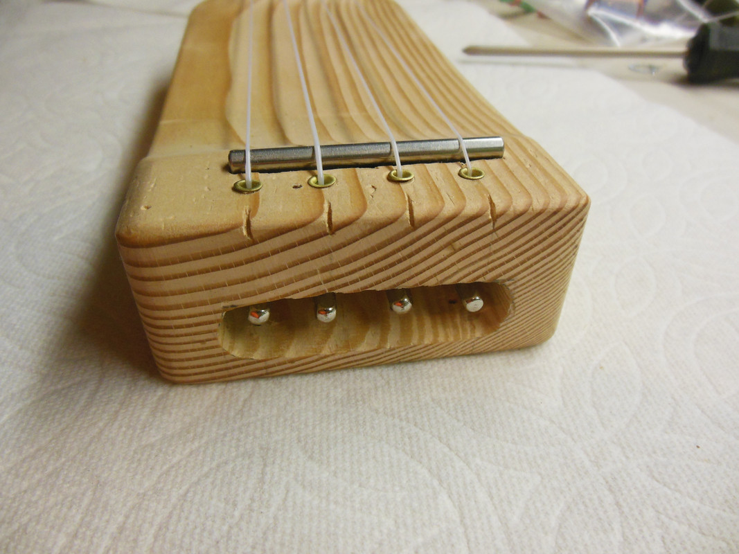

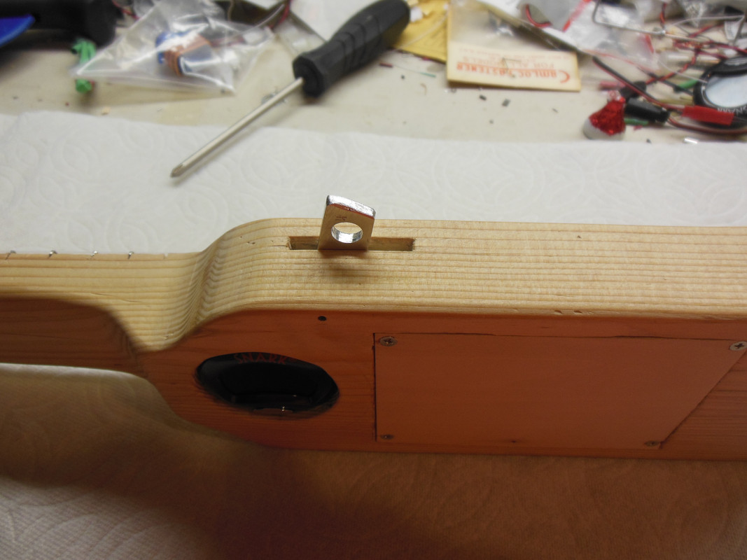

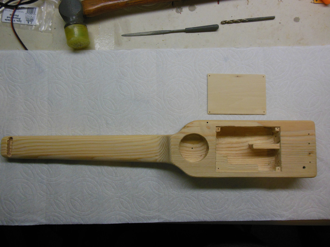

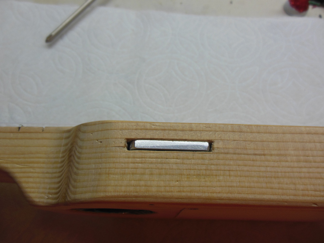

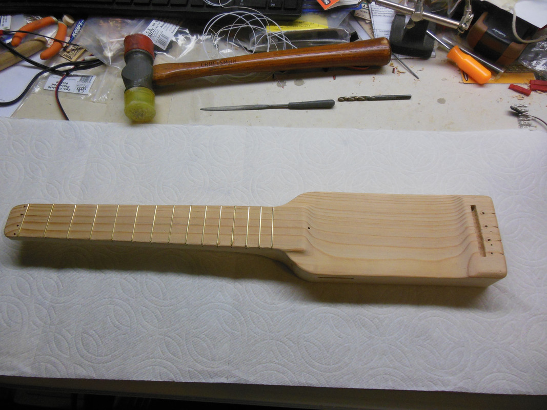

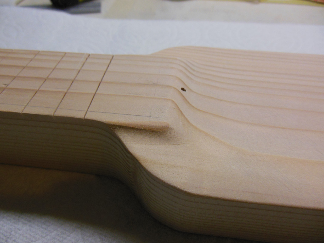

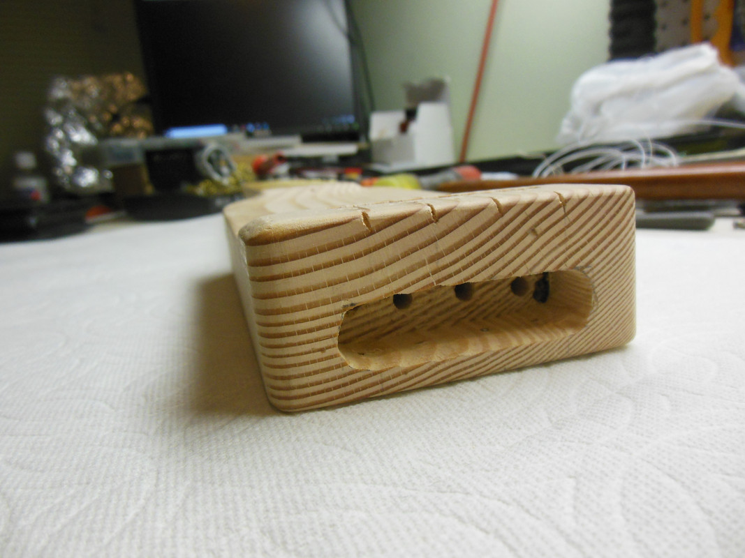

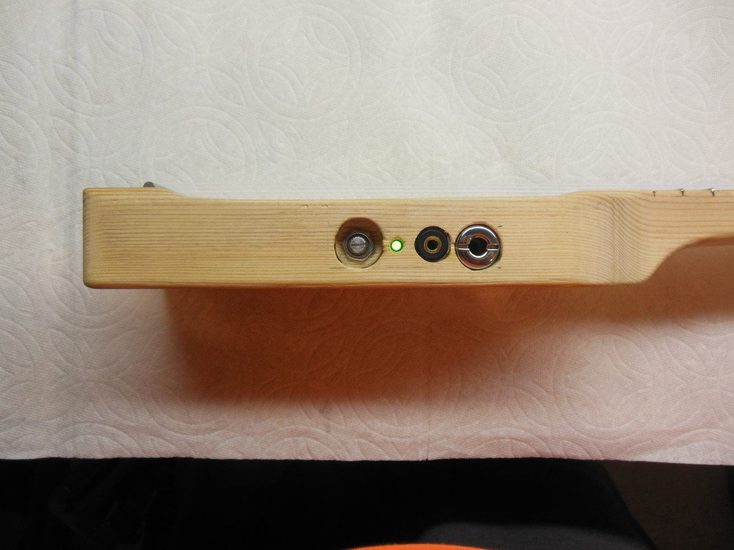

It’s late and I have to be up for work in six hours, so just a quick update. I cut the general shape out of the blank and sanded it somewhat smooth. With the general outline cut out, I attended to the area where the sound hole would go on an acoustic. Since I’m not going with a fretboard or bridge board for simplicity, I needed space for strumming. So I sanded the area where I’d be strumming down about a quarter of an inch or so. Then I went back to the neck area and sanded the sides down inline so it is kinda like a fretboard ending at the body. The bridge area is just full width for now. I think I’m going to leave it that way so I have a place to rest my wrist when I strum. I didn't thin out the wood on the neck because I want to keep it full depth while I'm manhandling during construction. The last thing I'll do is profile the neck before applying whatever finish I decide on for this, if any.
![Laying off building planes for a while. DSCN6308](https://i.postimg.cc/cHkmsqpS/DSCN6308.jpg)
![Laying off building planes for a while. DSCN6310](https://i.postimg.cc/RVHRzDGk/DSCN6310.jpg)
![Laying off building planes for a while. DSCN6312](https://i.postimg.cc/XqZgqHWy/DSCN6312.jpg)

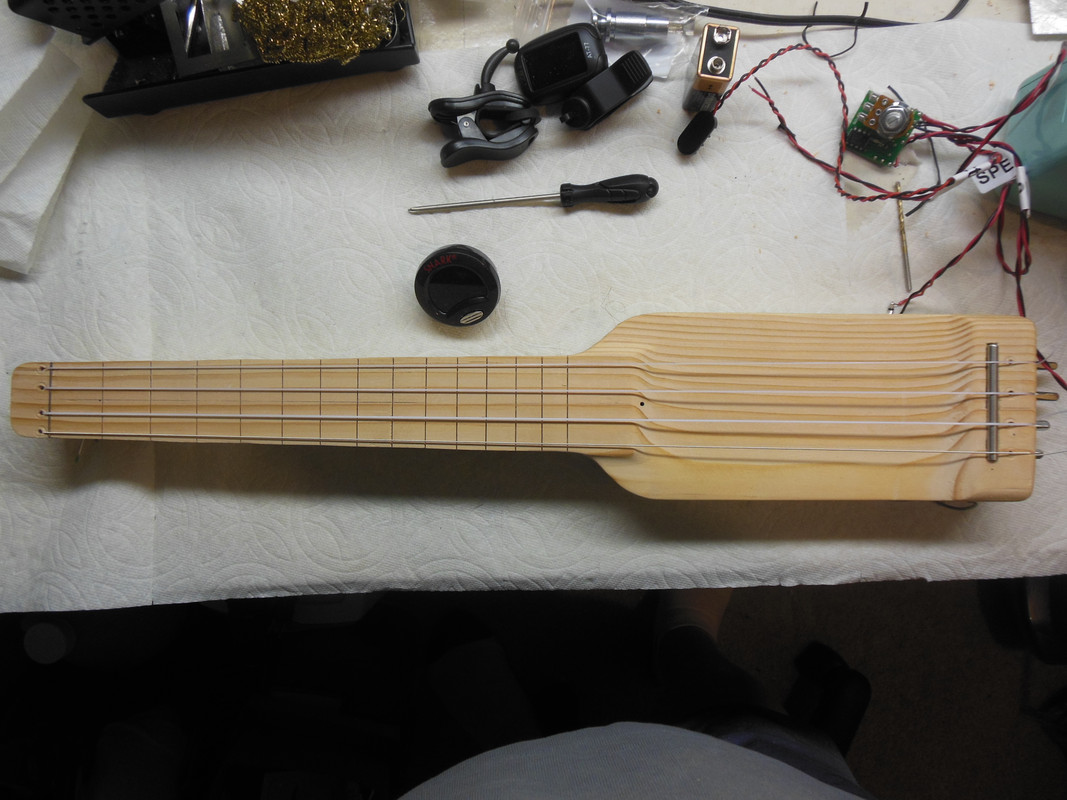

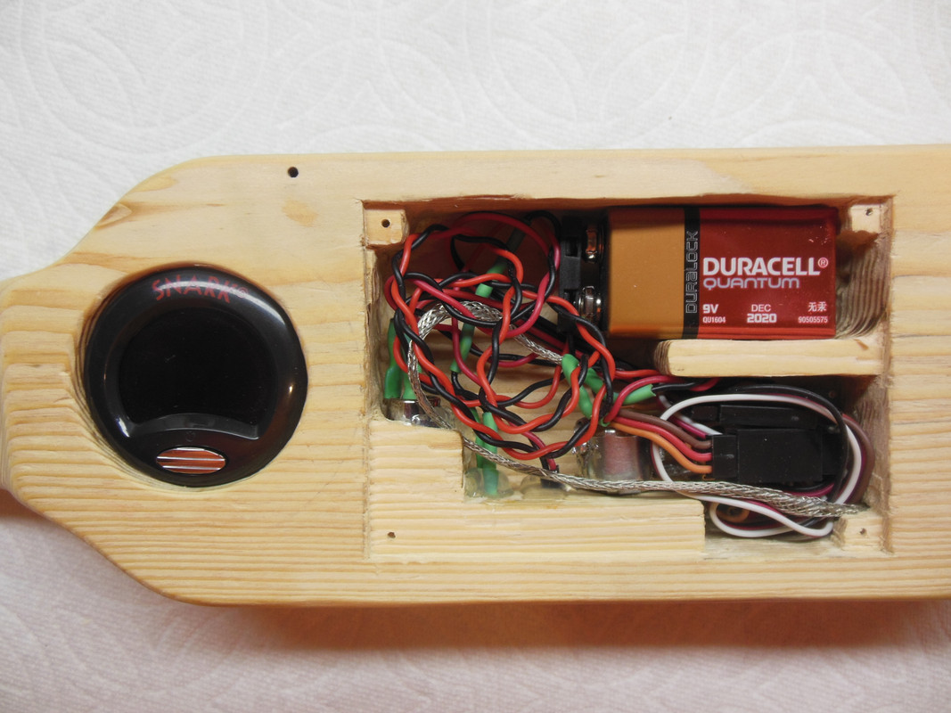

I marked the area for the bridge and then opened up the area for the piezo pickup and the piece of 3/16 steel rod I’m using for a bridge. I have some brass rod also, but I’m going to try the steel first. Then I did a little soldering for hooking up the piezo to the mini pre-amp that will go inside, and for the speaker output of the amp. I don’t have a speaker that I’m going to use, but I have a little portable amp/speaker to hook it up to. I installed the tenor uke strings using zither pins on the end for testing, but that won’t be the final layout. I just did that for convenience in testing. I just slipped a small piece of wire in where the zero fret will go, put my bridge in, and tuned it up. I’m using a low G string for this to try that out as well. It tuned okay, but it’ll take a couple of days for the strings to set their stretch.
![Laying off building planes for a while. DSCN6315](https://i.postimg.cc/D0tPXrfp/DSCN6315.jpg)
![Laying off building planes for a while. DSCN6319](https://i.postimg.cc/v8jzks77/DSCN6319.jpg)
I put in the battery for the mini pre-amp and hooked the portable amp/speaker to it. Turned everything on, and strummed. Oops! I guess the pre-amp and the amp/speaker box don’t play nice. There was a VERY loud strum with a bunch of feedback, and then it didn’t do anything more. No sound out. I don’t know if I messed up something on the pre-amp or in the speaker box. I’m going to do some more soldering after work tomorrow and solder the connections on the pre-amp board for headphones and for audio out (which is what I think was supposed to have been used on the amp/speaker box). I thought it was going to come pre-wired for these two things, but the only output wires it had were for “Speaker”. And I’ll also see if there’s a little fuse in the amp/speaker box. I guess I’ll have to email G.B.Gitty tomorrow and ask them if they know what I screwed up.
Nite, All!

BTW Mark, just had a thought. Depends on the pickup you have. Since these are nylon strings, the magnetic style pickup wouldn't work. It would have to be something that picked up physical vibrations. Some time back no long gone missing, I had a crystal contact mike that I used for a hollow body ukulele, it had its own clamp. That was back in the early 1970's. Since, designs have changed but same basic principle.
Posts : 5513
Re: Laying off building planes for a while.
roddie wrote:Hi Mark, This is a fascinating project to me! Is there a formula for arriving at the proper fret spacing for a given overall string-length? I always wondered why the frets were spaced gradually closer toward the body.. and further-apart toward the headstock..
Hey, Roddie. There's always a formula. I looked them up online when I was drawing this out. There were even a couple of computer programs you could run to get the spacing you want. But the method I ended up going with in the end was using old-fashioned pencil and paper. I put a piece of paper over the fret board of my $40 Amazon Tenor ukulele and ran the pencil lead across it to get the proper fret spacing.... I then transferred the spacing to a clean piece of paper, and then drew my bridge location by measuring 17" from the zero fret to the bridge to get the proper Tenor uke intonation. As for the spacing getting gradually narrower, as you get close to the bridge, the tone gets higher. Less string between the fret and the bridge, the less movement to change the tone higher. I don't know how to explain it too good, but it makes sense to me.
GallopingGhostler wrote:BTW Mark, just had a thought. Depends on the pickup you have. Since these are nylon strings, the magnetic style pickup wouldn't work. It would have to be something that picked up physical vibrations. Some time back no long gone missing, I had a crystal contact mike that I used for a hollow body ukulele, it had its own clamp. That was back in the early 1970's. Since, designs have changed but same basic principle.
I'm using a piezo stick designed for ukuleles with four chips in it. The piezo chips are spaced for a Soprano ukulele, but they're close enough to the spacing for a Tenor that it' won't be an issue. The stainless steel rod I have over the piezo stick transfers the vibrations directly to the chips.

Okay, I made some time to get back to this. After playing with the construction, I was surprised to find out that none of my initial design ideas were unworkable. The implementation may have been a little off, but all the ideas worked. The main design idea that I ended up with was that there would be no protruding items on the uke stick. Everything would be either flush or recessed. That worked rather well.
First thing I did was cut the rough shape for the neck with a hand saw, then use my Harbor Freight 1”x3” belt sander to finish shaping the neck, followed by hand sanding to get the final shape. I then drilled the holes for the tuning zither pins, and routed out the cavity for the strings and tuning wrench to fit in.
![Laying off building planes for a while. DSCN6321](https://i.postimg.cc/fW2h4SHB/DSCN6321.jpg)
![Laying off building planes for a while. DSCN6325](https://i.postimg.cc/7YhwbnCF/DSCN6325.jpg)
Next I drilled holes for the cord jacks and the amp switch/power LED. Then I used my Dremel tool and a grinding bit to remove wood to give a cavity for the electronics, and a cavity on the neck for the string ends. I then cut a piece of basswood for a cover. I was going to use ply, but the only ply I could find in 1/8” was lite ply, so I used some 1/8” bass wood for the cover.
![Laying off building planes for a while. DSCN6329](https://i.postimg.cc/V64PkJzs/DSCN6329.jpg)
![Laying off building planes for a while. DSCN6331](https://i.postimg.cc/PJRG10LB/DSCN6331.jpg)
I wired up all the electronics and stuffed them in the cavity. I know it’s a rats nest, but since this is just a proof of concept I didn’t want to hard solder all the components to the amp board. So, I used some connectors to make it easy to disassemble when I cut and shape the final uke stick with good wood. Another idea I had was to insert the tuner flush into the body instead of clipping it to the head, especially since this doesn’t really have a head.
![Laying off building planes for a while. DSCN6333](https://i.postimg.cc/fyLntMbc/DSCN6333.jpg)
![Laying off building planes for a while. DSCN6337](https://i.postimg.cc/vmFsqRPy/DSCN6337.jpg)

I broke two strings trying to tune this, so I ordered a couple more sets of strings and re-thought my approach. I figure that the wood was not a good enough surface for the strings to pass through, so I pulled out some of those brass ferules that are used on servos to keeps from squishing the rubber grommets when you screw them to the servo rails. I tapped the ferules into the string holes below the bridge and above the zero fret. I also decided the brass strips used for frets were garbage, so I went ahead and installed regular ukulele frets. Then I strung the new strings from the top of the neck, down through the holes below the bridge, and wound them on the zither pegs. This new system works pretty well.
![Laying off building planes for a while. DSCN6359](https://i.postimg.cc/s29tTMQP/DSCN6359.jpg)
![Laying off building planes for a while. DSCN6361](https://i.postimg.cc/Hx6FCFtV/DSCN6361.jpg)
![Laying off building planes for a while. DSCN6353](https://i.postimg.cc/8zW8rKT0/DSCN6353.jpg)
![Laying off building planes for a while. DSCN6355](https://i.postimg.cc/Fsw5z5XS/DSCN6355.jpg)
