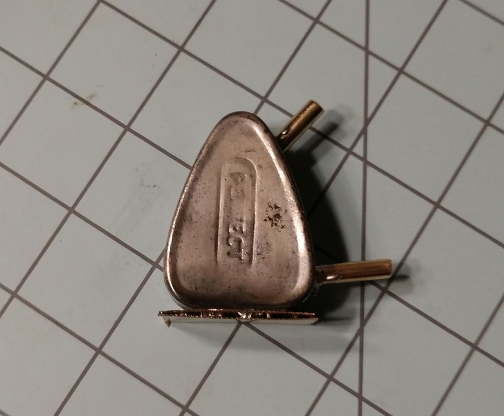

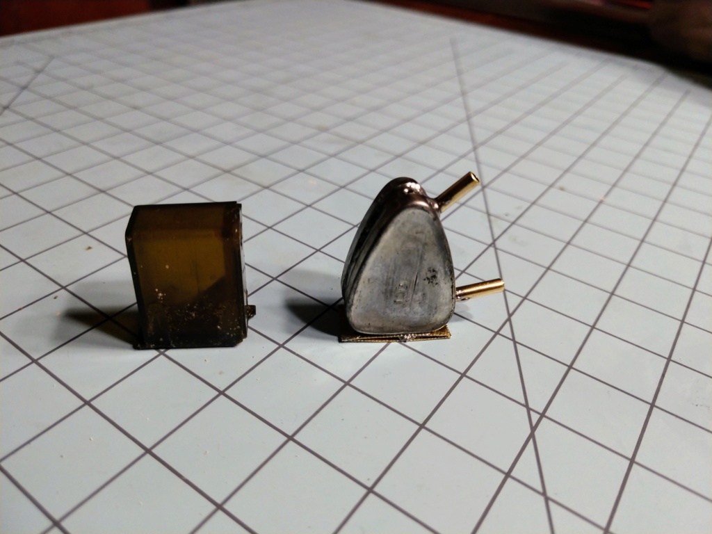

I recently bought one of these on eBay and while getting it up and running I found that the fuel tank plastic had become very brittle and both of the fuel line connections broke off.  I created a replacement by cutting down and soldering a Perfect #3 fuel tank and adding some brass sheet to the bottom to fit into the tank holder.  This was surprisingly easy to do and hopefully will help inspire anyone else who needs to replace their Skycopter tank.

Good job to keep it running! If this was mine, I would at least try fixing the original as well. I would get me a small piece of copper or aluminum tube teh size you need and drill the original holes to fit it snugly then use JB Weld or the like to hold the tubing in place. Just a thought if you wanted to try repairing it. Looking at the tank, I would go with aluminum as it would better match the original color as well as JB Weld is grey also.

Good repair job, and the weight of the tank helps to counterbalance the engine's cylinder.

Wow. Sorry, my bad on my previous post. I took a look again, and now see the fuel tank location. Originally I thought it was below the engine, the silver colored piece below it. Please disregard what I had said earlier. I think I gotta study pictures better before opening my mouth......

I can see how that grey part could be mistaken for the tank. Unfortunately the original tank is beyond repair, that was my original plan but when I tried drilling out the holes for tubing I found that the plastic was very brittle throughout.
I'm not all that concerned about keeping the originality of this one I tact because I plan to fly it as often as I can. Just need to hope that nothing else breaks or that it flies away and gets lost. I do have another one that just needs cleaned up a bit and that will be my collection piece.

I never seen a Skycopter with a metal tank. I owned them since they were first introduced. I'm not saying it's not possible. One thing is for certain is that the Ebay seller is obviously not in tune to what people are willing to offer or pay. The nipples broke off of those tanks when they were new and I can only imagine it's even more brittle 40 years later. The stock tanks actually had too much fuel in them which caused more than 6 of mine to go bye bye. The Perfect tank on there now certainly appears to be larger not to mention you can't see the fuel level prior to launching. A lean run of 30 seconds can put that thing into orbit.
