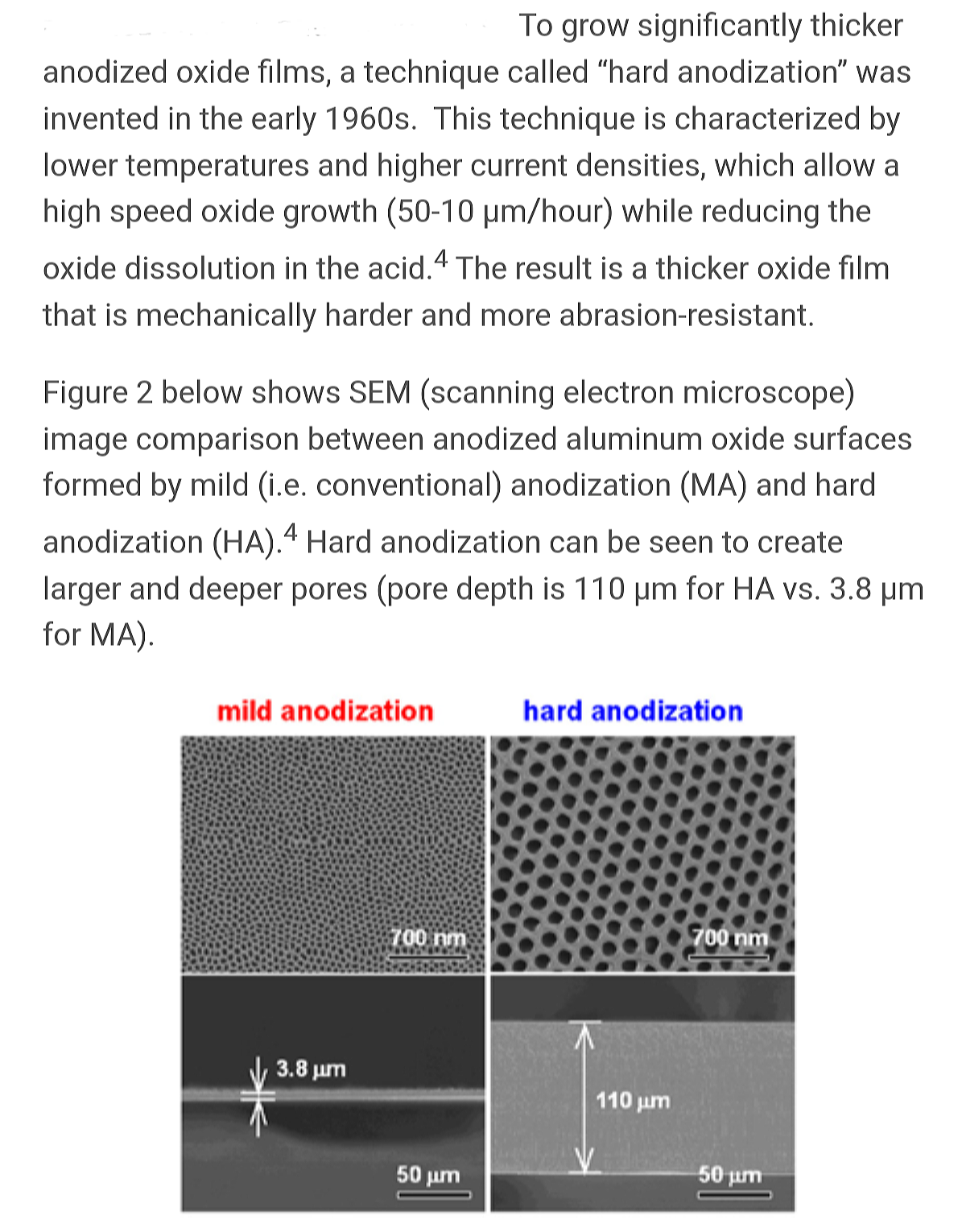

I learn that there are 3 ways of anodizing aluminum. First one use chromic acid, second one use sulphuric acid and third one is also use sulphuric acid but in different temperature and amperes. Third one is called as hard anodizing and thicker and porous surface.
https://www.silcotek.com/semi-coating-blog/tips-on-coating-and-preventing-anodized-aluminum-contamination

this anodisation look ruf I prefer to do it thinner semi translucent fredvon4 Good link I will read carefully memorize as much as possiblesosam117 wrote:getback wrote:Hey Mike That tank on the BW looks to bee a Matt finish ? You get that from suppliers , i remember seeing it before but not the info .

The "rough" anodizing where the reed seals was not sealing too well.
So, I used 800 grit sandpaper and removed it where the reed seals.
No more problems with the engine run now.
Photo below shows the anodized surface to be removed.
I used a piece of glass for a flat/straight table to lay the 800-grit paper on.
Then carefully sanded the black anodizing off the sealing face of the tank (where the reed seals -- on the center hole).
