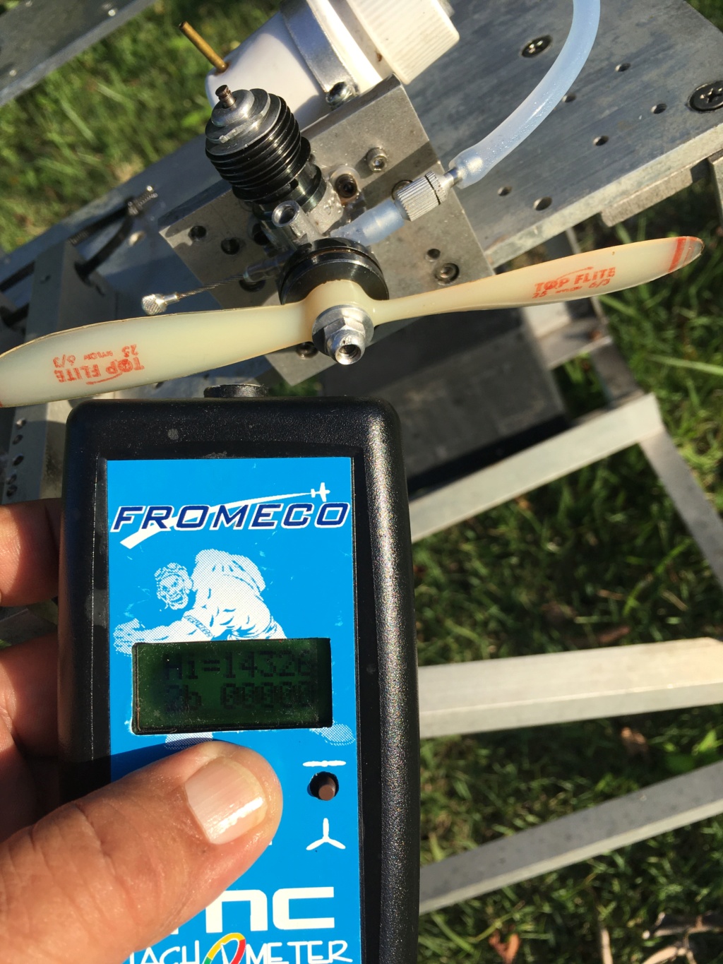

I was looking thru my boxes of engines and decided to look at a Testor Mcoy.049 that looked unused. On close inspection noticed that as the piston went down the engine got tight. I took it apart to look at the cylinder.I slid the piston up and down and as I had noted it was tight. Using my dremel and a polishing buff I started polishing the lower part of the cylinder up to a hair past the exhaust port until I was able to slide the piston easy. I tested the glow plug and was good. Using a Top Flite 6x3 nylon prop and 15/22 synt/castor fuel I got it to run. The starting clutch works fine and the engine ran up to 14.700 Rpm in one of the runs. I had to replace the factory Needle valve with one from a Wen Mac .049 as I could not lean the engine the first time I ran it. I have some 30/20 all castor but I have not tried using it on the engine.
                                                                                                                    Juan

Post  ticomareado Mon Jan 20, 2020 9:42 pm
You should be able to get 16-17K with a Cox 5-3 gray prop.

Post  aspeed Mon Jan 20, 2020 11:02 pm
My Wen Mac example was revving up a bit better than a Medallian but less than a TD. Far ahead of the single port reedies. I used the APC 4 1/4 - 4" for all the tests on 10% just to compare. 19,500. Glad I did not go with higher nitro if the plugs are a weak point. I guess they are unobtanium now, and they would need to be drilled and tapped for a turbo plug or standard one and lose performance. Wonder if there is enough meat left for that and to still use a wrench. I never put one in a plane yet. Seen some buddies use them in the 1970s but never in person since.

Post  ticomareado Tue Jan 21, 2020 5:10 am
I have one that a fellow in Illinois modified for me. He modified stock glow head to clamp a Merlin insert. The Merlin really is too small diameter for perfect fit in cylinder and there is very little engaged cylinder to head (now a clamp ring) thread area. It uses a single Cox copper gasket, again too sm. diameter. But the damn thing works and works well.

Post  getback Tue Jan 21, 2020 7:05 am
Good run Juan , that insert giving an extra 1000 Rs is pretty darn cool for these old engines . Old Bugger

Post  F4D Phantom II Tue Jan 21, 2020 5:37 pm
Well guys I will have to try the Merlin insert. Thanks for the video Tico. I bought 2 inserts from an ebay vendor today. I tried the drilling of the head and tapping it to 1/4-32 and tried to run the engine but the ones that it ran it lost a lot of Rpm and it would not lean out. The plugs I used protruded a little into the chamber so I made a few soft aluminum gaskets that were a little bit thicker. I tried an OS A3,Fox short idle bar,Rossi 8, and a fireball red but Rpm`s were in the 10-11K. I will play with my Wen Mac K II R/c to see If I can make it run.
