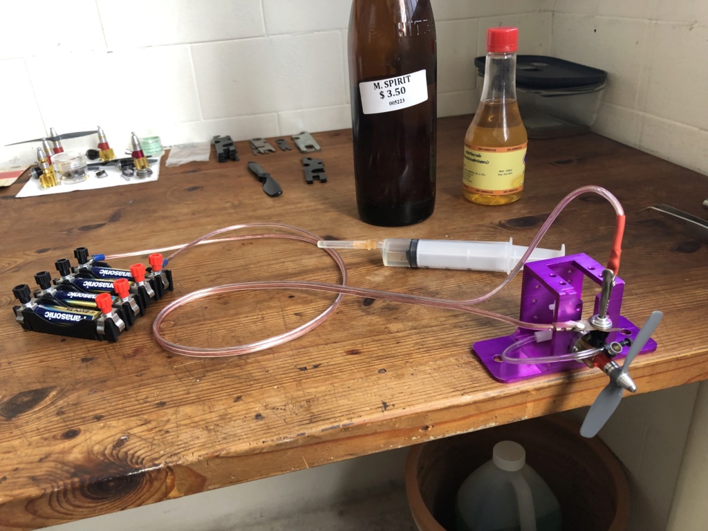

Post  aungmyatoo Sat Aug 31, 2019 8:13 pm
Cox International wrote:Thanks to all of the responses but the thread was started in regards to running Cox engines lol!
Hi all,
Just to report, I run 0.10 with methylated spirit. below photo is the set up,
got methylated spirit from hardware store next door and castor oil from my neighbour Indian store.
The fuel in syringe is 20% castor (1 ml castor + 4 ml ethanol (methylated spirit)

Ethanol vs. Methanol Img_3735
In conclusion, you can run cox as small as 0.010 with ethanol (methylated spirit, may be methanols 1-2% in it).
But you can't take out battery connection from glow head. I tried take it out and the engine stop running once battery connection cut.

Without any methanol I do not think the reaction catalyzes properly for glow engines. I do not know the lower limit.
American denatured alcohol, which is typically 50/50 ethanol/methanol (find and read the MSDS as it will not be on the can) when mixed with a proper quantity of oil will run glow engines, including Cox .049 engines, acceptably well. I have mixed up and used denatured before with reasonable results. Power seemed comparable to mixing up yellow HEET (pure methanol) and castor. (I then learned about pre mixed fuel sources and stopped experimenting.)

There is still methanol up to 5% in methylated spirit, so the engine will run. I felt the power and RPM is low and can not discontinue battery from glow head.
