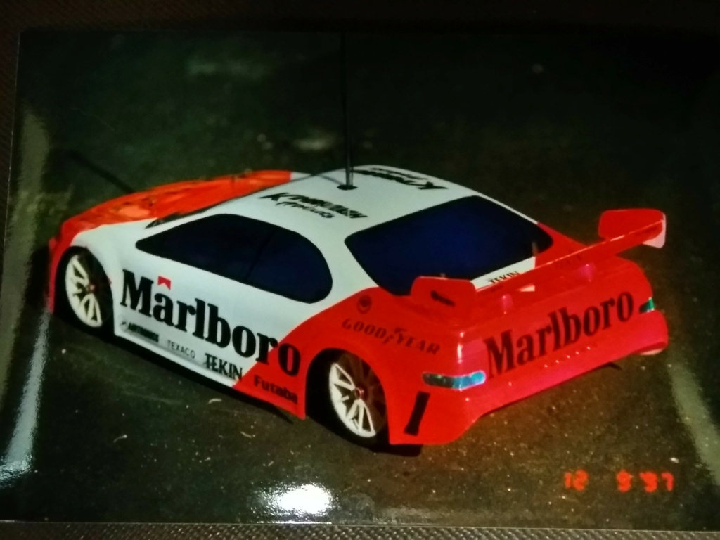

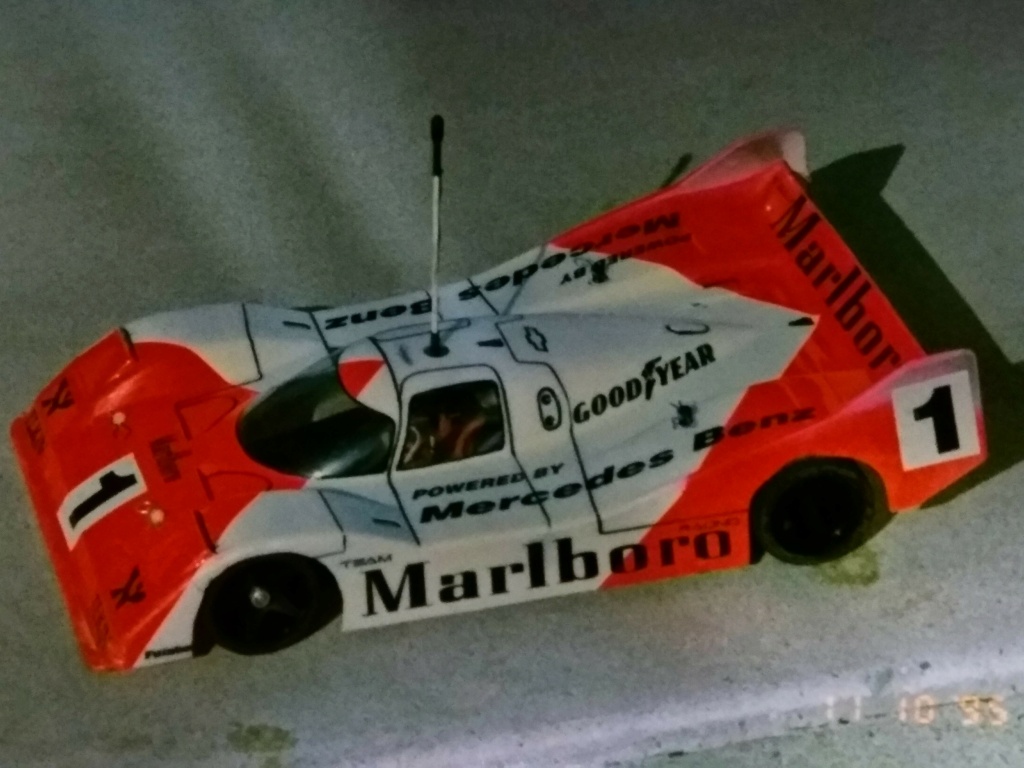

I got to drive the 962 because I helped out a good buddy that fixed older race cars. I met him at a electric rc on-road card race. He asked a lot of good questions and we became friends, he constantly asked car electrical questions, his shop was in the same city I lived so we hung a out a lot. I got to see some awesome cars come through his shop and helping mostly with electrical stuff he did not know.
AIS, the American indycar series was awesome, he bought a used 1989 march indycar w/o motor for $17K, put a $5K v8 crate motor in it and was bang for buck heaven, besides it eating tires alive, lol. I got to drive it too.
I did a lot of HO slot cars, then 2 decades of electric rc car on-road (won a couple roar national and a yokomo titles, 2nd in the 1999 yokomo worlds), then a decade of pc sim racing. I looked at go-cart's, just the tires were a wallet check, to be competitive in the 100cc class was ~$25K a year in tires/consumables/maintenance, I decided to do RC cars.
