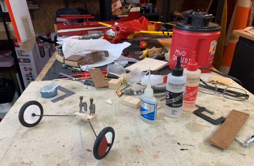

And...sad to say, the Q-Tee is BACK in maintenance!!! While working on the little plane, it never occurred to me to give the landing gear a good yank, and when parking it back on the bench...it collapsed onto it's belly!
After a few decades, the epoxy in the gear's ply sandwich had turned to putty, and the gear fell out. SO, new ply is being sawed, and new epoxy is being mixed!!!!
Not sure what the next powerplant will be...will figure that out when the Q-Tee gets it's legs back !!!!

Proving the truth of the old model airplane builders' saying that it's easier to outright build a new plane than to restore an old one, the Q-Tee AGAIN goes on the operating table.
After congratulating myself on a restoration job well done, the little parasol collapsed on it's landing gear...oops.
The original 1980's vintage epoxy, bonding the ply gear sandwich together, had turned to moosh, letting the Q-Tee's landing gear literally fall from the model.
So, it's back under the knife, cutting/grinding away the old ply and gooey epoxy, and replacing some oil-soaked bulkhead sections while they were handy to get at.

Got the Q-Tee wrapped up and ready after an afternoon of off and on work, so it's airworthy again...unless something else pops up.

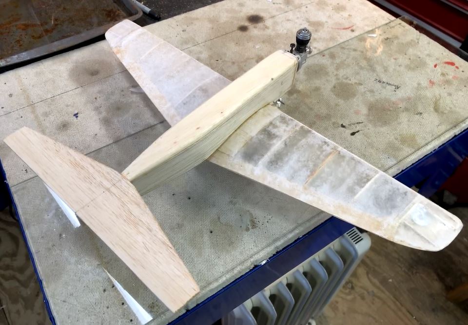

Everything tightened up nice with no wrinkles, and it's all getting clear-doped, with gentle sanding in between.
![Back in the Shop--It's All in the Prep - Page 2 1_160](https://i.servimg.com/u/f51/16/84/28/46/1_160.jpg)
![Back in the Shop--It's All in the Prep - Page 2 2_107](https://i.servimg.com/u/f51/16/84/28/46/2_107.jpg)
![Back in the Shop--It's All in the Prep - Page 2 3_79](https://i.servimg.com/u/f51/16/84/28/46/3_79.jpg)
![Back in the Shop--It's All in the Prep - Page 2 4_64](https://i.servimg.com/u/f51/16/84/28/46/4_64.jpg)
![Back in the Shop--It's All in the Prep - Page 2 5_52](https://i.servimg.com/u/f51/16/84/28/46/5_52.jpg)
![Back in the Shop--It's All in the Prep - Page 2 8_40](https://i.servimg.com/u/f51/16/84/28/46/8_40.jpg)
So, we're now coming down to REAL FUN time, when the paint guns gets loaded up with some color!
