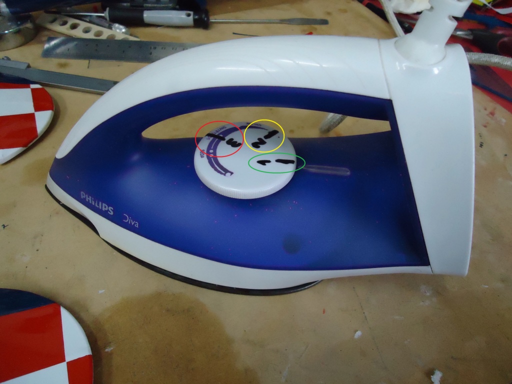

Thanks Eric!!!! Thanks András !, I will try to explain what I do in my terrible English as a translator, if you don't understand something please ask again.
First of all I do not use a special iron for hobby, I use a domestic iron of my own choice, that is, with a lot of heating power.
I used a hobby iron once but I did not finish adapting.
My iron is regulated according to error testing made a long time ago and I have pre-established some temperature marks to handle according to the sector and the type of material.
So:
I divided my own iron into sectors:
A
B
C
I am regulating the temperature of each sector as I need more or less heat, as if it were about flying and regulating acceleration.
To initially hold the bottom (in this case white) the entire perimeter I do it first, with sector A and temperature in position 2.
To shape the curves I then apply Sector C and temperature between 2 and 3 according to the type of curve.
Once everything is subject - grabbed - taken, I lower the temperature to point 1 and use the whole sector B to pass through the entire surface.
For everything that is monokote overlay (like red squares, or blue strips) I use sector A with temperature 1.
If there are any air bubbles left, then I puncture the same with a well-sharpened trench blade and I pass again the sector A of the iron with a temperature between 2 and 3.
Once everything is in place, I pass the iron over the entire surface with sector B of the iron at temperature 1.
I hope you have understood ...

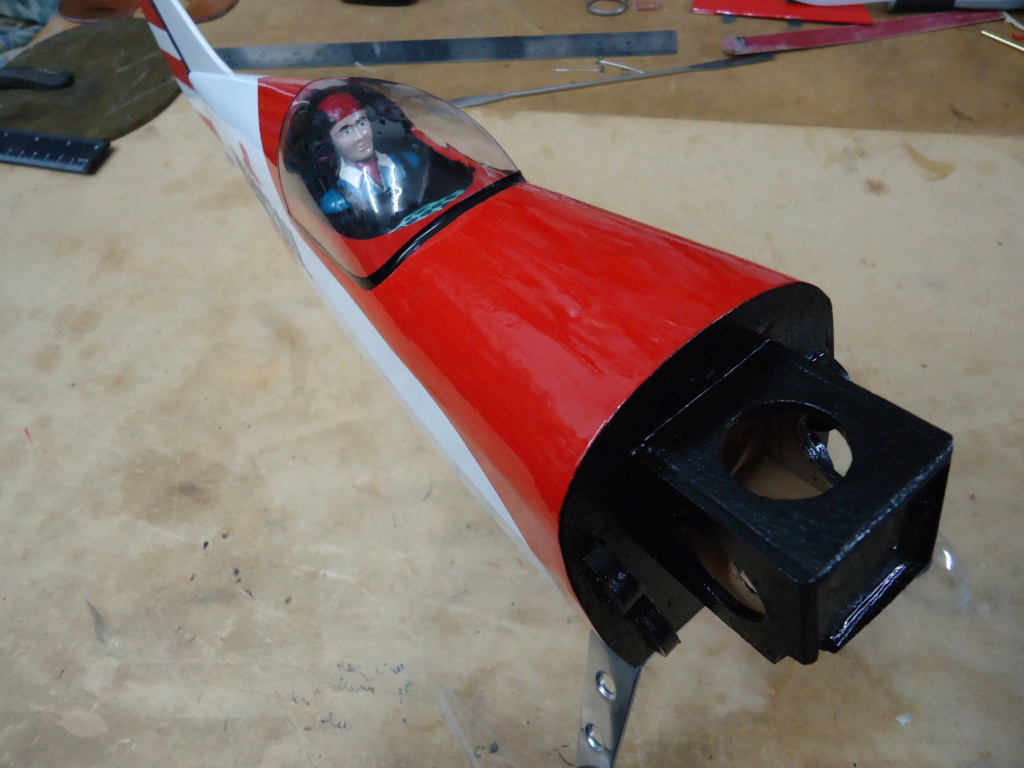

well, this is the finished cabin of this Pitts, the format based on the initial matrix I made, fits perfectly, keeping the fuselage line, I like that, put a black outline, just to make it stand out and I really like it how it looks.
Paint the engine mount or mainframe and F1 in black, the entire rear installation of the engine will stand out more and also protects from future splashes by the fuel.
He really is a model that fills my eyes friends !!
